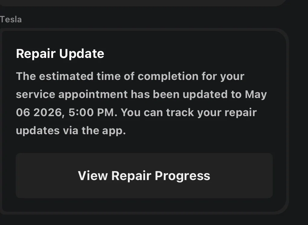

Pushed out another week I suspect it’ll get pushed further out with all the reports coming in.
Tesla Cybertruck Tesla pushing update failed PCS to enable supercharging while awaiting PCS repair part IMG_3699
