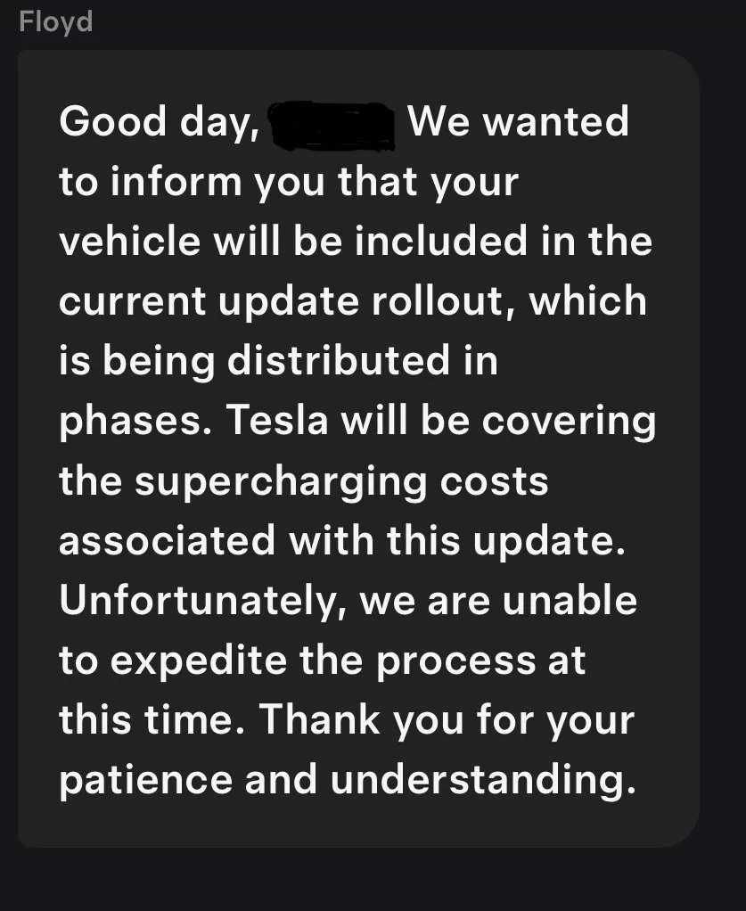

Latest info from my Tesla SC for my CB vin 34xxx, AC Charging unavailable, parts in transit SC appt on May 30.
Telsa said I should see a notice when they push the update for free supercharging while I wait for my SC appt. Otherwise, any supercharging I do after AC charging became unavailable before the Appt will be coved by Tesla. Unfortunately the nearest supercharger is 30 minutes away and I’m reluctant to drive there and find out DC charging doesn’t work,(unlikely, but some report DC charging also failed) which means having to have it towed to my appointment that is 2 1/2 hours away in 8 days.
Tesla Cybertruck Tesla pushing update failed PCS to enable supercharging while awaiting PCS repair part IMG_1428
Per my (admittedly limited) understanding, the update is specifically to enable DC fast charging even if AC charging from the PCS is completely kaput.
Are there any third party DC chargers closer that you could test with? Not free, but would validate it works.
No unfortunately, there are no third-party Superchargers in my city. According to my Tesla Service Center, the update is to enable Free Tesla Supercharging for “AC unable to charge” PCS failures till they can be fixed and that supercharging SHOULD work during that time. It was my understanding that it depended on your particular PCS failure as the whether DC Supercharging works or not. I was informed if that happened I still had TESLA towing available under my warranty for no cost
Yah, DC charging should work even if both PCS DCAC converters fail; but, on some vehicles, that gets locked out. Software update prevents the PCS error from preventing DC charging on those trucks.
Free supercharging is an account/VIN server side issue and shouldn't need a SW update.
