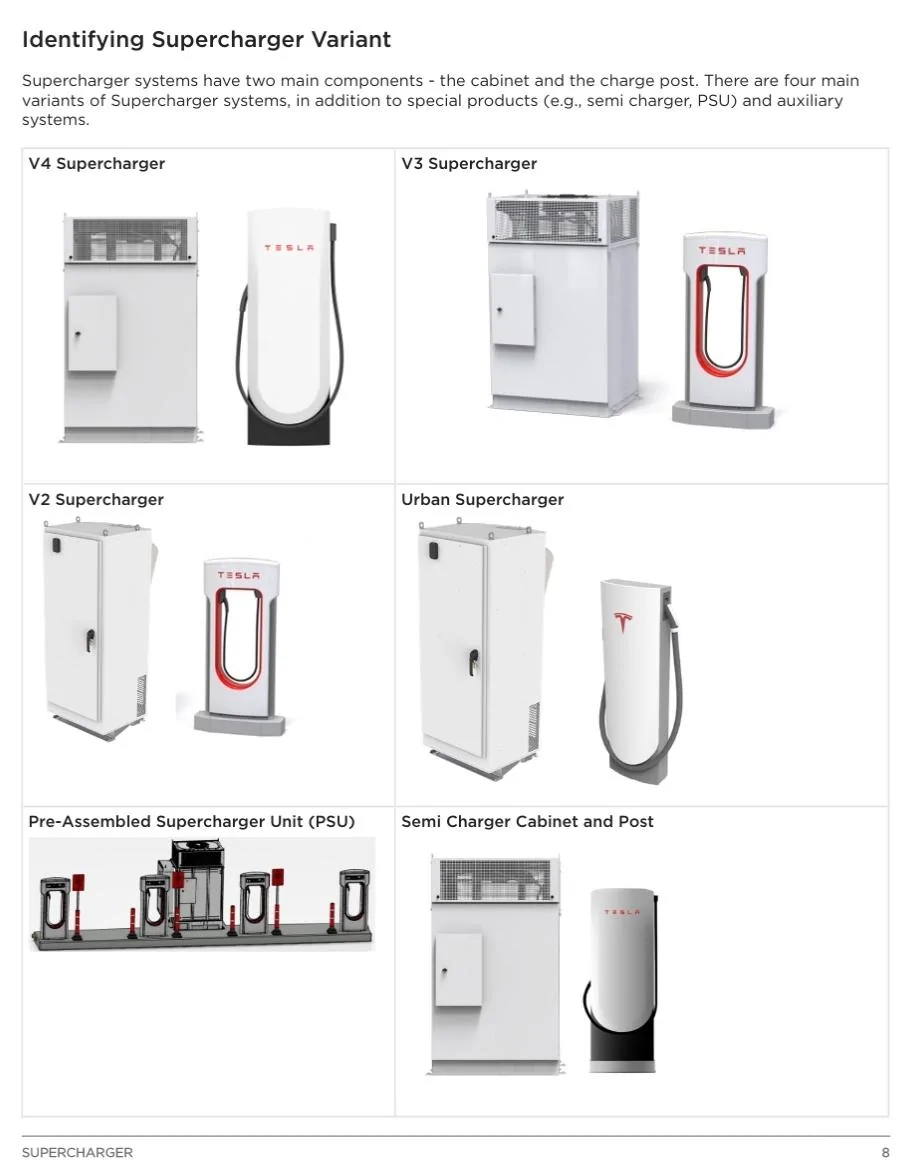

Actually, I believe that the answer is no. Charging a Cybertruck from an EA pedestal is not supported.
At least not officially. People have used Evject as a CCS adapter extension to make it work.
V4 is not a well defined term. There seems to be multiple pedestals that fit in the V4 concept.
And yes, these are all 250kW at this time.
V4 is the new pedestal (1000V max) with the old style cabinet.
Tesla Cybertruck Tones of V4 Supercharger Working In Progress SmartSelect_20240606_055853_Firefox
There's something up Tesla's sleeve though. Hopefully in the next few months, it will be revealed.
Yeah, I expect they update the cabinets to output 800+V. The HV DC bus is 900V nominal so the capability is mostly there. They either need to update the modules for the higher ouput voltage or add switching to stack the modules (assuming they have 800V isolation).

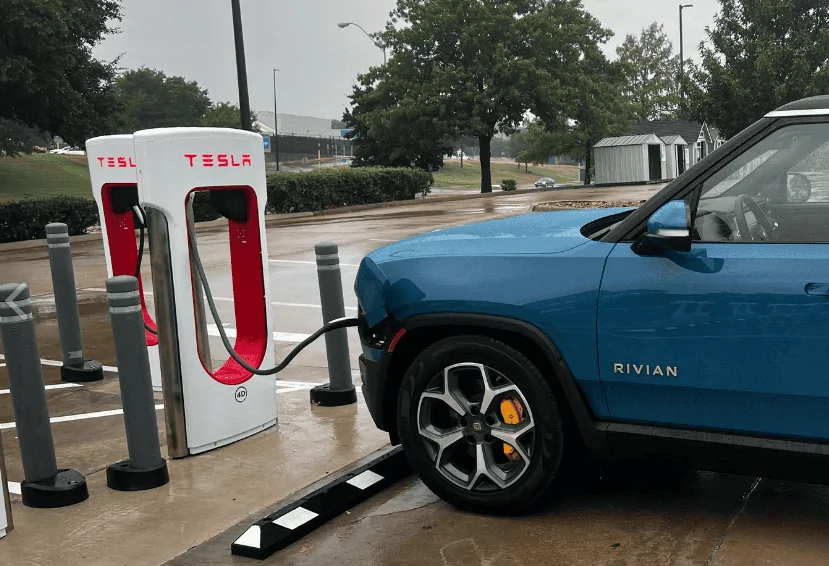

I don't disagree with anything that you've said.
But there seems to be another option in the pie that while it may be considered as a V3 upgrade, it is definitely not a standard V3.
Tesla Cybertruck Tones of V4 Supercharger Working In Progress 1718129400373-8n
It's the Supercharger at
Lowe's Home Improvement
1111 Eastchase Pkwy Fort Worth TX 76120
It's a V3 with integrated MagicDock.
It's on the Tesla Supercharger map listed as a "Superchargers Open to Other EVs" like the V4s that you show above.
My guess is that even before the layoffs, there was some internal discussions about the MagicDock, Credit Card reader and 800V charging that didn't completely get resolved.
And that's exacerbated by a lot of V3s being installed well after V4s announced.
It's really interesting looking at the Superchargers Open to Other EVs map. There seem to be NONE in SoCal, but the NE is littered with them.
Yeah, weren't those the stop gap to qualify for the federal charge infrastructure grants pre-NASC and other OEM's adoption thereof?
Buffalo is the manufacturing location for charging which could explain the northeast bias.
As I recall, they were doing post retrofits at previously installed locations. Without replacing the underground runs, that wouldn't support 800V (assuming they had been using 600V rated insulated wire previously versus XHHW-2 1kV which would have been overkill).
