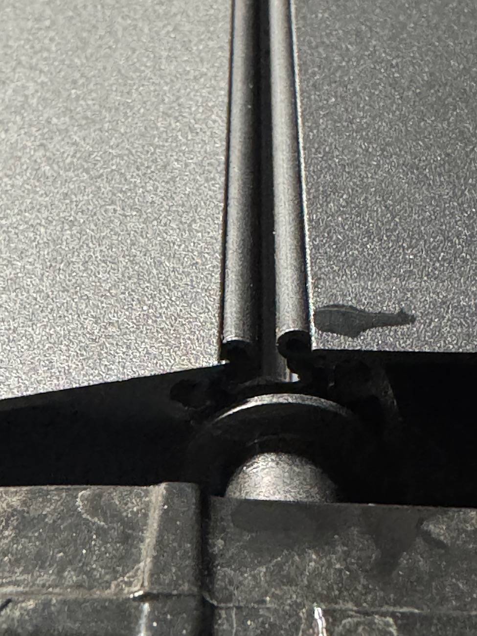

I mentioned to SC the new aero cover with the new seal and the fact I have unusual amount of water coming in. I got the below when I got it back. I need to see if I at least got the new aero. I still have a pretty good leak. Two SC trips ago I did have the gap. Gap fixed but now I have more slats and bars than I need and still leaks.

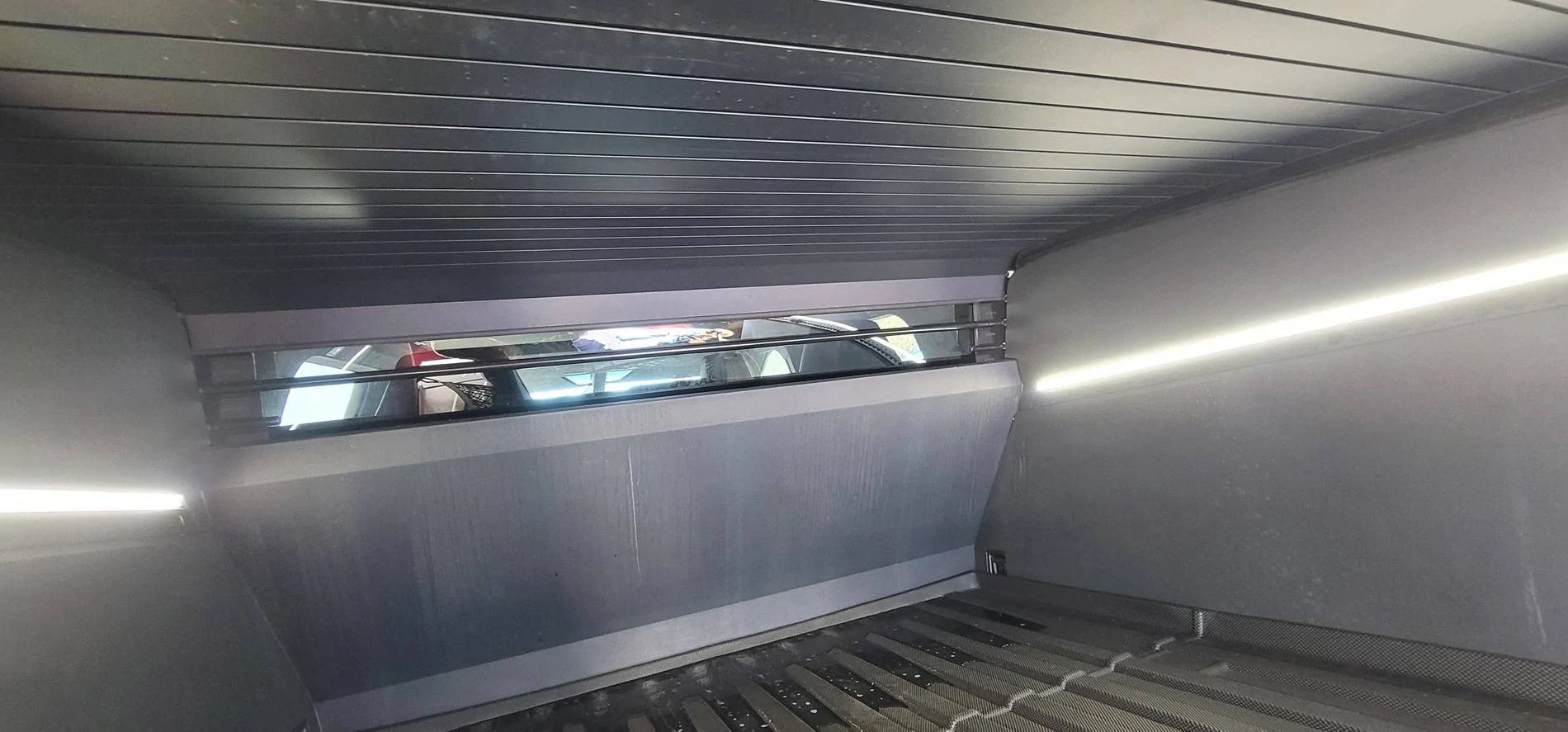

I drove home through some rain so when I got home I opened the tailgate to look inside for Ss&Gs. I found water again. Upon inspection I found the gasket that was hanging was meant to be installed between the last 2 slats closest to the cab.
Notice the difference? The next day I drove over to the Service Center in my work vehicle and showed them my findings and to make sure they did not throw away the uninstalled gasket. They apologized and said all will be fixed when I brought my CT back to them for the new appointment.

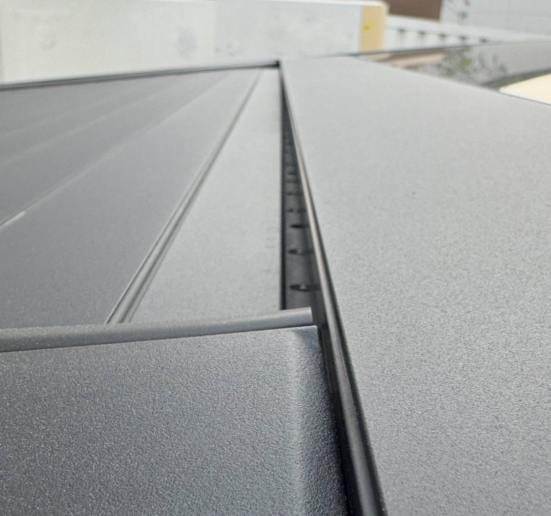

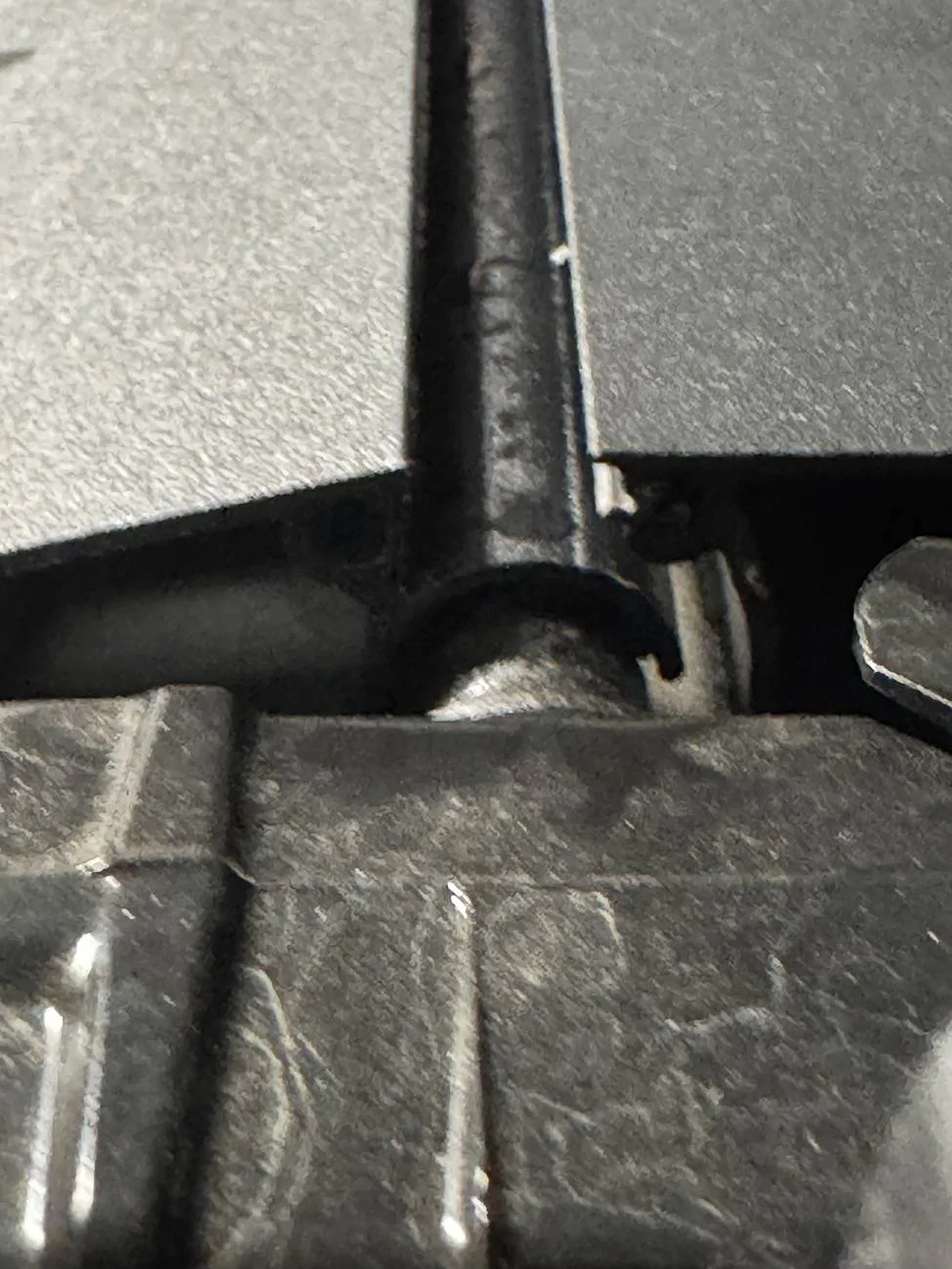

Mine still has the slat missing and I'll probably put it in as a line item if/when I need to take the truck in for service again. My concern is that dirt/debris/ice can sit in the 'slot' created by a missing slat and potentially damage something when the tonneau retracts.
If I were to open the tonneau with this piece in the slot, more than likely the roof appliqué would get pushed up/damaged as the tonneau retracted. Also probably scratching the tonneau in the process.
Tesla Cybertruck Tonneau cover gap issue fixed by Service Center under warranty IMG_8737.JPG
However, if the slot wasn't there, the piece would just slide on the tonneau as it retracts.
Tesla Cybertruck Tonneau cover gap issue fixed by Service Center under warranty IMG_8738.JPG
Makes sense. Maybe I'll keep at it as well.

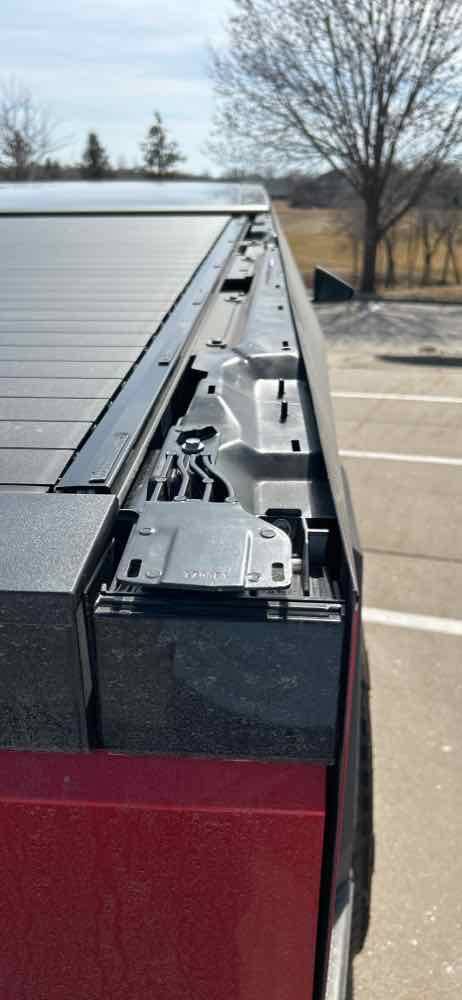

Thanks so much for the pictures - I have the same issue - clearly see the holes in the aluminum bar on top. As a temp fix I can move the cover up by 1/2" or so so that the gap on top is closed by the slat - and it doesn't seem to create a noticeable gap at the tailgate end -it also doesn't report the cover as being open. Will report back if that helps, and I'll schedule a SC apt.

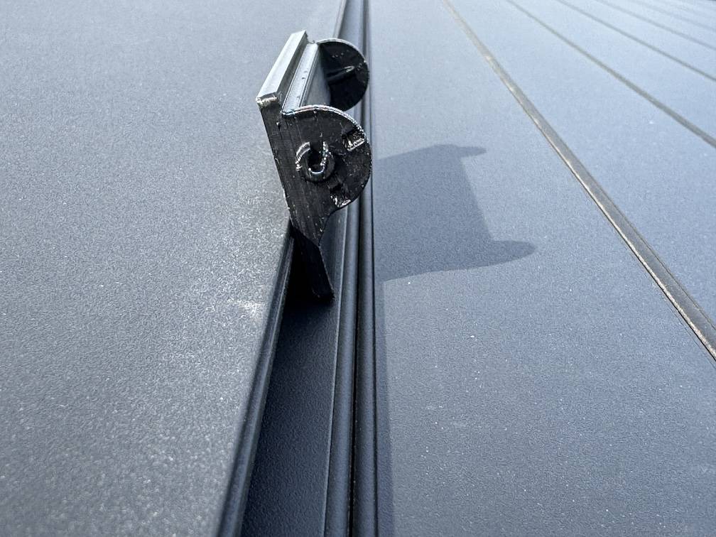

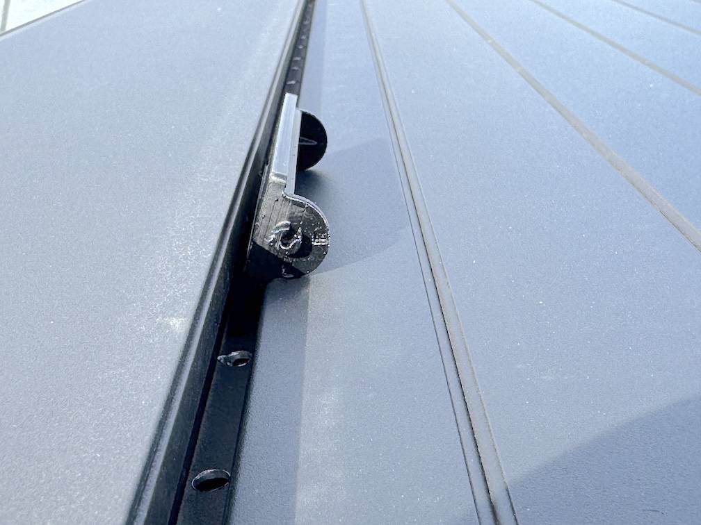

Got the missing slat fixed in my CT, then on the way home afterwards, this happened:
Tesla Cybertruck Tonneau cover gap issue fixed by Service Center under warranty IMG_0793
Went back to SC and they had in stock so they put on a new one. The other side was coming off too so they put on new clips and adhesive strips on that as well. Fingers crossed ?
