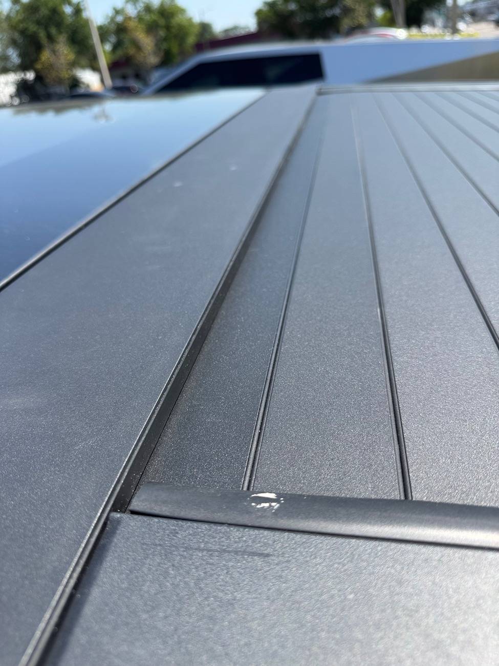

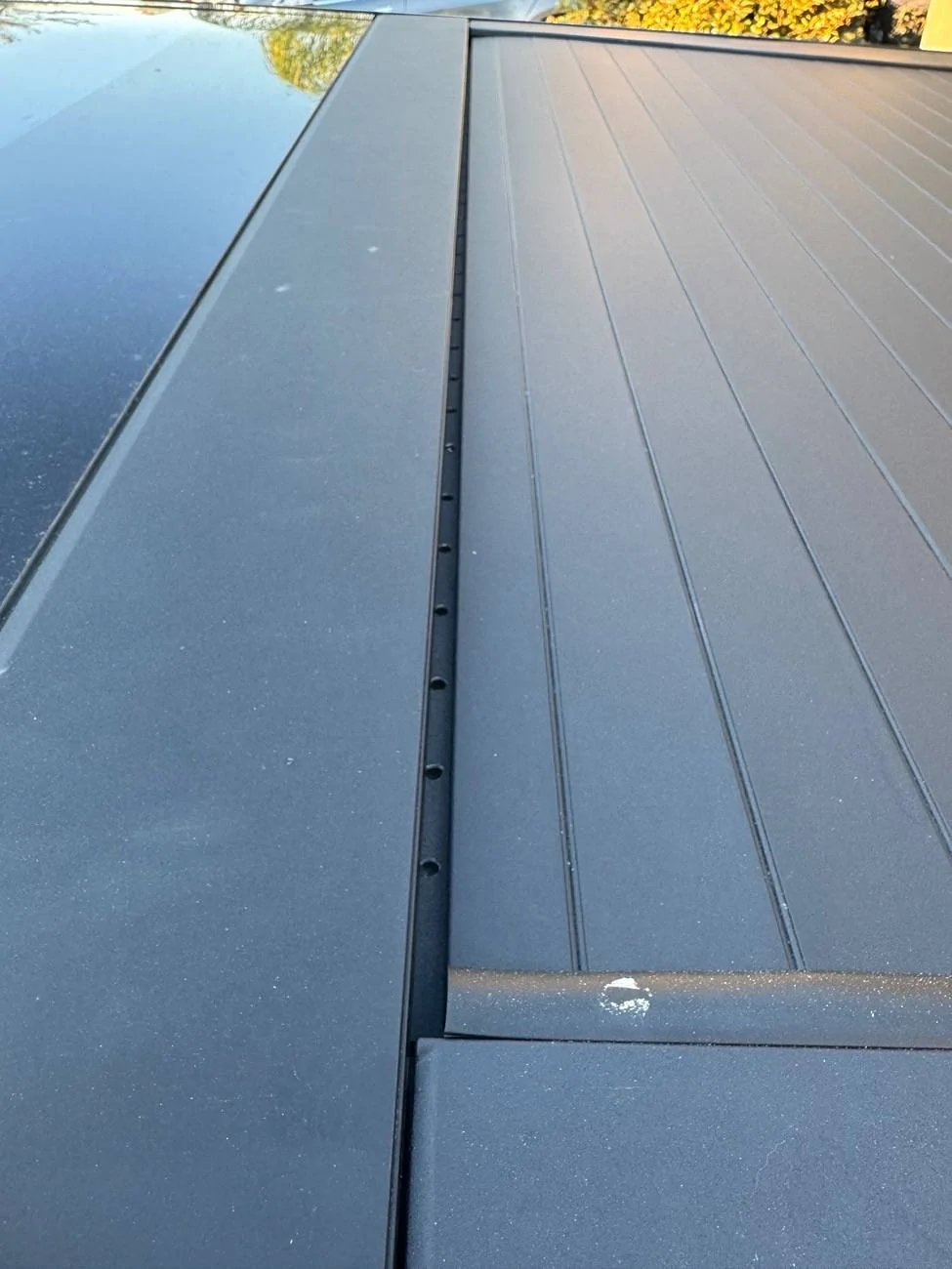

After 5-1/2 mos. of wait for parts, my SC finally got ‘em and replaced the slat. Good work too, can hardly tell they did work on the cover. Before and after pics attached.
That looks 100% better, did you have leaking issues prior to the fix?
How did you get the SC to actually fix it and not say "in spec"?
Can you get a pic of the interior of the vault with it closed, to see if you have the bar blocking the rear window?
I’m just curious…
Just put a link to the service manual that shows how and when to add the extra slat.
