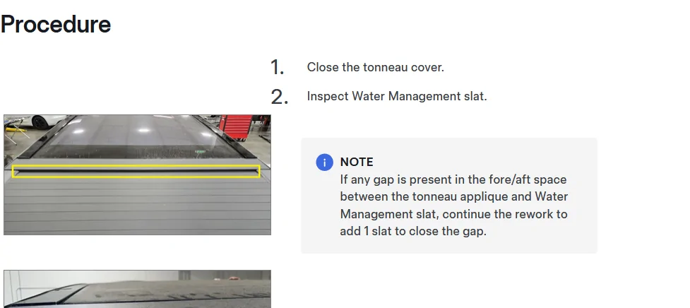

I showed the technician the repair bulletin posted somewhere in this thread. I only had to request a service once by doing that, though the wait for parts was long. I did have the water leak issue but that wasn’t due to the tonneau water management under the slat. That’s due to the gap under the panel between the roof and the tonneau (sorry forgot the name for it). I fix that following an instructional posted by another user. I also posted what I did in this thread.
From invoice:
Repair Notes: .inspected Tonneau and verified rework is needed, remove and reworked the slat system and ensure proper operation of the Tonneau.

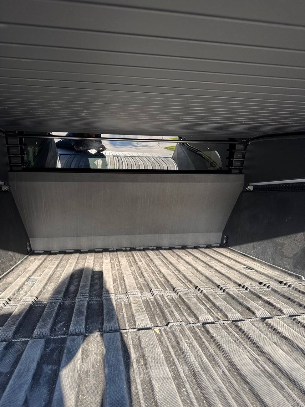

Can you get a pic of the interior of the vault with it closed, to see if you have the bar blocking the rear window?
I’m just curious…
You can see the bar but it’s high up so not really “blocking” and actually probably act as a safety bar in case anything slides forward.

Make sure to point out the blue “Note” under the Procedure on the Bulletin. That’s what I did. Not sure if it helped but it doesn’t hurt to do so.
Thanks have that saved on my phone for when I have my service appointment next week!
Thanks for posting. This is the same as mine, the crossbar is at the top of the rear window, which is the correct location based on the service manual instructions.

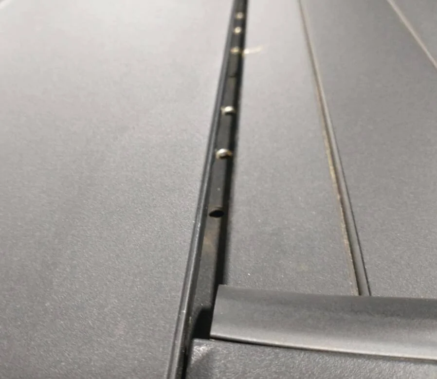

After tons of ticket requests about a leaking vault, pictures of stains down the back wall, a video of water coming in.
This picture is what finally got me scheduled for a rework....now to hope they do the weatherstripping while they are at it.
