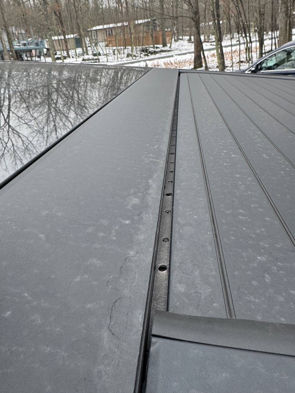

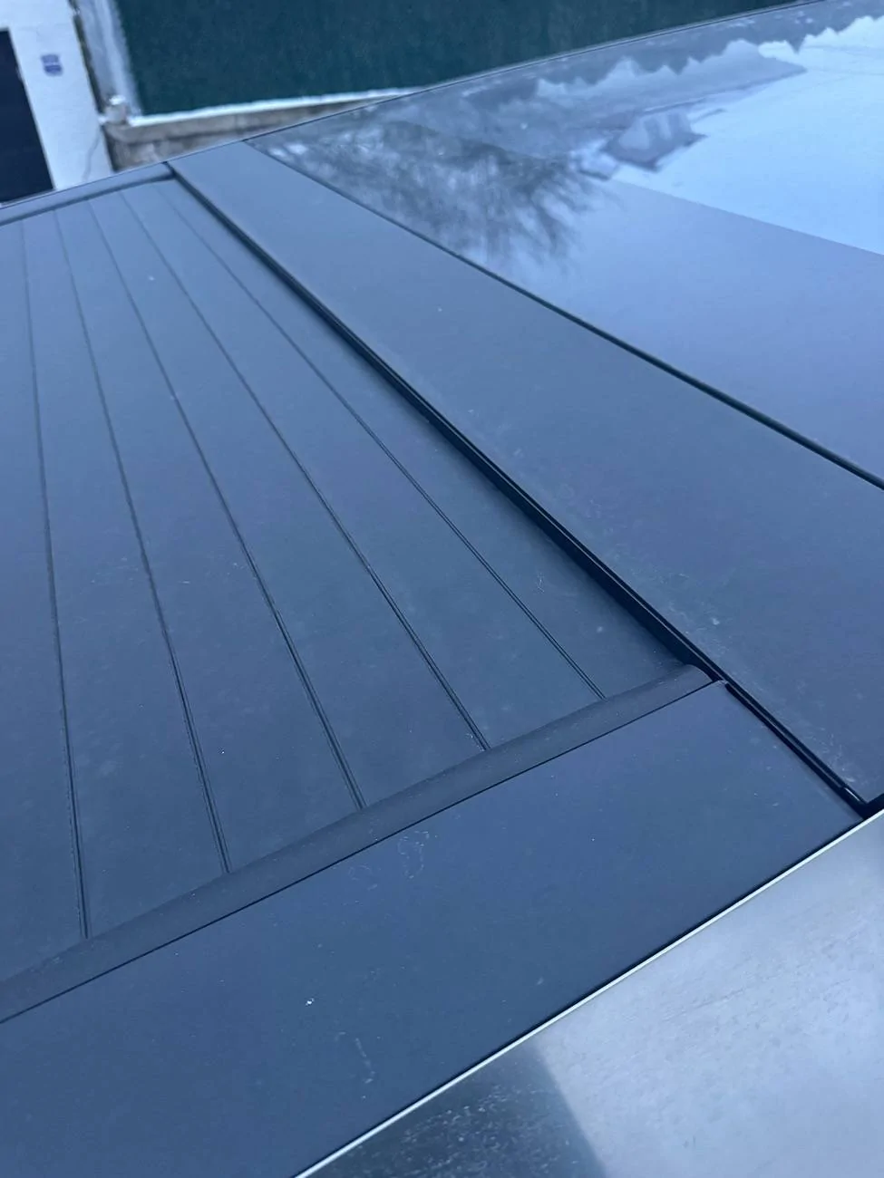

Very excited got mine last week and looks great now! Never got to inspect the weather seal under the appliqué before I took it in and will prob wait till warm weather to do some water tests and even consider trying to seal it myself. It does seem like I’m not seeing water dripping down the back but only checked once.
Big improvement and loos much cleaner
