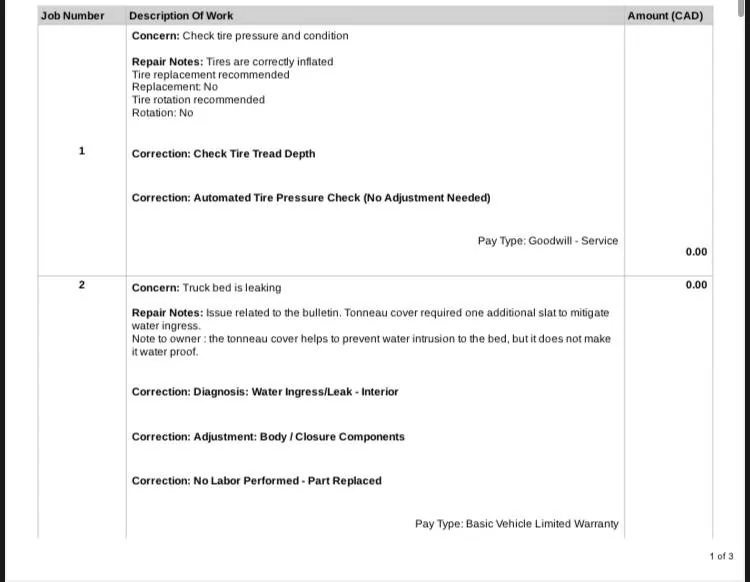

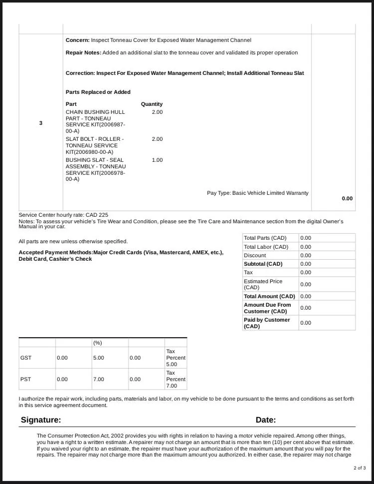

Are you able to post the tesla work order for this. That would be very helpful.
Didn’t even look at the work order until now. Looks like they just added a slat. The sealant must’ve been there before, but I didn’t notice!

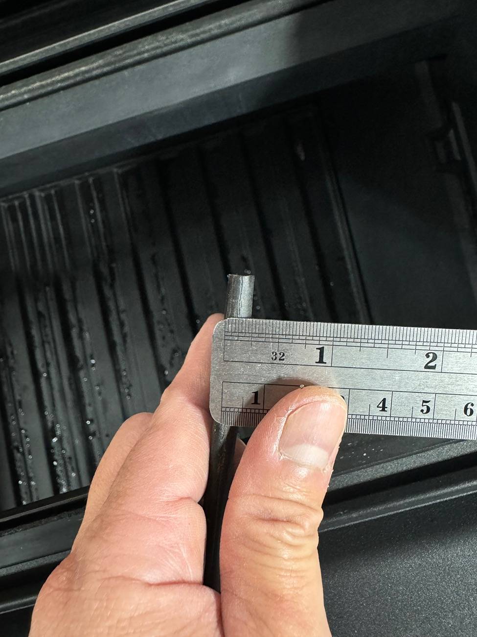

I guess it’s a hit or miss, that’s the exact same parts they replaced on mine and yet water intrusion from the top applique was still an issue so just had to fix it myself. Though everyone is right, Tesla should fix it. It’s not even a big fix, the rubber seal, which slides in the channel of the applique just needs to be thicker for at least 1/8”.

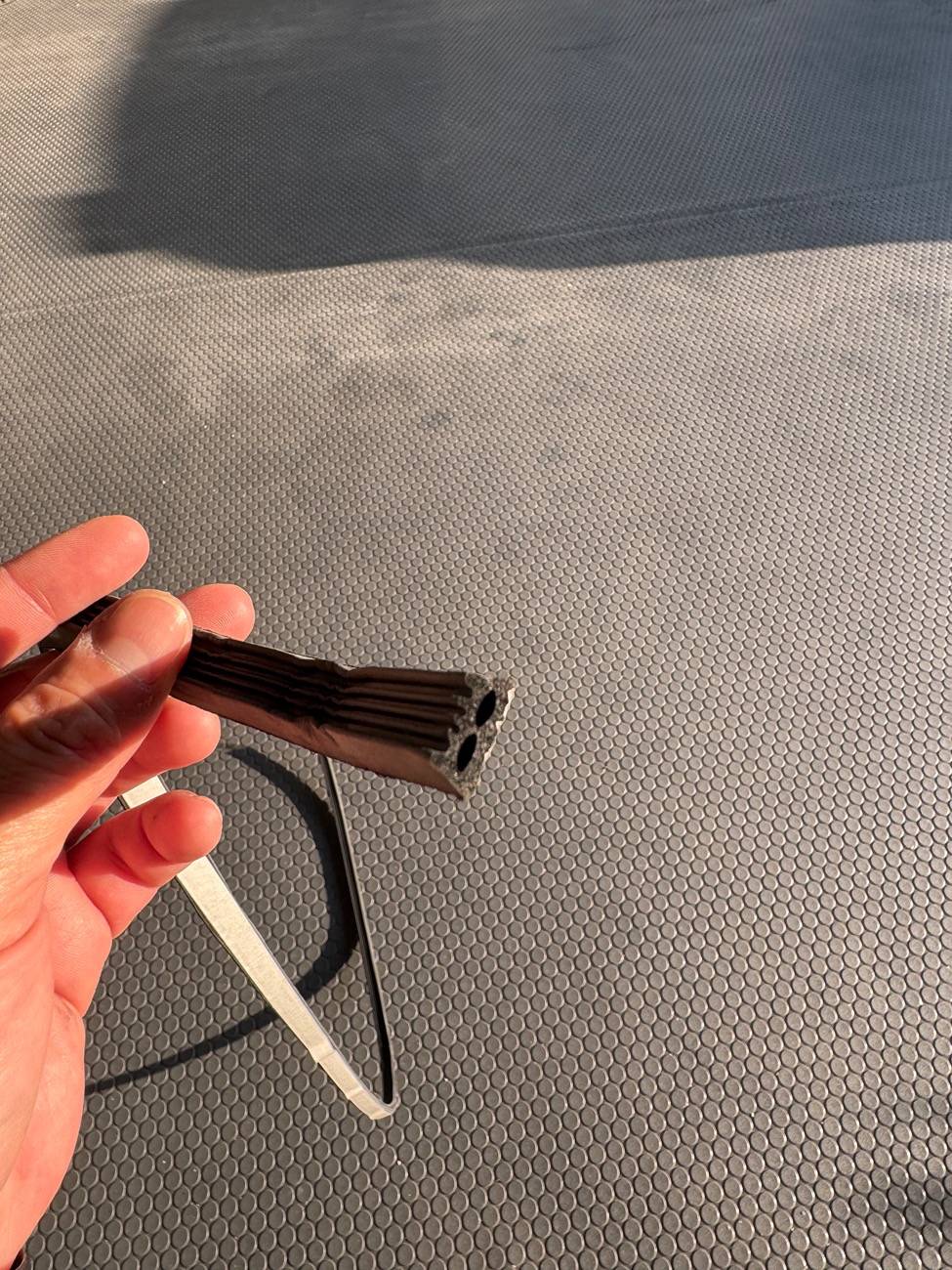

No that’s the OEM seal that they have. I was just showing the difference in size and the reason why water is getting through. The water you see is prior to me taking it apart, testing the oem seal first.

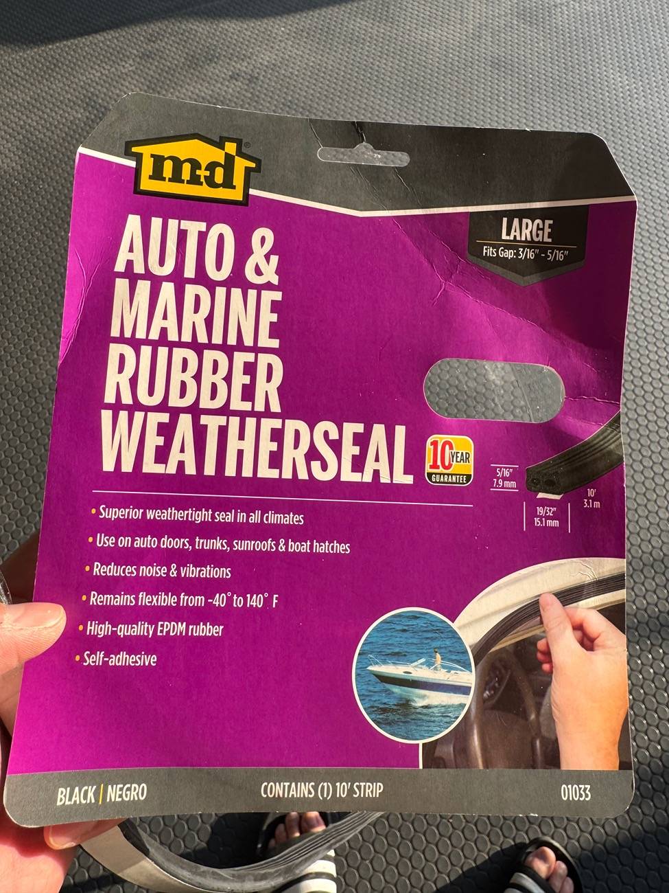

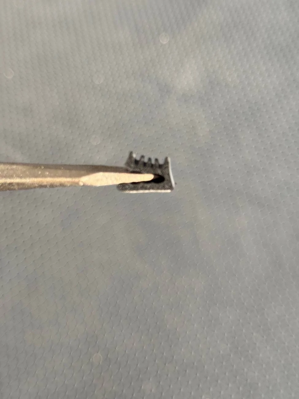

Attached is the additional seal I used. I cut one side, sandwiched the OEM seal and slid it back in. Just imagine the tip of the screwdriver as the oem seal. Ribbed side up towards exterior.

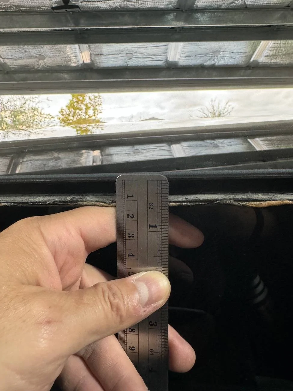

It will be a tight squeeze but it’s actually what you want. If you look at my previous pics, the biggest gap is about 3/8” and the oem seal is only a 1/4”.

No more water leak. Bone dry inside the vault.

Just up the glass but a little extra. The sides are tight that you can’t get additional seal in (you can see it just by looking on top even without the applique removed how the OEM seals are compressed on the sides-you can always try though) plus any water gets there drips in between the walls where there is an airgap, or in this case a watergap, I think as part of water management between side walls of the vault.
You can’t do the rear of the tonneau cover if I think I understand what you mean. The part of the applique that touches the cover is just a dust brush and nut a rubber seal. That doesn’t do anything for water tightness. The culprit of the main leak is where the roof meets.
