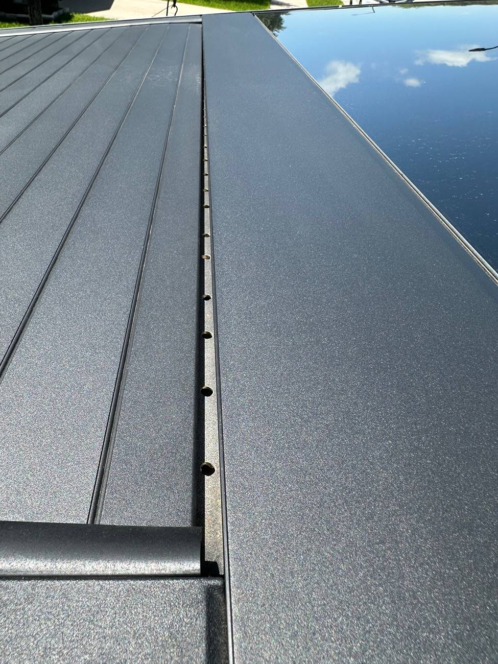

I just scheduled service for mine. I noticed that gap the first day but just thought that’s how they are supposed to be, until I came across this thread.

Does this look normal or should I request service on mine?
I would get that done. That’s supposed to be like a gutter and imagine a gutter with no screen, eventually it can fill up with debris and the water management holes with dirt.

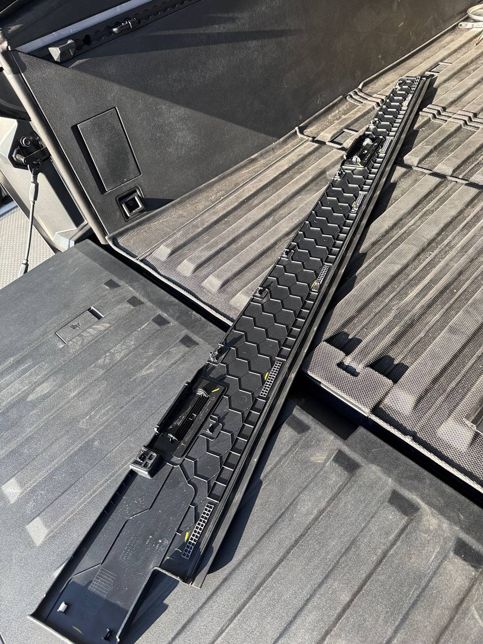

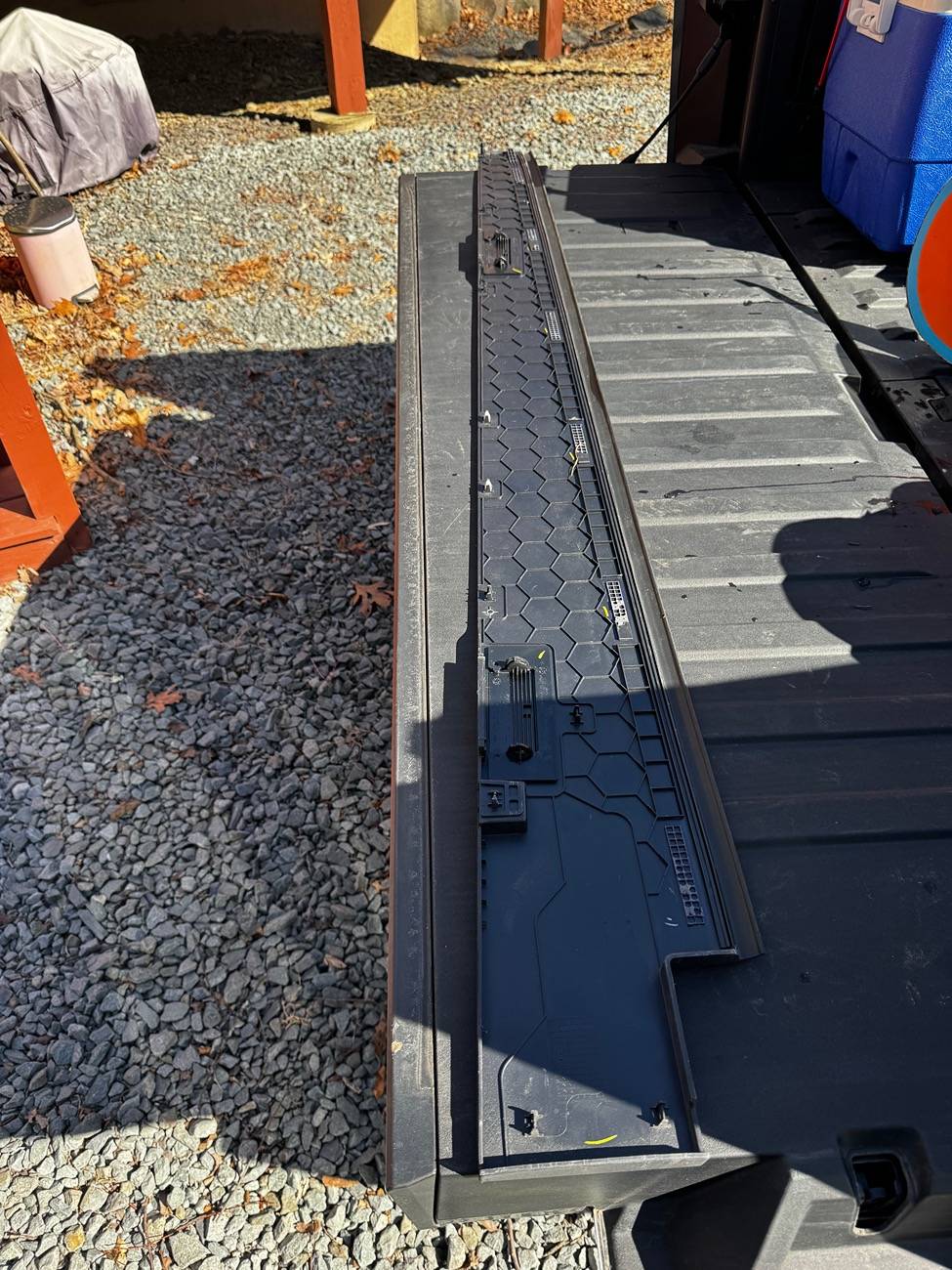

Yes they fixed it I posted the before and after. At first they complained it would take four people to remove it, I found that answer unnaceptable, provided the rework info and they corrected the issue. Just be sure they put new plastic trim pieces on the sides because they will snap and break them when they take them off, then they will fly away when it’s windy.

So first time driving the highway after getting my tonneau fixed and sure enough I got that issue you mentioned. Got a service scheduled and looking at the parts in the ticket, I deduced that they will be performing the retrofit for the whole Bed Sail Applique which I didn’t know there was one only after researching the part numbers. The old trims were still using double-sided tape in conjunction with anchors. The new ones from it looks like in the bulletin are all anchors, a lot more (17 plus, compared to the old 9x and 6x tape).
Appointment is not till next month so we’ll see. They will be replacing both left and right sides. And still “NO” on the foam seal on the roof applique though I already fixed that myself by adding marine grade epdm seal.
Correction code is 1220126006
I will post the link when I find it again (closed the browser by accident).
