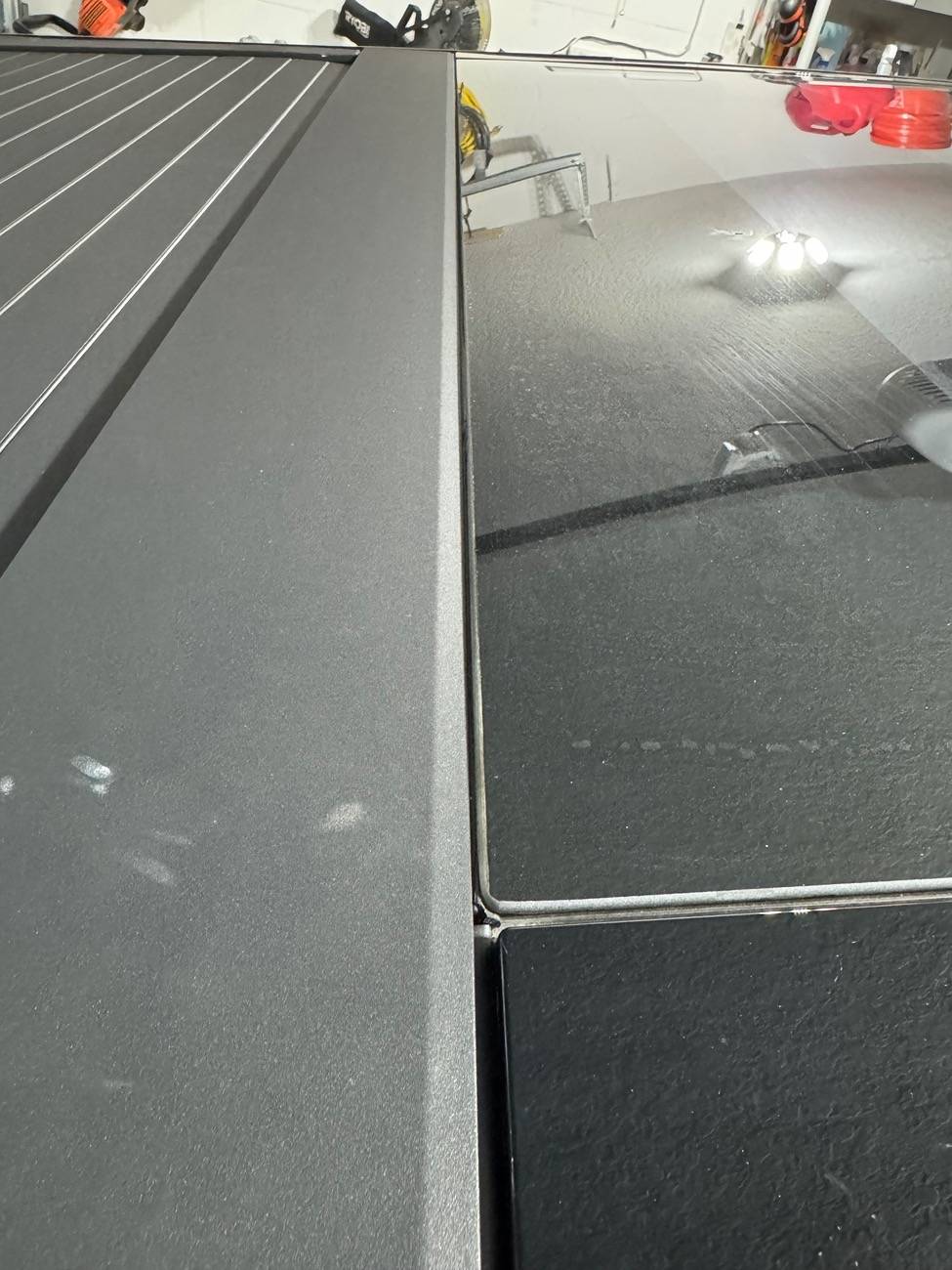

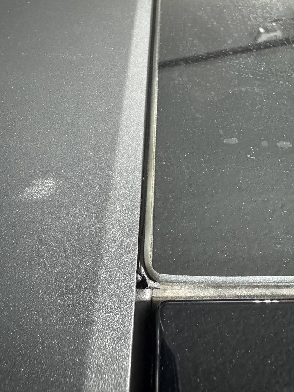

Nothing is sticking out where the glass roof meets cause you have that “channel” / gap where the seal will fit in. If you do decide to seal the ends though you will have seal sticking out cause the ends do not have that channel. You can see in the pic where I ended the additional seal. Maybe one of these days when I’m bored I’ll take it apart again and extend the seal all the way to the ends just to see if I can get away with it tucking it neatly so it’s seamless and not so obvious.
Ah that looks way better than I had imagined in my mind. You measured and cut the weatherstripping to be the length of the glass. Very nice.

Mine leaks where the glass ends if the new rubber is not extended all the way to both sides using 1 whole piece.
