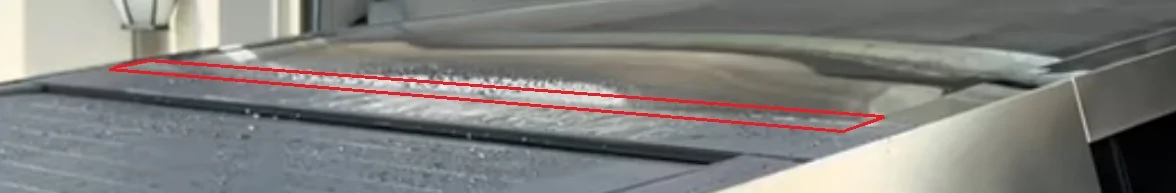

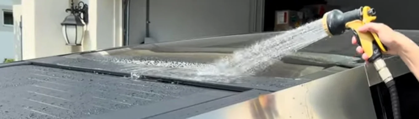

insert a door edge guard on the weather seal of the applique that touches the roof glass. Mine now is sealed and yes I live in SoCal. With that rain that we had, no water got in during my drive and car wash. If you’re going to the cyber odyssey event this January, I can show you
What door edge guard are you referring to? Would it be possible to add a link? I was visiting southern cali during the storms last week and all my stuff in the bed got drenched
I have an appointment with service center but from what I read adding the slat may not help probably need to do what you are referring to
Thanks

I share your concerns so I'm planning on letting Tesla try and fix first. If that does not work then I'm going to try and fix myself. I'm not going to just sit still and let it keep happening.
This is really a problem that Tesla should fix and sounds like they will based on one of the recent posts I read. Sounds like they are replacing the seal near the glass at the same time of adding the missing slat.
I plan on addressing this concern with the service center advisor at the time of service.
Again if it was just a little water intrusion not a big deal but everything was soaked in my bed this is not a within spec situation. I can also see water staining near the glass where the missing slat is I'm pretty sure that's the problem.
Will let you know after the service visit

I had to borrow my parents $25k Hyundai Santa Cruz for a recent trip, because it was going to be raining, and their tonneau actually works and is waterproof.
Looking at the video (#3 posting) I wonder if just covering the roof area between the glass and the top of the tonneau cover with a duct tape could prevent the water leak as a temporary fix?
