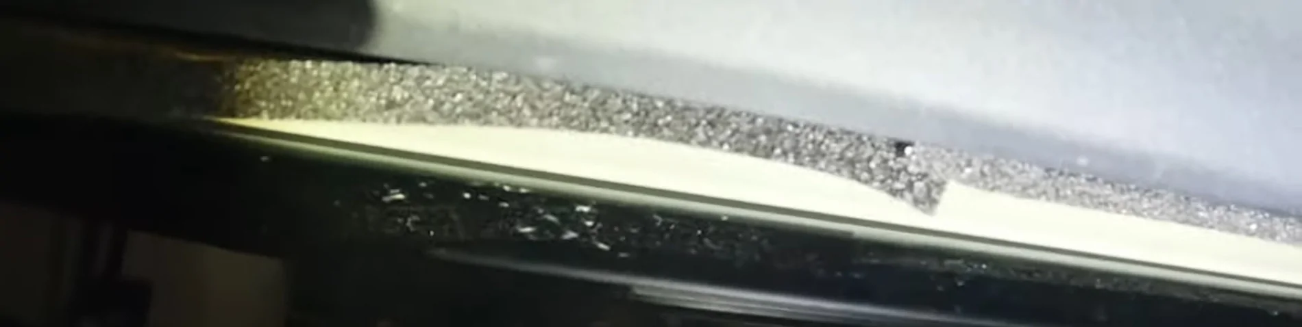

The cover itself is quite resilient to water, as there is little to no penetration between the slats nor at the sides. There is a little intrusion at the tailgate seal, but the real culprit is the gap between the tonneau appliqué and the roof glass. When poorly sealed, you can gently pour a glass of water on the roof and watch most of it splash into the bed.
There are fixes that involve improving the seal on the appliqué, such as this one:
This worked for me.

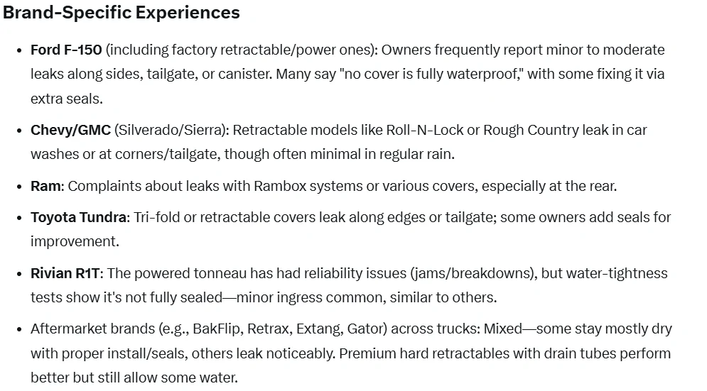

That’s all well and good, I had an F-150 prior to this, and it wasn’t “waterproof” but it was nothing like my Cybertruck. I’m talking INCHES of rain leaking in this thing. I don’t mind dampness, or a few drops around the sides. It pours into the Cybertruck vault. Unacceptable.

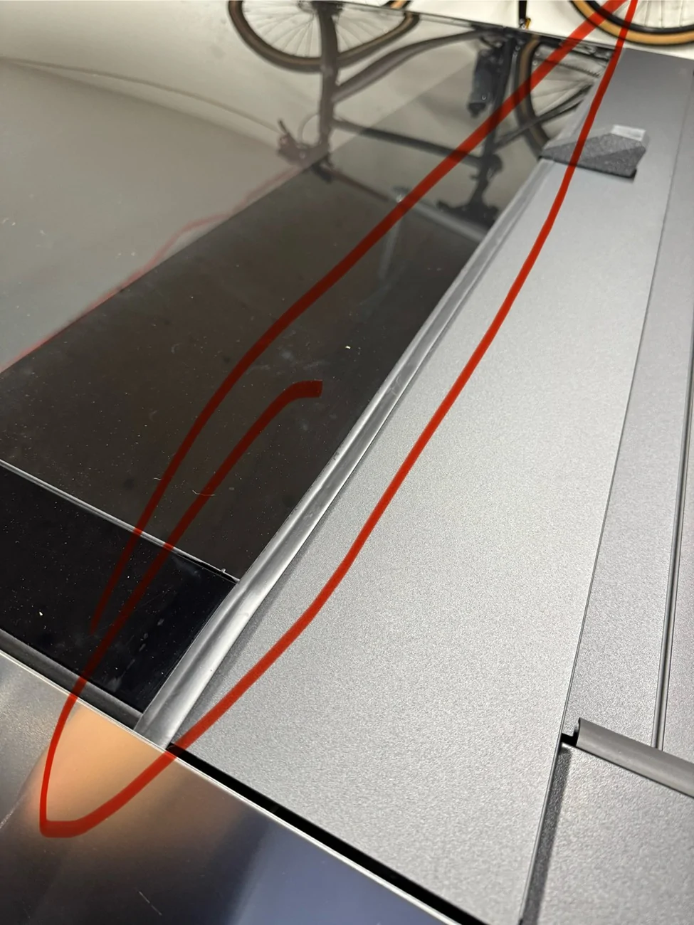

I added a small piece of weatherstripping and haven’t had any leaks since.
It’s not meant to be watertight, but this certainly helps!
Didn’t have a drop of water in the bed from the socal rains last week, but I have seen some water in there after some pressure washing.

Did the exact same thing with my truck and haven’t had any leaking since. Had the extra slat installed and it did nothing for leaking (still worthwhile because leaves/acorns/debris would fall into the channel and drop into where the cover retracts when operating). Once you take the appliqué off it’s easy to see where you should add a strip.

No, it doesn’t void the warranty. It’s literally replacing the foam seal with one that actually seals between the appliqué and roof glass.

not complicated, better seal at the applique to glass edge
stronger seal at tailgate end
Note like the sloppy job shown in the video,
using two disjoint pieces of rubber not sticking to the frame and dangling !!!
