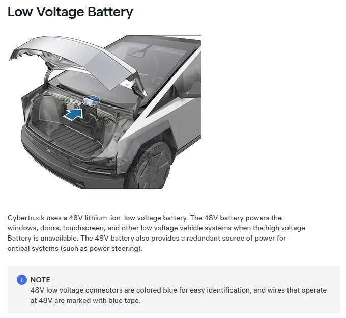

Yes there is. It powers 12v accessories.
I still don't think there is a 12v battery in the CT.
From Google:
No, the Tesla Cybertruck does not use a 12V low-voltage battery for its main systems. It is the first production vehicle from Tesla to feature a full 48V low-voltage architecture. This 48V lithium-ion battery powers systems like the windows, doors, and steering.
Key details regarding the Cybertruck's electrical system:
48V System: The truck uses a 48V battery, which allows for thinner wiring and higher efficiency.
12V Compatibility: While the main system is 48V, the user manual indicates it can still be jump-started using a 12V source in emergency situations.
Accessories: Standard 12V accessories cannot be plugged directly into the system, often requiring 48V-to-12V converters for aftermarket electronics.
From TESLA:
Low Voltage Battery
The front of the vehicle with the hood open and an `arrow pointing to the low voltage battery
Cybertruck uses a 48V lithium-ion low voltage battery. The 48V battery powers the windows, doors, touchscreen, and other low voltage vehicle systems when the high voltage Battery is unavailable. The 48V battery also provides a redundant source of power for critical systems (such as power steering).
Note
48V low voltage connectors are colored blue for easy identification, and wires that operate at 48V are marked with blue tape.
By using a 48V low voltage battery instead of the 12V lead-acid battery found in many conventional vehicles, Cybertruck is able to operate more efficiently.

hmm maybe it is a 48v battery, just figured it was a 12v given you use a 12v jumper to energize it to open given doors and hatches. Must be a bypass cables that go straight to those items bypassing a step down converter.

The there is a 48v battery instead of a 12v battery. The made it so a 12v battery will open the frunk and jump the system to get it going so that you would be able to jump it with other 12v vehicles or a 12v jump pack.

Hmmm!! No MAYBE about it. It _IS_ a 48v lithium battery that provides the low voltage power on the Cybertruck. There is NO 12v battery on a Cybertruck.
