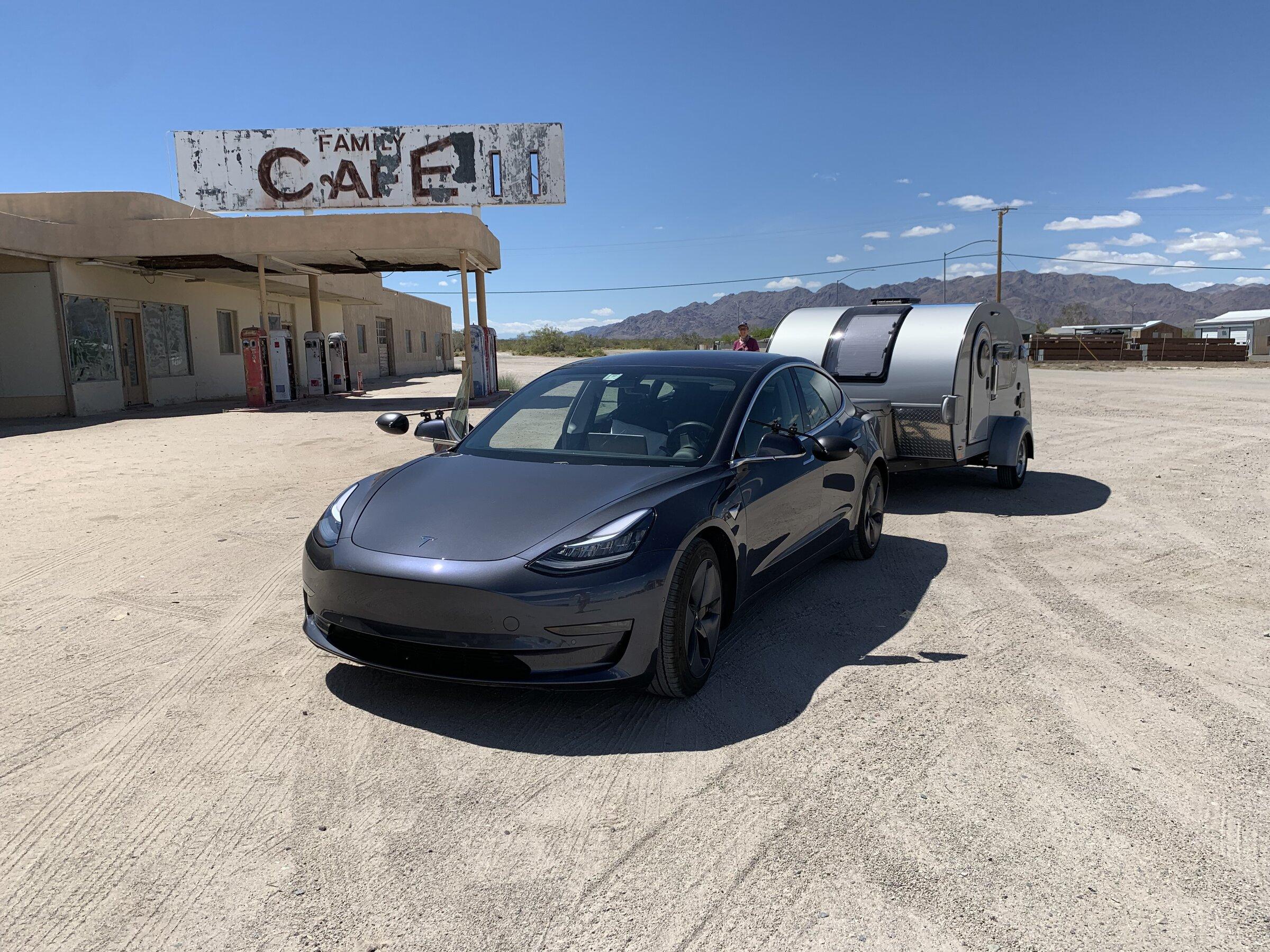

My 2018 M3 gets about 2 miles per % of battery charge when towing a teardrop trailer. I expect things will only improve with newer vehicles.
Yep, Aerodynamics matter. That's signficantly more efficient then what they were driving in the video. Do you find your self stopping often to charge?
