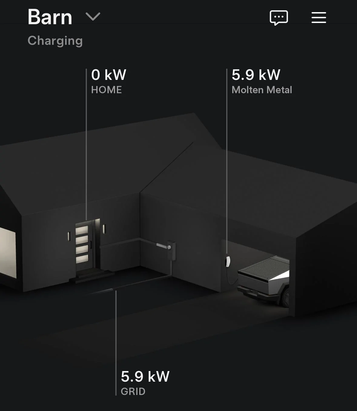

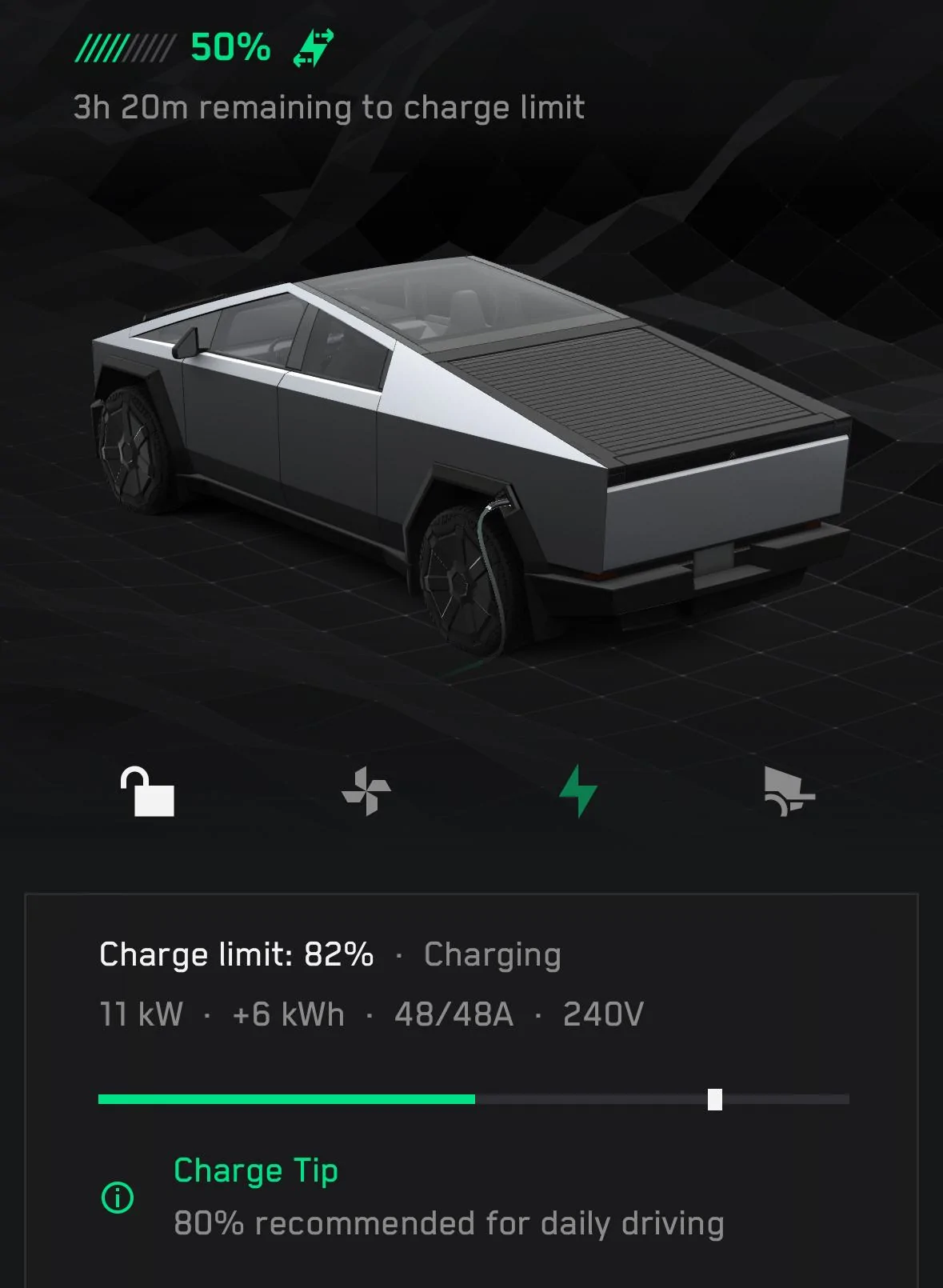

Truck charging at 11kW, Gateway shows 5.9kW?
BoBlack
Jul 17, 2024
Ohio
Had my PowerShare hardware and wall charger installed.
Has anyone else seen this? Wondering if it’s a software issue or a loose Ethernet/comms cable?
Confirmed truck is actually pulling the full 11kW
Tesla Cybertruck Truck charging at 11kW, Gateway shows 5.9kW? IMG_6567
Tesla Cybertruck Truck charging at 11kW, Gateway shows 5.9kW? IMG_6568
Looks like current sense transformers aren't configured correctly.
5.9kW×2 in = 11.8 kW = 11.5 kW to Cybertruck + 0.3 kW to house

Ok, thanks. My installer hasn’t seen that, was told I should contact Tesla support which I’ll do tomorrow. Thanks
Contact your installer 1st. It is most likely a ct not hooked up properly. Ct #1 or 2 could be in reverse polarity.
