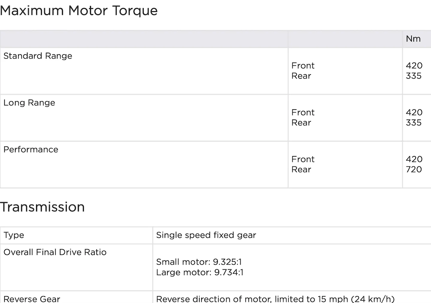

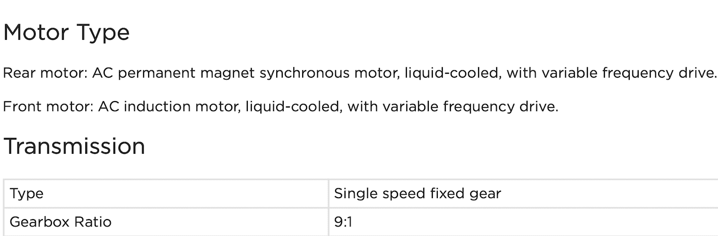

Both the Model S and X have this in the Owners Manuel under Specifications - Subsystems
Tesla Cybertruck Value of long range variants. Screen Shot 2020-12-20 at 7.45.23 AM
Tesla Cybertruck Value of long range variants. Screen Shot 2020-12-20 at 7.46.24 AM

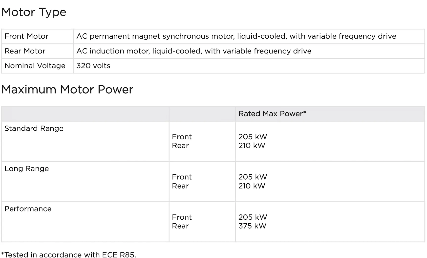

The Model Y shows this
Tesla Cybertruck Value of long range variants. Screen Shot 2020-12-20 at 8.12.53 AM
