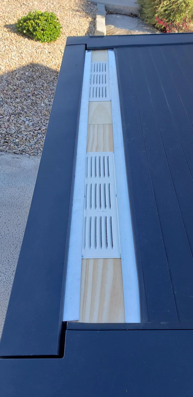

I'm going off-roading in the Tonto National Forest next week with three overnight camping stays planned. Since flies and mosquitoes are likely to be a problem with water nearby (Roosevelt and Apache lakes), I needed a way to ventilate the vault when sleeping to keep the CO2 level down. I made this device to allow air in and keep the bugs out. I made it using two 3/8" thick pine boards, hinged in the middle so it can be inserted into the tonneau tracks on both sides. Common screened soffit/gable vents cover cutouts in the boards. I borrowed the aluminum angle irons from my A/C Lexan insert to add strength to the vent panels. Here it is installed.
The tonneau vent worked well. The CO2 level in the vault stayed well within the healthy range (420 to 1400 ppm) with two people sleeping inside.
I found that placing the vent panel between the gate and the tonneau as shown has to be done before getting into the vault to sleep. It’s very difficult to close the tonneau using the app from inside the vault. When the tonneau strikes the vent panel, it retracts a distance of about 8 inches as a safety feature. One does not have fine control of the tonneau using the app as is possible from the physical controls.
I had to first install the vent panel (or the Lexan panel with BougeRV air conditioner), then carefully close the tonneau against it using the physical tonneau close button. I can then crawl into the vault through the open gate.

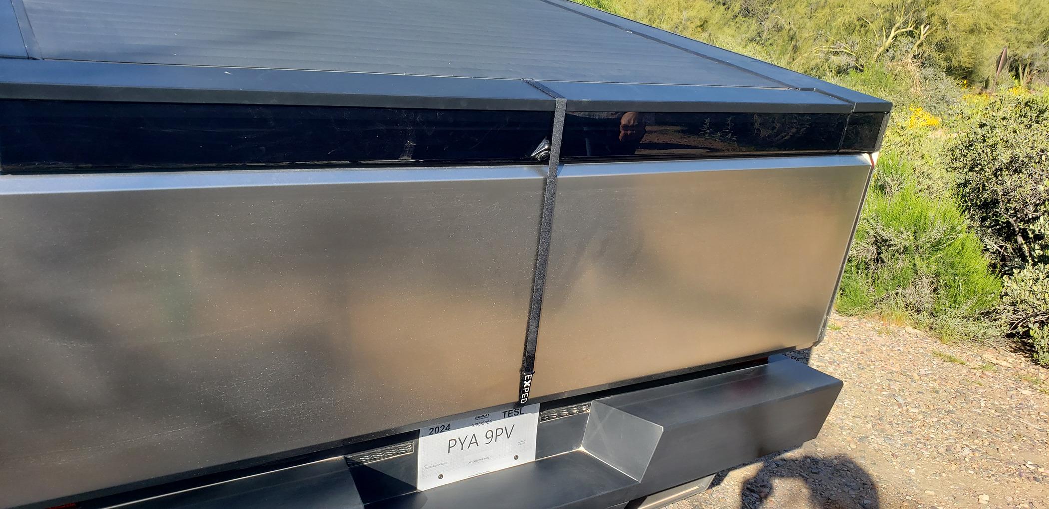

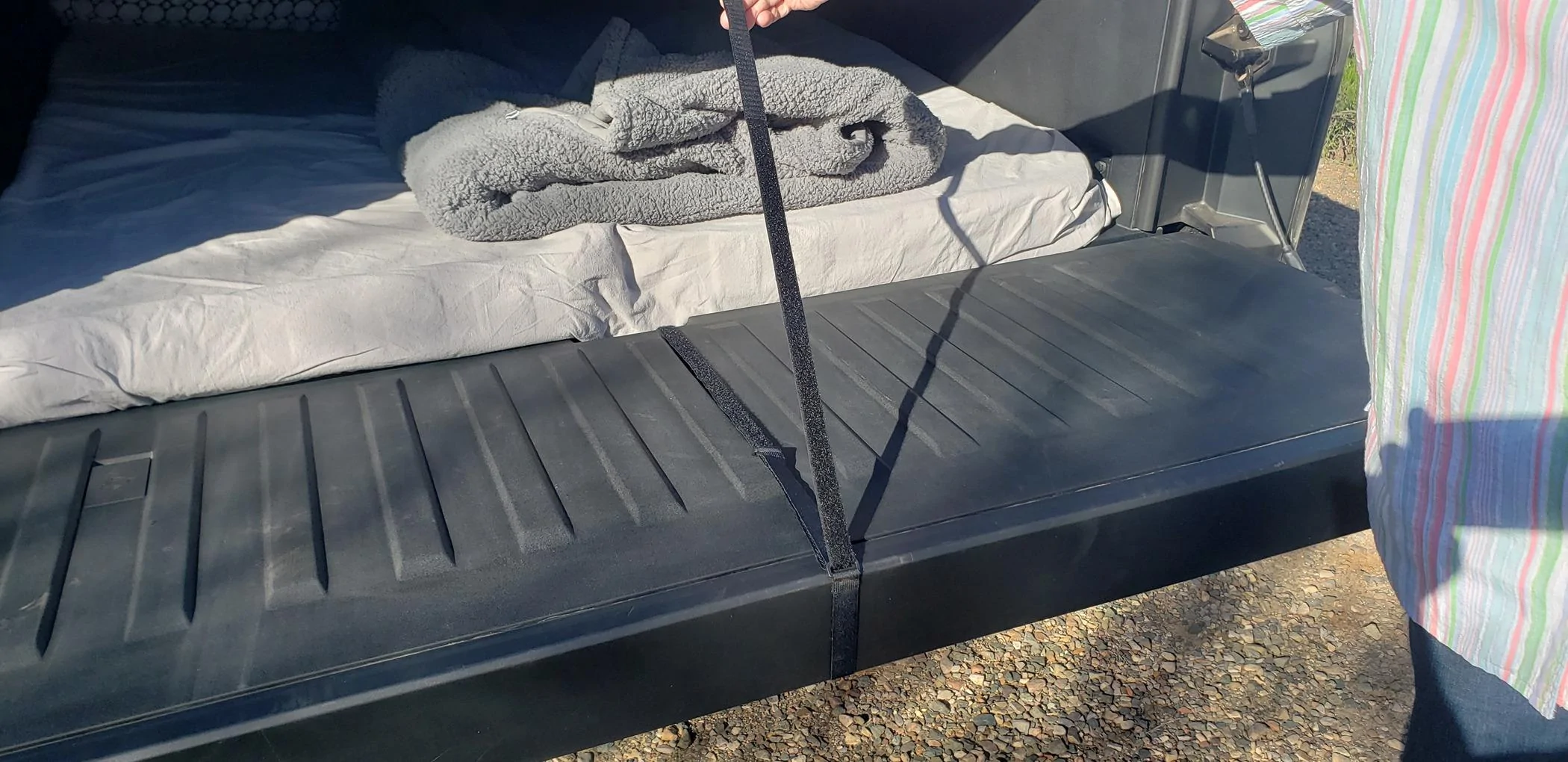

Unfortunately, I was not able to close the gate from inside the vault. I didn’t have the strength (leverage) needed to do so by pulling on the gate at the emergency release opening. I solved the problem by wrapping a strap around the gate with a length of the strap extended from the top of the gate. From inside the vault I could pull the strap to raise the gate until it latched shut.
Tesla Cybertruck Vault vent for sleeping Gate Strap 1
Tesla Cybertruck Vault vent for sleeping Gate Strap 2
The strap can, of course, be removed. No modification to the CT is needed.
I haven’t tried it yet but what about calibrating the tonneau cover with your vent in place. That may reset it so it will close against your vents without seeing it as an obstruction. Then recalibrate again once the vent is removed.
Yes, I thought that might be possible. I tried to recalibrate the tonneau with the vent panel in place using the Service menu. It throws an error.
