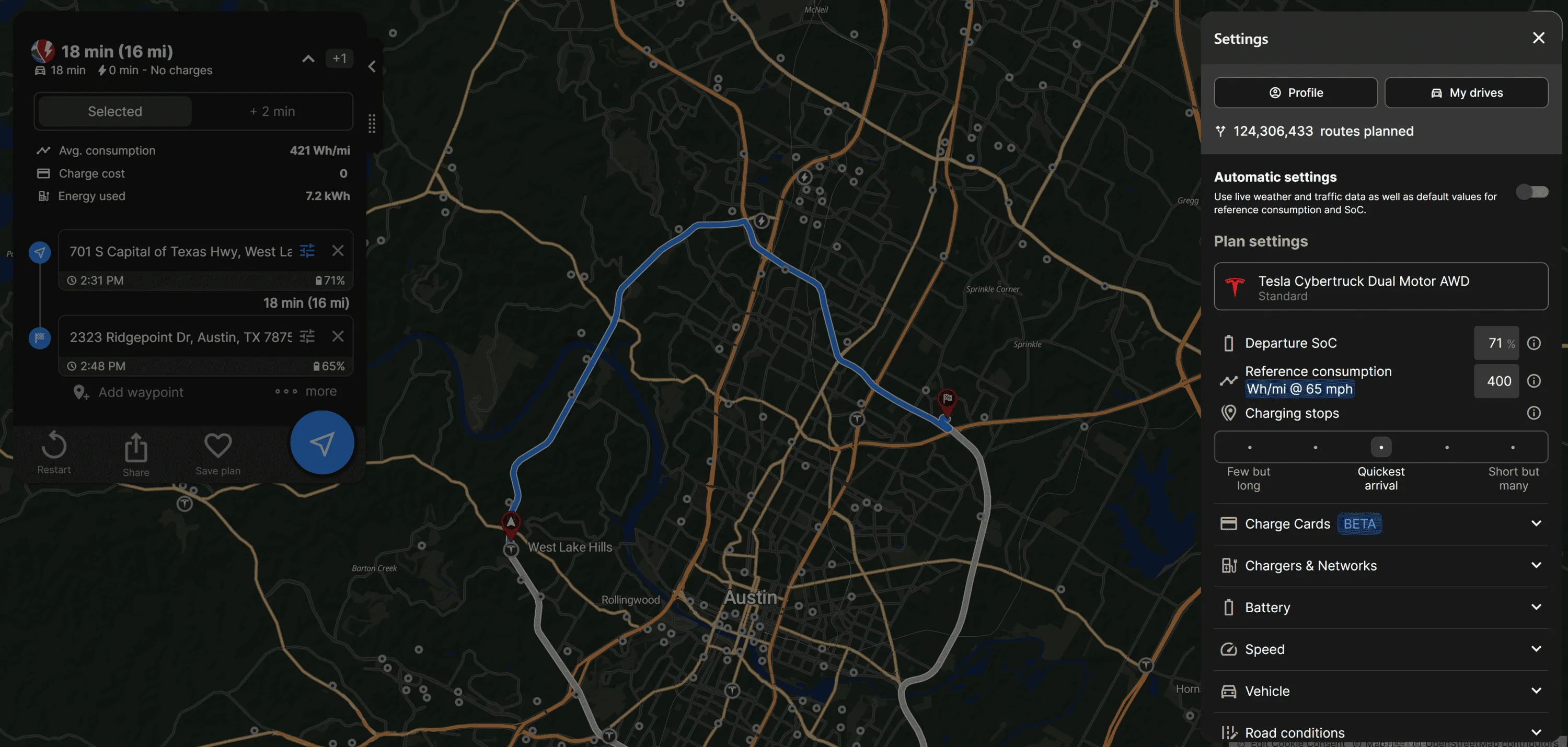

Set at 110% Speed Limit but there way also traffic at that time of the day that ABRP isnt using.
Yep looks about right around the 400Wh/mile mark as expected from our other calcs as well.

7.2kWh used with a 6% depletion would yield a 120kWh pack. Reversing this again yields 267mi. If we use 2.5mi/kWh then that should be 300mi even.
Yes, some where in the range of 115-120 usable kWh. That's if the GUI isn't disinformation and just linked to the dual motor cybertruck on ABRP. lol

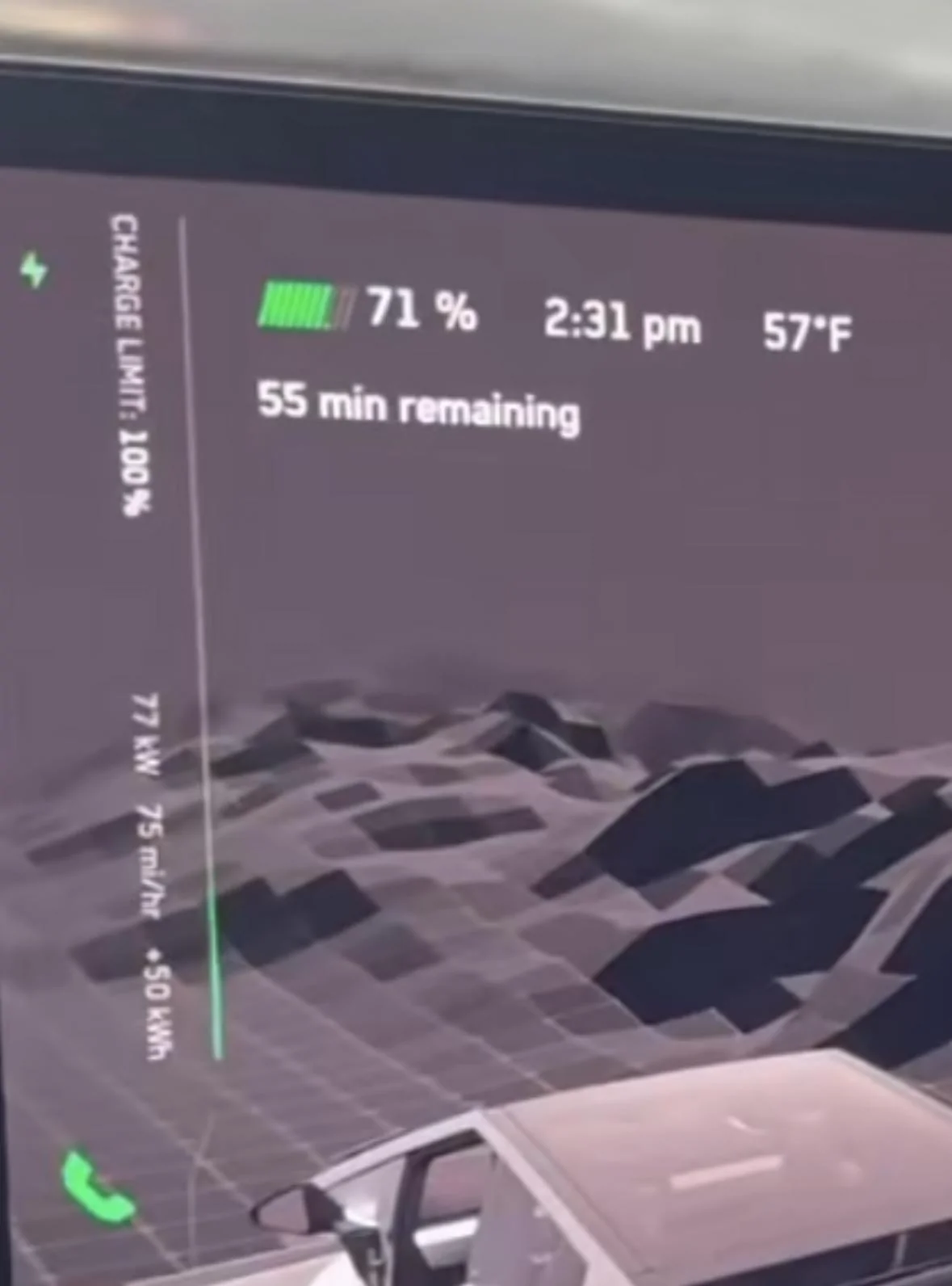

Do we think the topographical geometry is being procedurally generated from camera inputs or it's just there to look cool?
It’s “Westlake Hills” not “Westlake Mountains”
Definitely produced by the onboard cameras but probably not accurately in these images yet?
It will be interesting to see it identify terrain in detail for a detailed 3D view whilst off road.

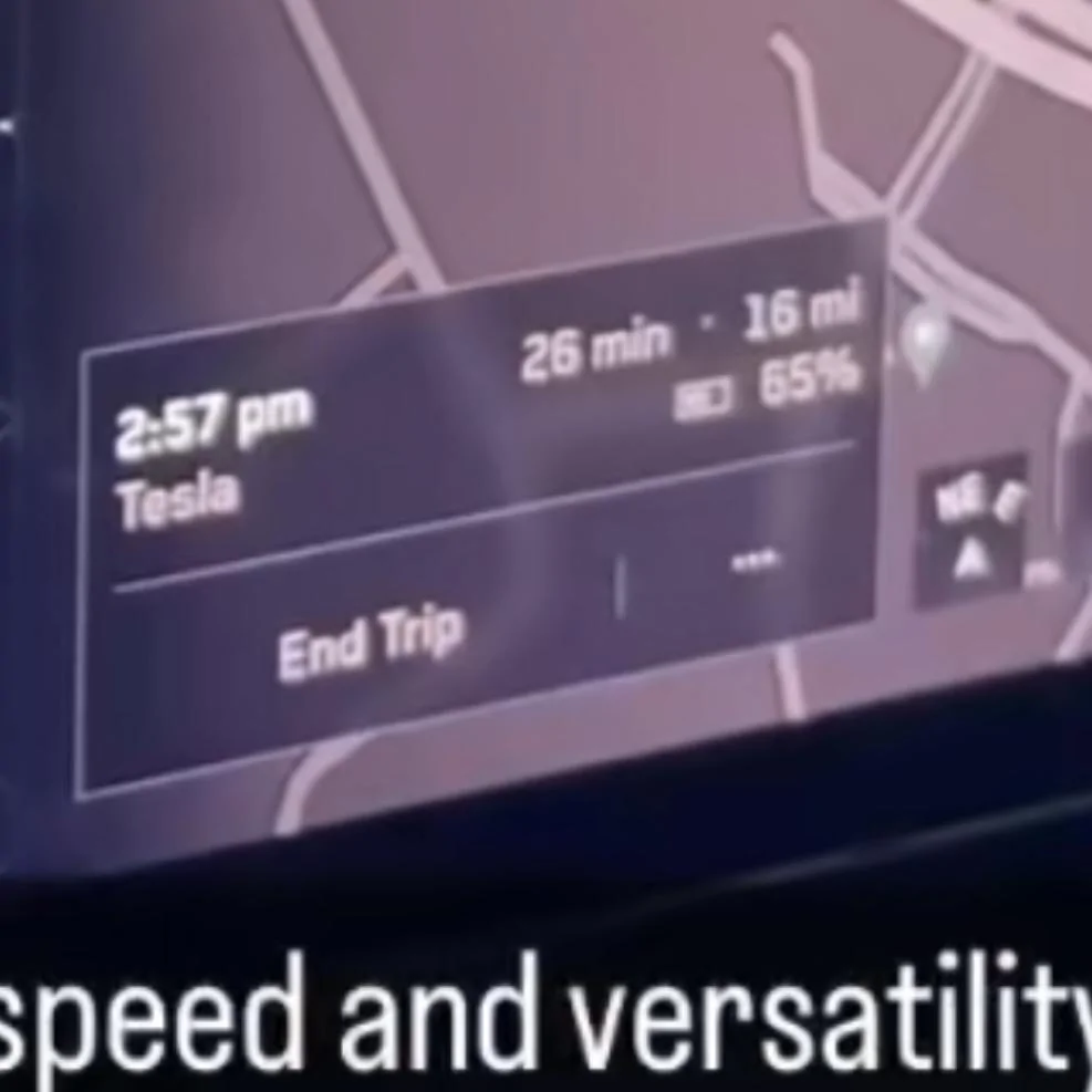

The tiny details might matter here.
Displayed SOC on the screen for 71% on the BMS could be anywhere from 70.5%-71.4% a 0.9% margin of error. That also means that arrival SOC has same margin of 64.5%-65.4%.
If you take the absolute worst case scenario that is leaving at 71.4% and arriving at 64.5% you get 6.9% battery used to travel 16.3 miles.
16.3 mi / 6.9% = 236mi of range
Now lets take the absolute best case scenario that is leaving at 70.5% and arriving at 65.4%, in other words 5.1% battery used to travel 16 miles.
16.3 mi / 5.1% = 319mi of range
The trip computer also takes into account recent driving behavior which can further exacerbate our calculations. If the driver's efficiency is consuming 20% more battery than EPA range you can easily see the calculations growing more uncertain.
All I am trying to illustrate here is that there are some large error bars when calculating range with limited information.
Any battery experts ( @JBee ) want to break these down?
I think i got the route.
