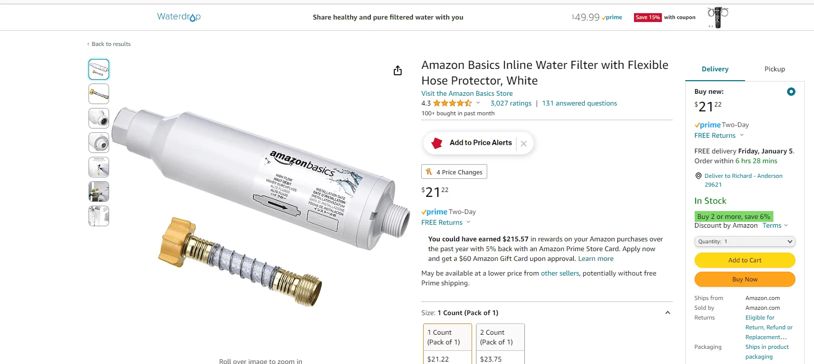

Do you think a hose adapter like this will be successful in turning hard tap water into soft water, or is something more complex required?

No, that is a particulate (sand, grit, dirt, pieces of plastic, etc) filter. Typically these filters remove 5-50 micron sized particles. Hard water (calcium and magnesium carbonate) are much, much smaller molecules and require a water softener. If you have a house this is doable. I have a soft water tap in the garage, and soft water for the whole house. I've never asked commercial car washes if they use soft water. My Model S is always hand washed. Perhaps I'm anal.

Yeah, I was thinking the same thing. I just bought one. My wife has a ton of plants outside she waters and apparently plants like filtered water better than tap water. SO, if this isn't good enough for washing the Cybertruck, at least it can be good for feeding the plants. lol

Well, that sounds pretty complicated for what I can afford. Our tap water is pretty good, but was hoping that this filter would make it better. Well darn...

This one says reduces hard water for car washing, but I don’t know how effective:
AQUA CREST Inline Water Filter, Dedicated for Car Washing, Yard Cleaning, Reduce Hard Water Spots, Soften Water, Upgraded Formula with 1 Flexible Hose Protector https://a.co/d/8h8OoM0
