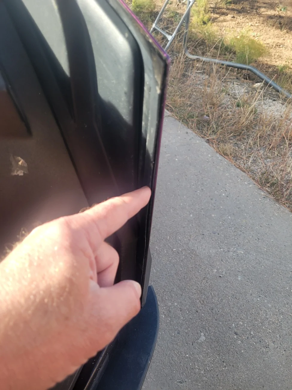

Folks, I think I found the fix!!! This has been bugging me for more than a year. After I realized it wasn't bearings or coolant or pumps....it had to be air flow. The key was you would hear it going straight, or a right curve, but not on a left curve. So, what I did today was to add a rubber sealing strip at the vertical gap between the driver's side frunk and the left front quarter panel. Voila! The noise is gone. Next I will do it to the right front gap as well, and maybe even along the top edge of the frunk. Bottom line....that high speed air (40-80 mph) was getting inbetween metal surfaces along that substantial gap, and causing rustling or vibration noises!

Can you take a pic and mark it up just so my imagination can not over engineer as usual please

Did you put anything in the gap between the light bar and the panel? Mine is more significant on that side compared to the the passenger side.
