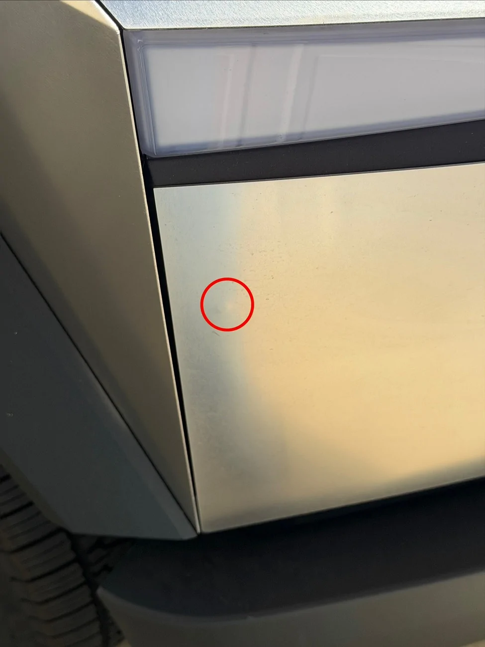

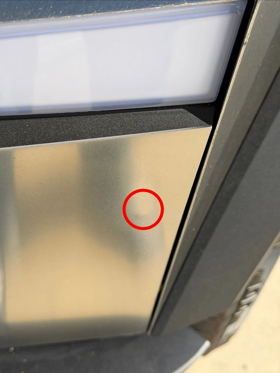

Those will the new “blue goo” structural adhesive shouldn’t suffer from panel adhesive issues. It was an assembly line running change made in 2025. The older structural adhesive was grey in color.
I noticed signs of welded studs, like at the base of cantrails, on that front piece of my '26.
