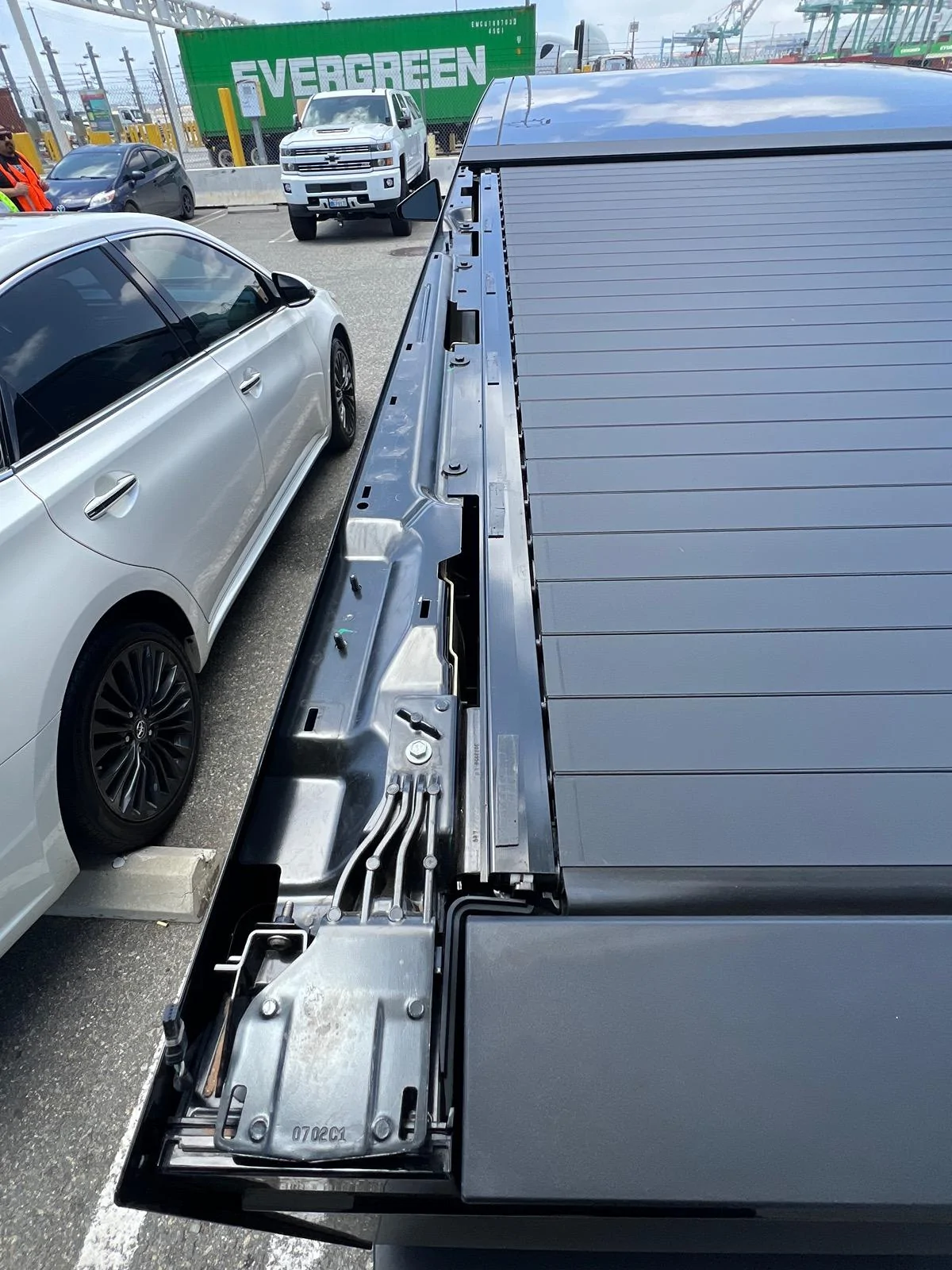

I believe this is the 3rd time this issue has been posted to this forum? Maybe there are more. I am guessing another recall might be coming. This could kill someone on a motorcycle.
Mine flew off in transit before I even took delivery. So add one more to that list. (Still waiting on delivery too)

I was leaving home this morning, opened the vault to put my lunchbox, when I got to work and went to open the vault, I couldn’t find the buttons or the panel it was mounted to. I’m assuming it flew off on the freeway. I hope it didn’t hit anyone. Now that’s concerning!!
Join the club I lost mine. Also this piece of shit vehicle needs to go back and be put together in the fashion of what $100,000 vehicle should be
we am being made fools of with this vehicle that it’s fit and finish is the worst I’ve ever seen in my 40 years of being the automotive industry from panel gaps to trim the panels flying off. It’s a joke.

This happened to me the first week I had ROBO back in Mid April... The installer did not remove the plastic on the double sided tape. Arranged a service call with Tesla and they were very responsive. Set up a service date about a week later. Then driving down the road I noticed the other side was flopping in the wind! I pulled over, and sure enough, the other side of the double sided tape was not removed. I was able to lift the panel about an inch and remove the plastic, and secure the panel. Tesla replaced both sides.

After reading this thread and also seeing a Facebook post from a Cybertruck group, I thought I'd check my rails. I had seen a short video from someone (I'm trying to find it, but can't so far) who showed how to run your fingers along the length of the rail and pressing down to make sure all the clips are snapped. I took a look at my left rail from the tailgate POV and noticed it wasn't quite flat. There were a couple of gentle bumps. I then used my fingers to gently press down as I moved up the rail and felt 2 firm clicks as the clips snapped into place! Then I checked the right rail, and found one clip that I snapped into place! Thanks to this forum, I hope I was able to prevent a flyaway rail, because I found these 3 clips that weren't even snapped in.

I saw my first Cybertruck in Dallas while I was out on my CBR1100. It was an experience. I tried to get closer, but the truck flung a metal spear at me. ... I am of course kidding. Losing a long sharp metal body piece is pretty scary to the folks behind. Hopefully no one has been hurt.
This part isn't metal; it's a plastic access panel.

I also had the same experience. I noticed it wasn’t flat and similarly just snapped it down. All good now.
