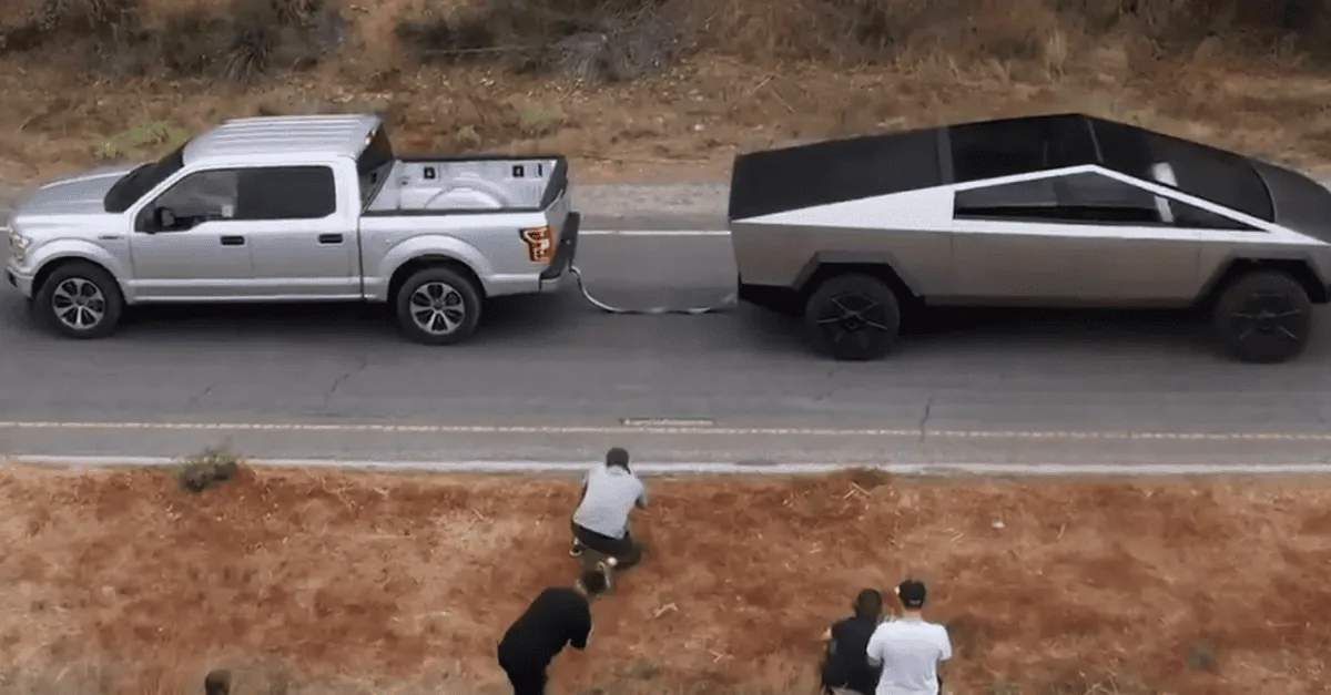

Tesla's Cybertruck Tug-of-War Stunt Was Pointless
Engineering Explained - 3.56M subscribers
This kind of test would be more illuminating as to the real capabilities of various trucks if they were loaded to their maximum GVWR and equipped with the same tires. Then the test would come down to how much weight each truck could handle, and how good the traction control was under full load. Also, it's also important that the tow rope is attached so it's level to the ground, something that is often overlooked.
Of course, the Cybertruck would still beat the Lightning, without a doubt, but at least it would be a fairer battle.

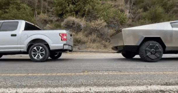

that may a been a theme of the unveil presentation, but it was certainly *not* the context of the stunt against the 2019 CT prototype. which is sort of the point
The F-150 used in that stunt was a lower-spec STX package was a 2 wheel drive (i.e., a single, powered tire in the rear, where there's ~no weight), on stock tires, in a short-bed configuration (145.4 wheelbase.
Meanwhile, the CT prototype was all-wheel drive, on 36" mudder tires, with a noticeably longer wheelbase, and whatever the CT prototype weighed (we dont know), as a BEV it was distributed ~equally 'over' all four tires.
these differences, given that these pulling stunts come down entirely to traction, is why the stunt had nothing to do with the theme of the unveil presentation
I don’t, and never did, care about the stunt. I was only responding to ‘your’ comparison to something much larger and heavier. We need not go down this path because I am of the belief that Tesla should be doing payload and tow testing in all conditions and road types.
