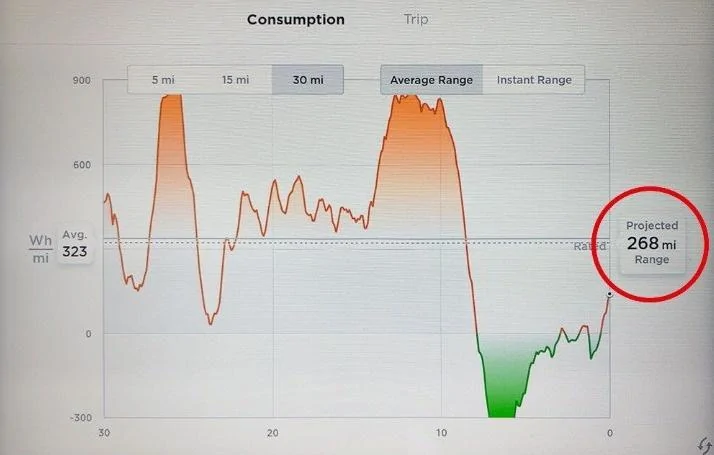

Right, not new but just seeing what others have seen on their CT. I bet Noone has seen anything near 340 at 100%
The range on the screen has nothing to do with driving habits. That's all the BMS. You ate talking about the predicted navigation range.
In all my trips I look on the energy graph and the 'projected range' for the last 30 miles if I'm questioning how it is going. I probably have 100K of road tripping experience at this point.
Tips here:
How to accurately predict range in a Tesla (link)
Some terminology that I had saved off.
More 'realistic' range: 'rated' in USA & 'typical' in non-USA
'Constant value' range: 'ideal' in USA & 'rated' in non-USA
Typical, rated and ideal range explained YouTube video:
(look for an equivalent in new Cybertruck energy screen layouts)

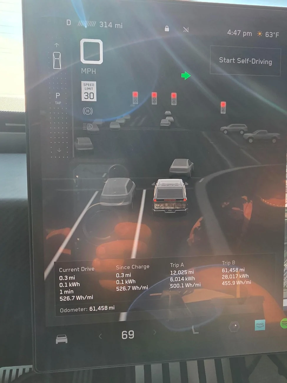

Can anyone beat 314 miles range showing with a little over 61,000 miles on the odometer.

somethings wrong with your estimator
as your average wh/m is 455. 123,000 watts divided by 455whm, is 270

That's how much he actually used to drive 61,000 miles. Like EPA MPG, actually mileage is affected by speed, load, wind, ect... 455 average is pretty darn good.

Yea mine is 411 it was 385 but I moved to Arkansas from FL. but that’s not what I ment, his estimators is showing 314 miles remaining at 100% charge. but his lifetime miles divided by his life time wh is showing a max range of 270. So something is wrong with his estimator by 44 miles roughly. His current drive sense charger is even worse.
just saying that estimate range should be a lot lower bc it does adapt or is supposed to adapt to your driving style.

I doubt the battery range estimator is based on how I drive. Maybe it's better because every day when I get home after work and I plug it in, I manually dial down the amps until it shows it will finish charging to my limit about an hour before I leave in the morning. So it usually charges at anywhere from 10 to 25 amps, and never sits after hitting 80 to 95% depending on whether it's cold out here in MN or not. That 455 average is also based on driving two winters and all last summer on those Duratracs too. I just switched back to the factory tires to try to get the summer out of them, maybe 7/32 left on those which I took off originally at 22k miles. By the way I put 40k on the Duratracs and they average 12/32 left on them.
