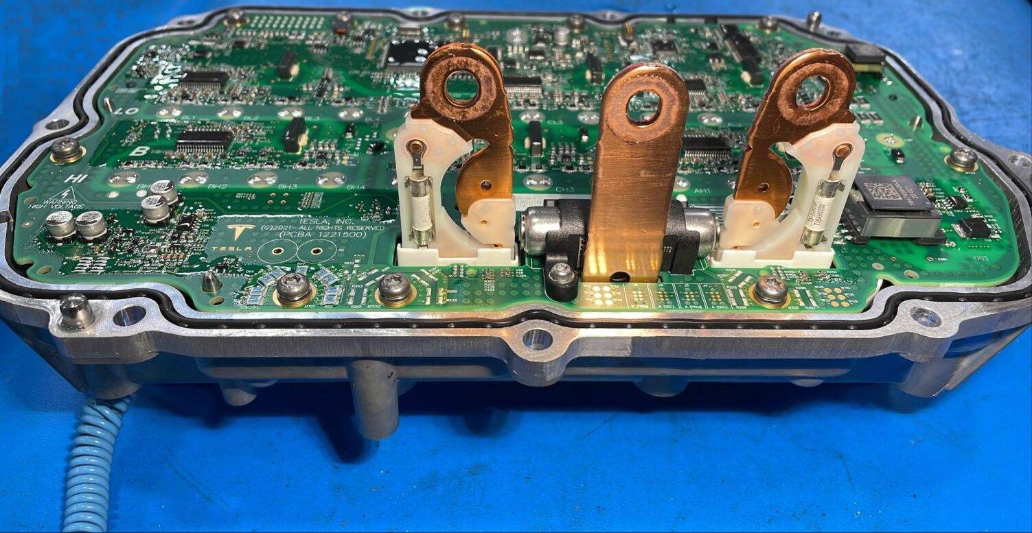

Recall DateRecall NumberDetails
November 5, 202424V832Description:
Tesla has issued a voluntary recall on certain Model Year (MY) 2024 Cybertruck vehicles produced within the build dates November 6, 2023 – July 30, 2024, that are or were equipped with metal-oxide-semiconductor field-effect transistors (MOSFET) in the drive inverter. On affected vehicles a fault in the drive inverter may cause it to stop producing torque.
Safety Risk:
If the inverter stops producing torque, the driver loses the ability to apply torque to the vehicle using the accelerator pedal resulting in a loss of propulsion, which may increase the risk of a collision. No warning occurs prior to the loss of propulsion. However, when the driver loses the ability to apply torque, they will immediately receive a visual alert on the user interface, with an instruction to safely pull over the vehicle to the side of the road and contact Tesla Roadside for assistance.
Remedy:
At no charge to the customer, Tesla will replace the recalled drive inverter with a drive inverter equipped with a properly functioning MOSFET component.
https://service.tesla.com/en-US/vin-recall-search
Tesla Cybertruck Recall: Drive Inverter Failures on 2024 Cybertrucks Produced 11/6/23 – 7/30/24 (Affects 2,431 vehicles) cybertruck drive inverter
Looks like some drive unit might also be replaced based on VIN. Attached is the Service Bulletin SB-24-40-009.
