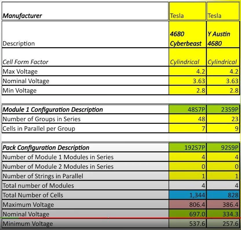

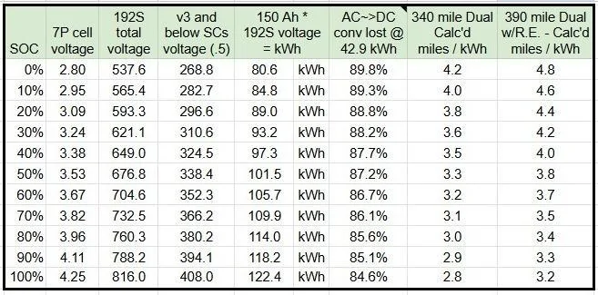

192S 7P = 1344 cells
192 * 4.25 volt = 816 volt
Quick playing around in a G-sheet
Tesla Cybertruck 4680 Structural Battery Pack explained - How does it work? 5raQwb0

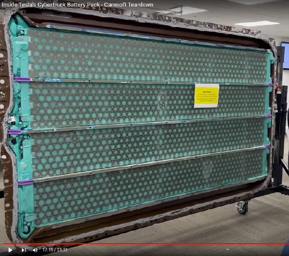

Via YT video below:
Tesla Cybertruck 4680 Structural Battery Pack explained - How does it work? L0rYSJD

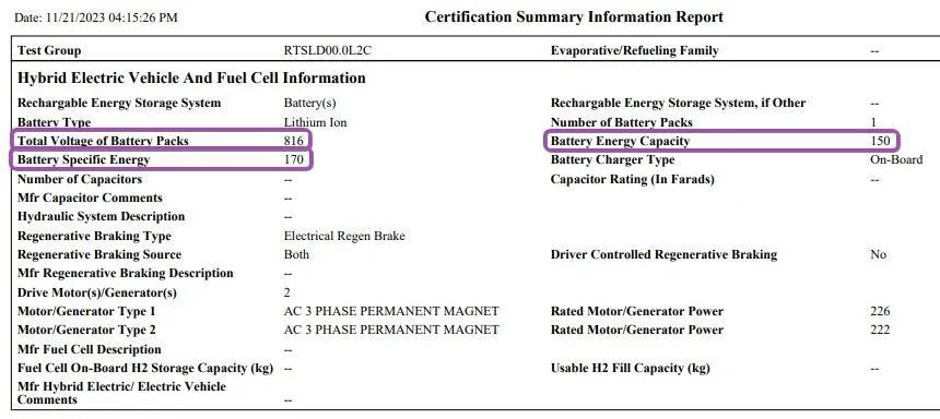

EPA website below confirms the Voltage architecture is 800 Volt. Also, we get more info that the Battery Energy capacity is 150 Ah and Specific Energy is 170 Wh/kg.
Tesla Cybertruck 4680 Structural Battery Pack explained - How does it work? kUZ0EY8

Interesting video. Watching tear downs on Teslas w the Munro boys is the best.
I’m honestly glad to know that Tesla is not likely going to add more range suddenly via more batteries in the pack w the space provided. Rather, Tesla did it to provide adequate protection to the pack for an off road vehicle, so impingement from outside forces such as rocks, stumps etc, isn’t likely to have you’re battery pack exploding while you high side a line your buddy told you looked good.
