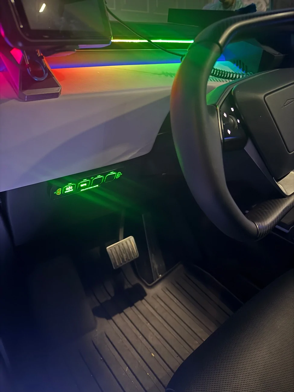

A power control module to toggle devices on/off via your phone's Bluetooth or wired Ethernet. Nilight has one as well as Trigger's 6 shooter
Got it. I use an auxbeam which is similar I think but hardwired.
