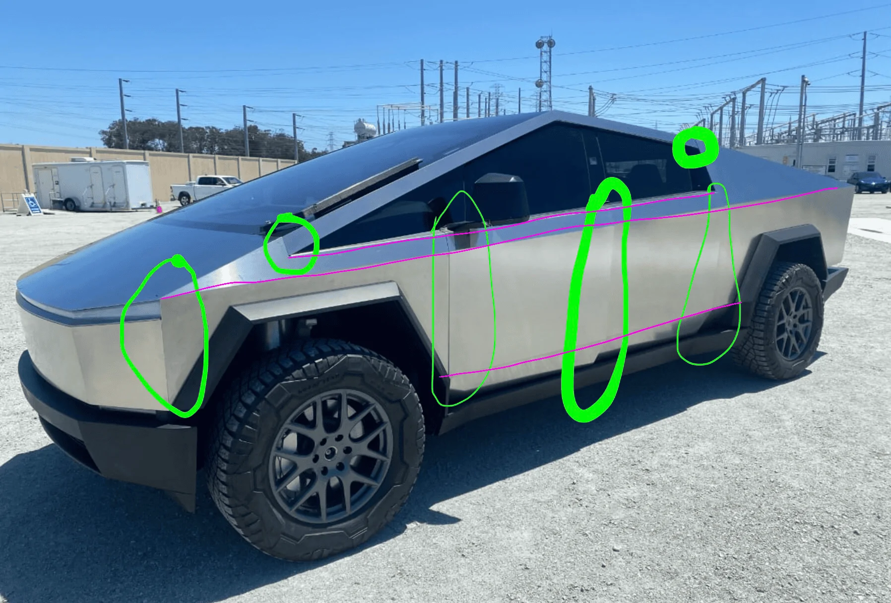

I know this has been vastly discussed, many still believe it is.
There are several seems around the body, where 2 separate pieces meet. See below
Tesla Cybertruck PSA: Cybertruck body shell exoskeleton is not one contiguous piece of bent steel Screen Shot 2022-11-21 at 2.19.44 PM
There's also the interior shell, the "exoskeleton" as it's been called. Same gaps on the official Tesla.com/cybertruck render, and you can see the interior stamped "exoskeleton".
Tesla Cybertruck PSA: Cybertruck body shell exoskeleton is not one contiguous piece of bent steel 1669065706128
Now, this post is not meant to being mean, call anyone crazy, pick fights, but really - give hope.
Tell appears to be "bending" 7(at least) body panels, excluding doors.
- front right fender
- front left fender
- front bumper
- center upper rail left
- center upper rail right
- rear quarter left
- rear corner right
Obviously 4 doors, frunk lid, tail gate too, but not relevant here.
This makes for 2 very good things
1. Steel is easy to bend for Tesla, they already do it
2. They won't have to figure out some insane new technique we all think they do(bending one piece of steel to make a body)
Tesla already knows how to use AIDA equipment, they've been utilizing their tooling for years already. Their machines are quite interesting, the molds drive them selves into the punching tool, it's nearly fully automated. This machine is there, and as of today - IT IS BEING SET UP(credit JoeTegtmeyer for image)
Tesla Cybertruck PSA: Cybertruck body shell exoskeleton is not one contiguous piece of bent steel 1669066066867
Assuming 3 weeks to build, Tesla will "start" punching Cybertruck body components before New Year. This is probably why they're hiring for BIW positioning NOW, since 9K IDRA Giga Press hasn't landed(I'm watching, I promise..)
This was my weekend meditated thinking. Just thought I'd share here and also show the image Joe got for us today in the Stamping 2 extension area, showing the AIDA machining being set up!
My own 2 cents, I wouldn't be shocking if there is indeed some trucks in Jan at this point, demo units for cold testing and such.
- front left fender
- front bumper
- rear quarter left
- rear corner right

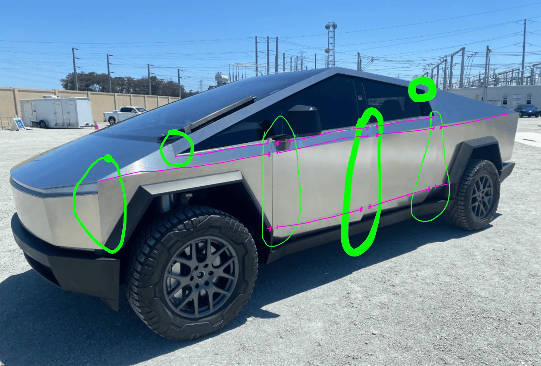

Not just the grain, color matching, but the number of steps too. If they only have to do the 3 folds on the brake once, versus 10-11 folds if you were to do each panel separately. That’s 6 folds total versus 20-22 folds. Looking at that big ass brake, I’m betting it’s for making a few big bends rather than lots of little bends.
Forgive the terrible illustration.
Tesla Cybertruck PSA: Cybertruck body shell exoskeleton is not one contiguous piece of bent steel 1669076748180
Tesla Cybertruck PSA: Cybertruck body shell exoskeleton is not one contiguous piece of bent steel 1669076864334
PS: at another angle you can see the front panel extends the same height as the doors So you do need that tiny little fold in the front bottom.
PPS: Just tossing a theory… other factors might make this impractical.

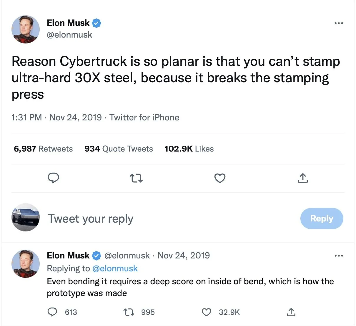

Since they are tooling now, whatever way they are going to make the exoskeleton it is already decided/solved and our guesses and logic are just that.
Yea, considering Elon said in 2019 after intro of the truck that stamping this thick rigid steel actually would BREAK stamping presses, I wonder what they'll do.
They were scoring then bending the steel on the prototypes he also said.
Your proposition basically calls him out, or did I misread it? Given the size of the doors it is not practical to have even one left and one right side, even though that is the best way to get the strength. Maybe they could bend in 2-4 sections and fasten them as I earlier surmised; I do not claim to know. For certain the hood, door outer pieces, and tailgate will be separate pieces. If Tesla were to make a Lightning-style drunk that would change things a bit there. And then there are the cross pieces. The inner sections could be stamped aluminum. I really look forward to a tour of the factory when I go to pick mine up.
