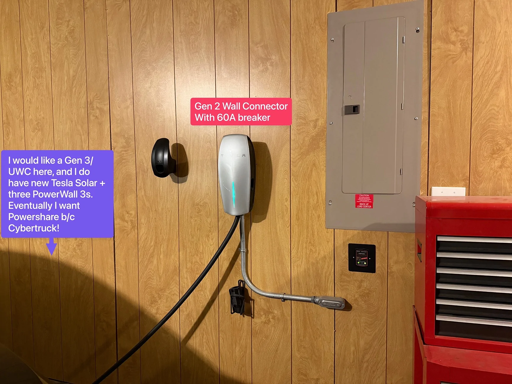

This looks like the perfect thread for my question :)
  • In 2020, I got this Gen 2 Wall Connector installed (new panel, too) with a 60A breaker. Has worked perfectly!
  • In 2025, I got Tesla Solar + three Powerwall 3s.
  • In 2026, I got a Cybertruck, and will be ordering a UWC soon.
  • I have 4 EVs, and the current Gen 2 Wall Connector cord is just a bit too short for comfort.
Questions:
  1. Can I add a Gen 3/UWC "down stream" from the Gen 2? I suppose the electrician could wire them up in whatever sequence, just using conduit.
  2. Can the UWC load balance with the Gen 2?
  3. How will (eventual) PowerShare from my Cybertruck work properly with all this?
  4. Should I just give up and rip out the Gen 2 and use a single Gen 3/UWC?

Thanks for confirming what I was suspecting.
Although I have an empty slot for an additional 60A breaker, I've seen my total grid power draw hit 36.7 kW (153A) and my panel only supports 200A. This is when I have a Tesla charging, the Powerwalls charging, and a heavy load from the house. So, I don't have the headroom to add another wall charger on its own breaker.
Thoughts on getting two UWCs.. put one in the spot where the Gen 2 is today, and add a master/slave to the right in the picture? That would give me the extra cable length I need, and some flexibility to charge a vehicle parked slightly farther away.
