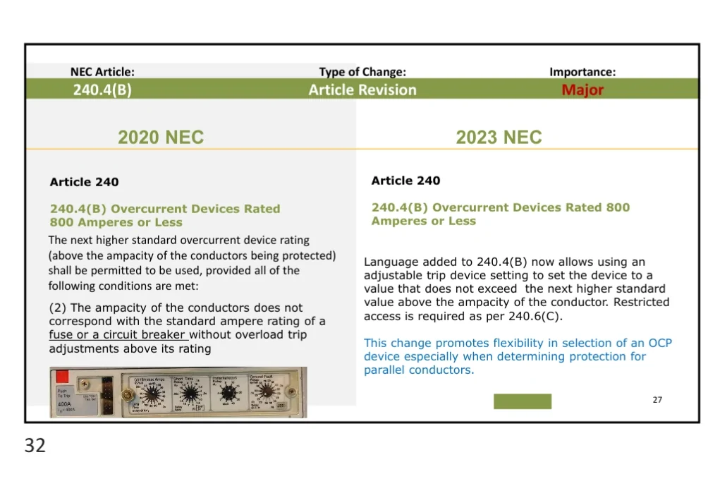

You just left out the entire last line of the 2023 NEC, but that's ok, you do you bro. I'll stick with what's approved in Florida, and avoid the unnecessary risk of fire, which won't be covered by insurance here if it did happen.
AFAICT, the only change to that section in 2023 was clarification that when using adjustable breakers, you can set it to the next higher level if the ampacity doesn't match a standard value. Does the Florida Electrical Code have something additional ?
From https://www.electricalassociation.com/common/Uploaded files/PowerPoints/PowerPoint 2023 NEC Code Update Part 2.pdf
Yes, that was the line I was referring to. Other than that, I only know what I was told by my installer, that it wouldn't pass inspection here in florida. So I read up on it to better understand the issue.

Yeah, I think there are two separate issues.
Under NEC:
One can put a 60A breaker on #6 NM-B
One cannot recalculate the load capacity based on the upsized breaker.
So
One cannot run a 48A charger off of #6 NM-B
But
One can put a 60A breaker on #6 and have a Wall Connector set to 40A charging, which is 50A calculated, which is lower than the 55A rating. Not that the extra 10A of breaker has any benefits.
My point was that the breaker size is not illegal so as to avoid people getting in conflict with installers.
There are ampacity adjustments for the environment (and multiple current carrying conductors in a raceway). Hot attic vs conditioned space, but I think NM-B starts at the 90C value, and gets derated from there. Ideally, the house construction (vented on insulated attic) makes it a non-factor.
