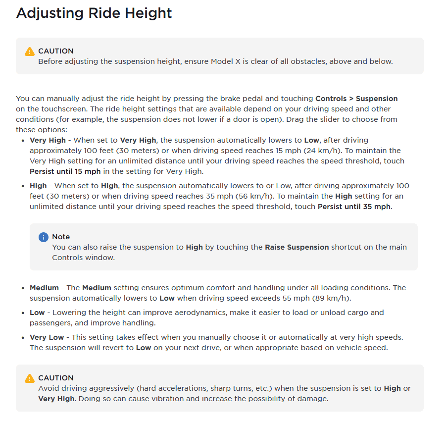

I have a '16 Model X that has gone through a few half shaft warranty replacements and 3 sets of summer and 2 sets of winter tires. When I first purchased it, I drove at normal height with the automatic lowering set for highways speeds. The OEM tires didn't last a year with excessive wear on the insides tread of the rear tires. The camber difference from normal to low was enough to cause pretty bad tire wear (down to the belt before I realized it). As mentioned, I've had the half shafts replaced twice. The last time, Tesla suggested setting the suspension height to low all the time as it's probably the height that induces the least amount of angle between the motor and wheels. In the Model X, setting the suspension to High and Very High will automatically lower to Low after 100 ft. Setting to Medium and Low will remain in that position unless automatic lowering is enabled. Setting to Very Low will raise back to Low after driving is completed. I believe the Model X has about 2.7" of overall travel from Very Low to Very High. Newer vehicles have active dampening.

I guess the Model X does have speed limits as well as a speed over-ride, but I haven't messed with it since I don't want to have to replace my out of warranty half shafts again.
Tesla Cybertruck Adjustable ride height ramifications (tires and half shaft wear) 1701194700694
I'm guessing the Cybertruck will operate similarly, as you described. Thing about the Model X/S suspension is that there was little camber adjustment in the rear until it started to affect toe, so there were some aftermarket camber arms made. I think this fixed on the Raven update, but like you said, people will have to determine what they'll mostly drive in, and adjust camber accordingly. I'm not sure if people are aware of this since adjustable height suspensions aren't super common.
