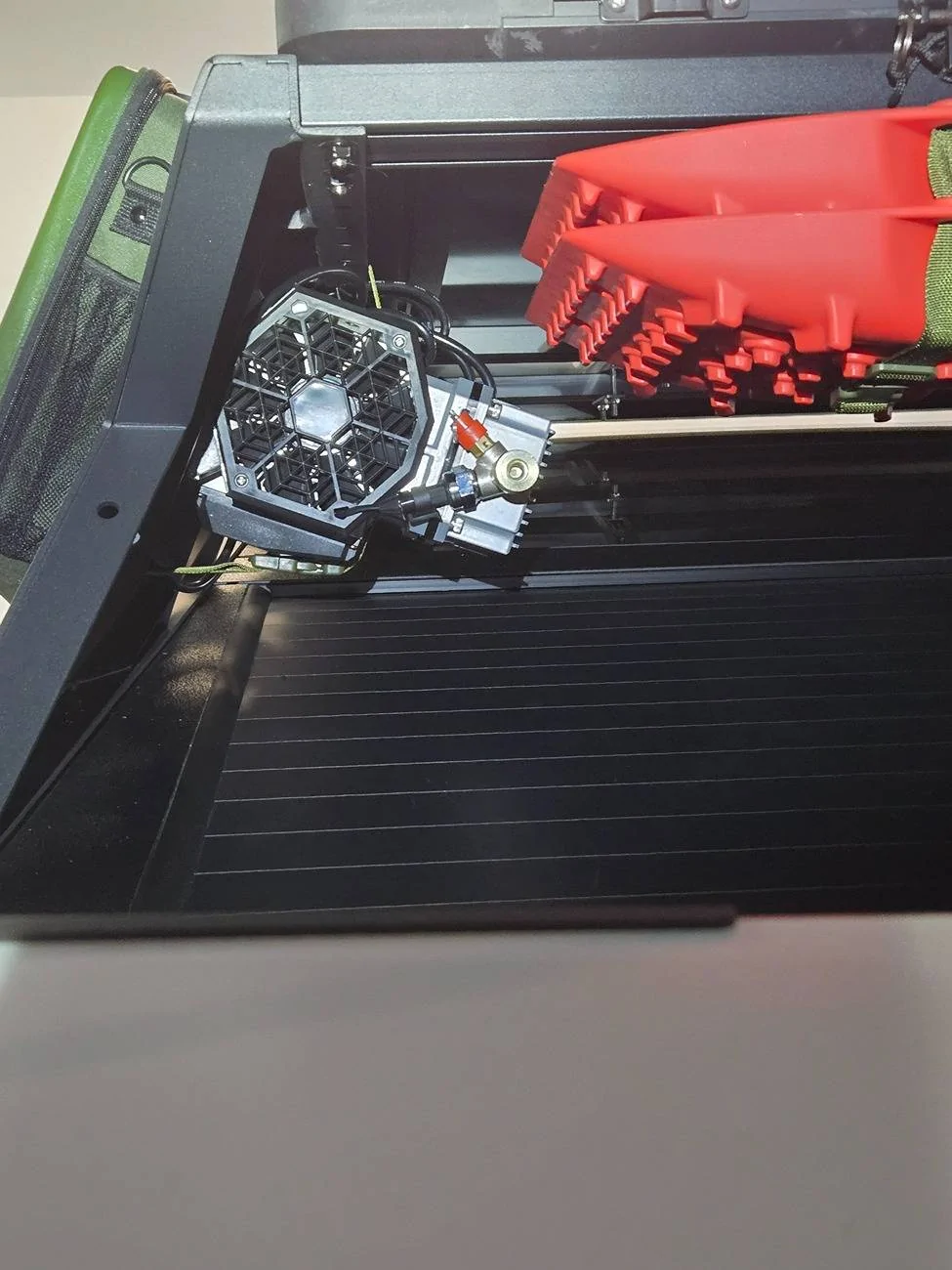

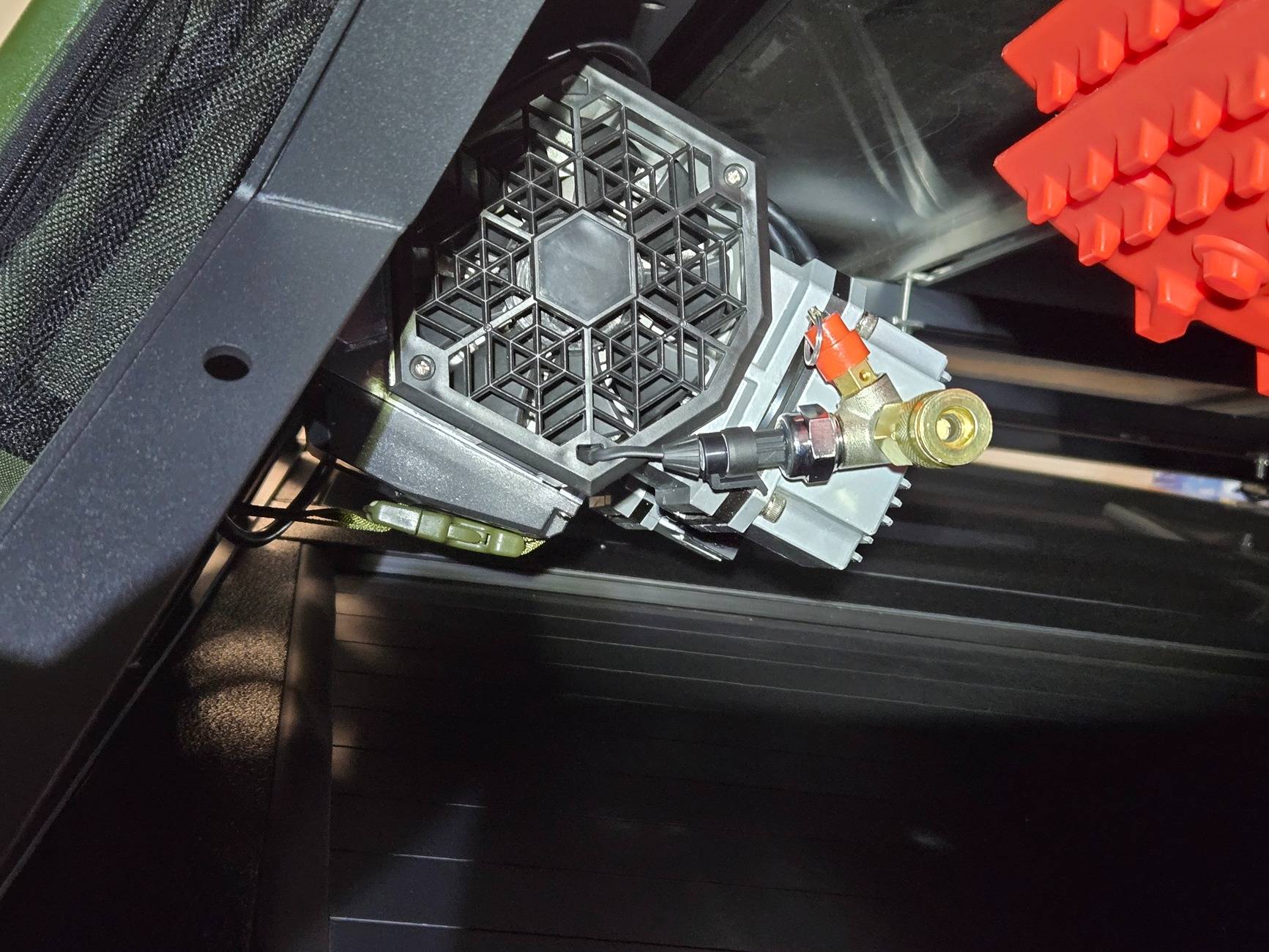

Same setup as OP, but I mounted mine. Running the Rhino USA 4-wheel tire inflation/deflation system—works great. I just cover it with a waterproof bag when not in use.
Tesla Cybertruck Air compressor setup 20250428_210235
Tesla Cybertruck Air compressor setup 20250428_210315
