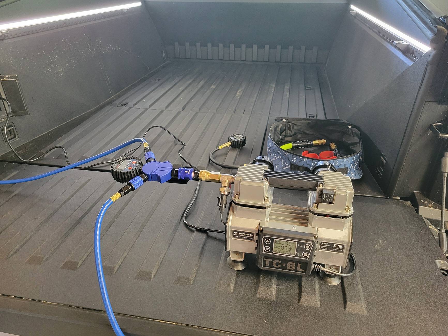

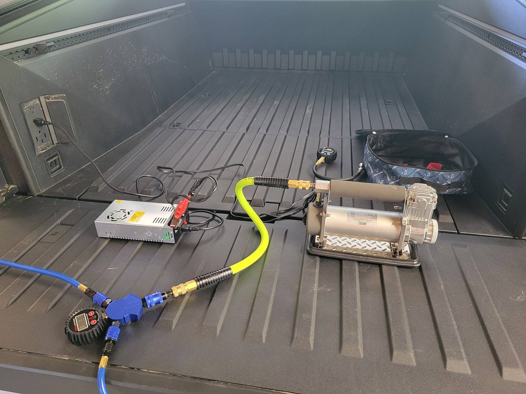

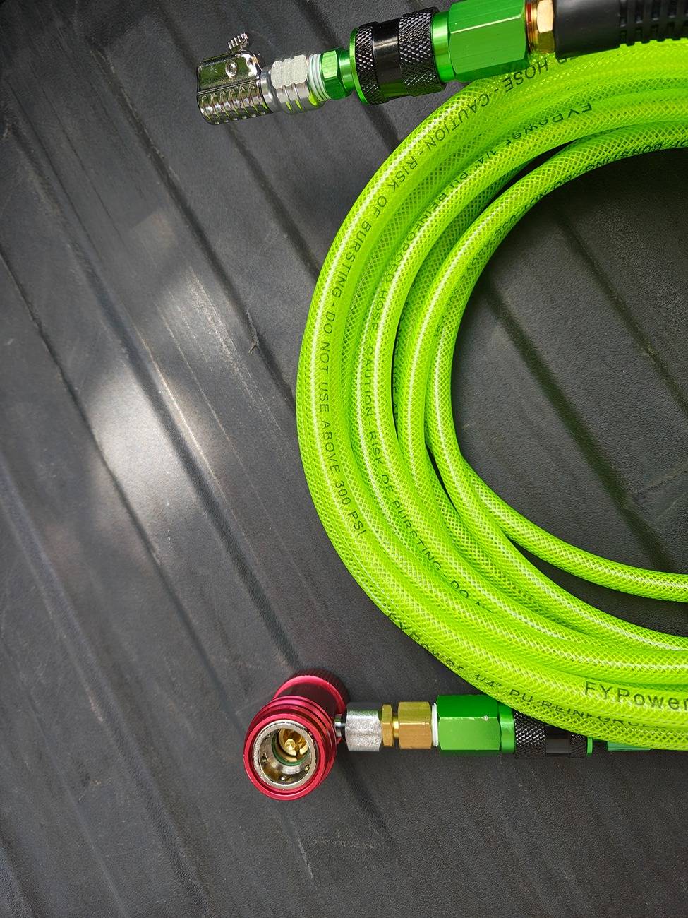

Here's my original thought process on airing up. I have a Thor's Lightning manifold for airing up and down. I have a beloved 12V Viar 450P compressor. I bought a Eagwell AC to 12V DC converter which supplies 50 amps. I stuff it into a small bag along with an assortment of things like a lighter socket, ect. It's a keeper, even if I don't go with plan A as above. Plan A worked, but as you'll see, MUCH slower than the TC•BL.
Here's my test: I deflated all 4 OEM Pirelli tires from 50psi to 35psi... 1 minute 30 seconds with my manifold.
Setup A using the Viar 450P and 12V converter took 12 minutes 45 seconds from 35 to 50psi for all 4.
Setup B using the TC•BL took 4 minutes flat from 35 to 50psi for all 4.

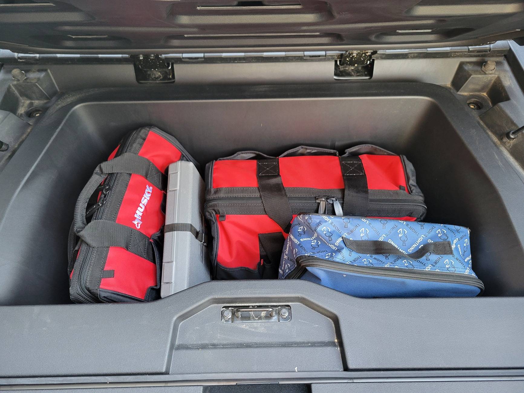

I bought a 15 inch tool bag from Home Depot for the TC•BL. Got that, a tire plug kit, Thor's Lightning manifold, and an 18 inch tool bag for random tools and recovery items stored away in the smugglers bay.

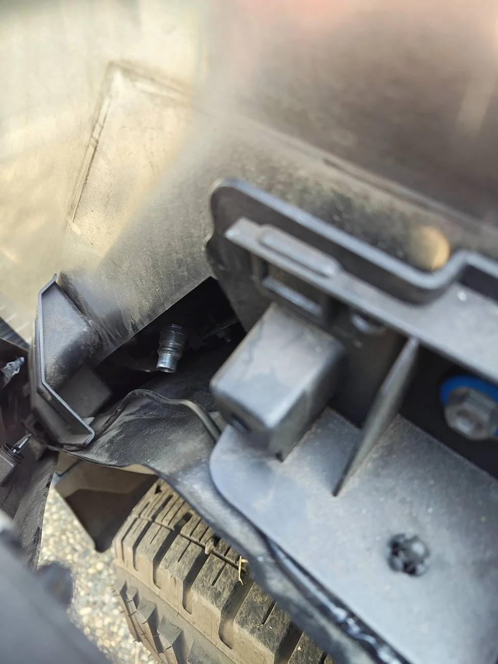

its behind the right rear fender (easily removable) it is not a standard chuck and needs a special fitting that uses a pin. I believe its an air conditioner fitting.
Does anyone here actually use this air compressor connection behind the fender for tire inflation?
Curious what your experiences have been.

I wouldn't use it. I have to assume that connection is for servicing the air suspension in some way. If it was intended to be used as a air connection for owners it would not be hidden behind the fender trim. Yes it will provide air but the compressor for the air suspension is not designed to inflate tires.
