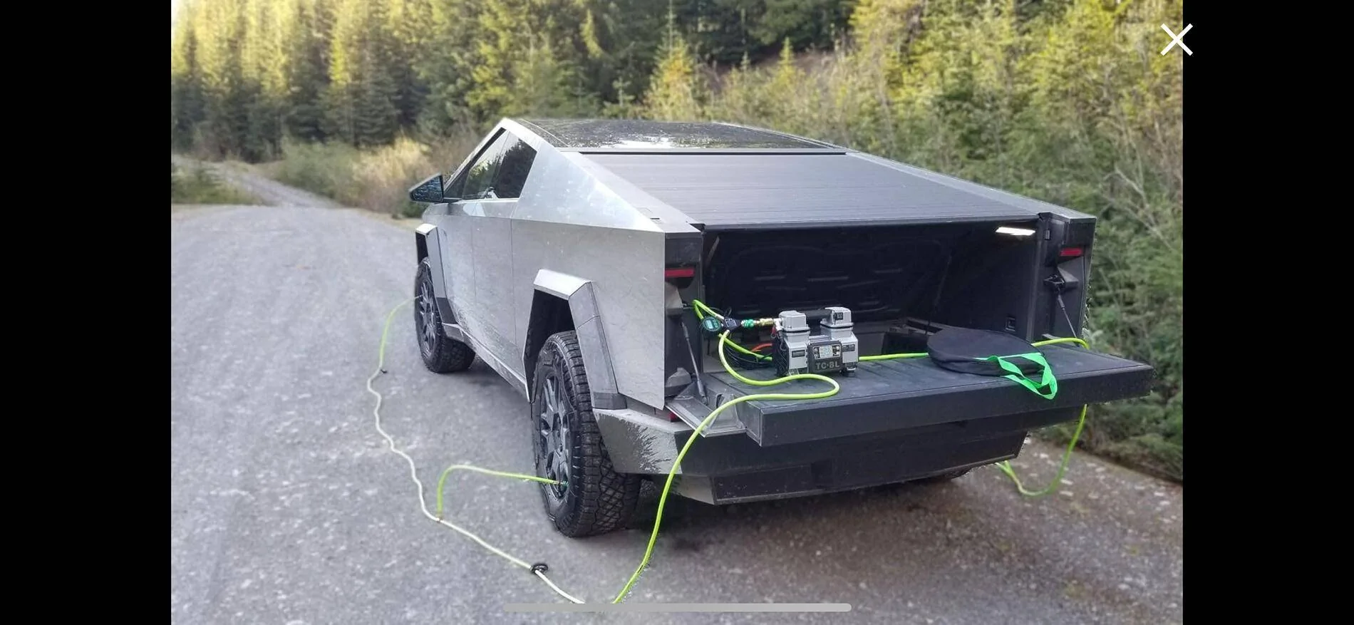

I wanted an alternative to the Tesla tire repair kit without the sealant (“tire goop”). Finding a 120 VAC portable compressor proved difficult, so I focused on 12 VDC automotive options. After some research, I chose the Viair 300P because of its positive reviews and reputation for quality.
Current Draw and Power Supply
  • Measured Current Draw: The Viair 300P pulls about 2.2 amps at steady state.
  • Power Supply Attempt #1: An 8-amp DC power supply didn’t work because the compressor’s locked rotor amperage (LRA) likely exceeds 8 amps. It actually short cycled.
  • Power Supply Attempt #2: A 30-amp unit (found on Amazon resale) worked perfectly.
Enclosure and Setup
I like the idea of a battery or kayak box with lights and power outlets, but I wanted everything—power supply included—to fit in the Viair 300P’s storage bag. The power outlet box gives the added benefit of a USB charger while tailgating. I caught the 300P on sale for $150 and found the 30-amp power supply on Amazon resale for $34.
PVC Conduit Box:
  • Perfect for the socket connectors once you notch them.
  • Using a heat gun softens the PVC enough to mount USB and cigarette lighter sockets into the conduit connector posts.
  • The posts help accommodate the length of the sockets.
  • I mounted the switch is on the cover (it requires minimal depth).
  • Cut the hole slightly small so you can screw it in.
  • I wired the switch only to the lights.
Viair 300P Set-up:
  • You will need to cut and splice an SAE connector to the end of the Viar cord.
  • Reuse the alligator clips to splice back onto a male SAE connector so you can use this with any other vehicles battery posts.
  • Pay attention to polarity with these type connectors.
Overall, the project was straightforward, and everything fits neatly into the Viair 300P bag. The final setup cost me around $256 and provides a portable, sealant-free air solution for the Tesla Cybertruck (or any vehicle you choose since it DC). The live links as of this writing cost about $289.
I’m sure there could be some improvements to this.
Can’t you just plug a 12v compressor into that power supply without all of that work?

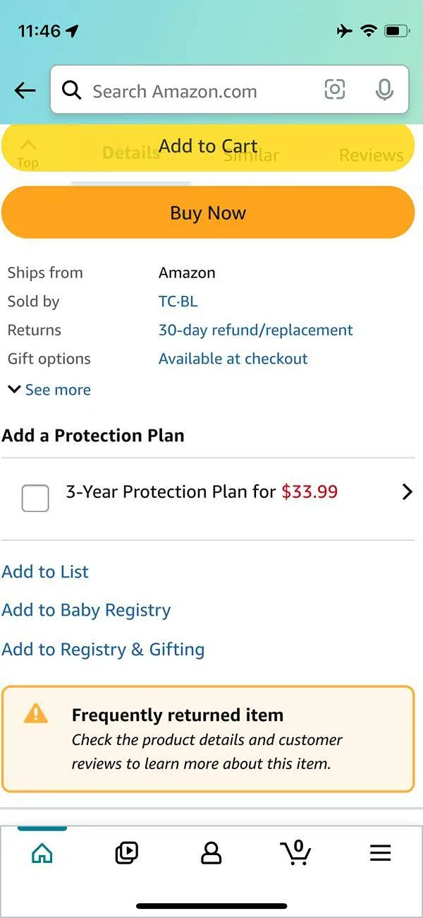

Buyer beware, “frequently returned item”:

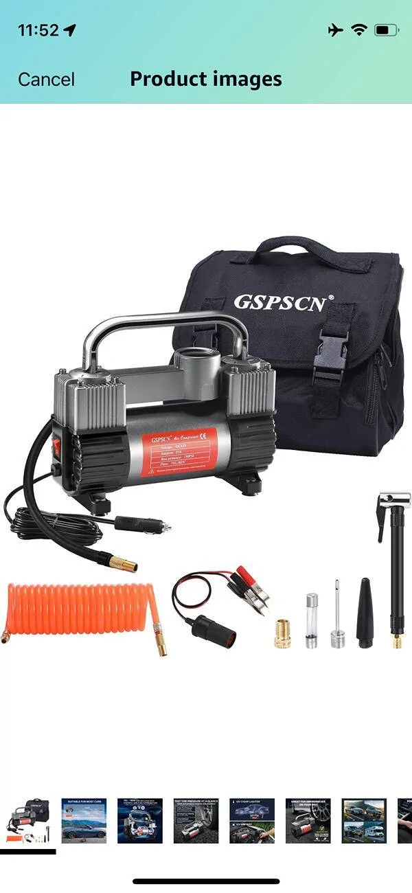

I bought the below GSPSCN one which does fit in the smuggler’s bay. It’s good up until about 50-55 psi, but then struggles hard to reach +60 psi. Maybe it’s my fault for over inflating my tires but I put on a lot of highway miles. Also the little compressor is so noisy that I have to wear earplugs while using it. It’s only $50 though, so definite an excellent value for the money.
That's a 12V DC compressor. 65 psi is the correct inflation pressure for the OEM AT tires for towing so any compressor that struggles at higher pressures gets a "no-go" from me.
For the Cybertruck, I would also reject any compressor that can only run on 12V.
Those who want a really cheap, relatively lightweight 120V solution for re-inflating a tire after plugging, WalMart carries one (runs on 12V too). This is a really cheap unit (both in price and build quality) but it looks like a reasonable solution for those wanting something in this price range (for emergencies only, not for airing all four tires back up after deflating to lower pressures).
Hyper Tough Dual Power Digital Inflator for P195/65R15 Car Tire, Car-DC 12V or Home-AC 120V - Walmart.com
The only reason to buy this one, instead of a more substantial unit, is that it's quite lightweight and costs very little.

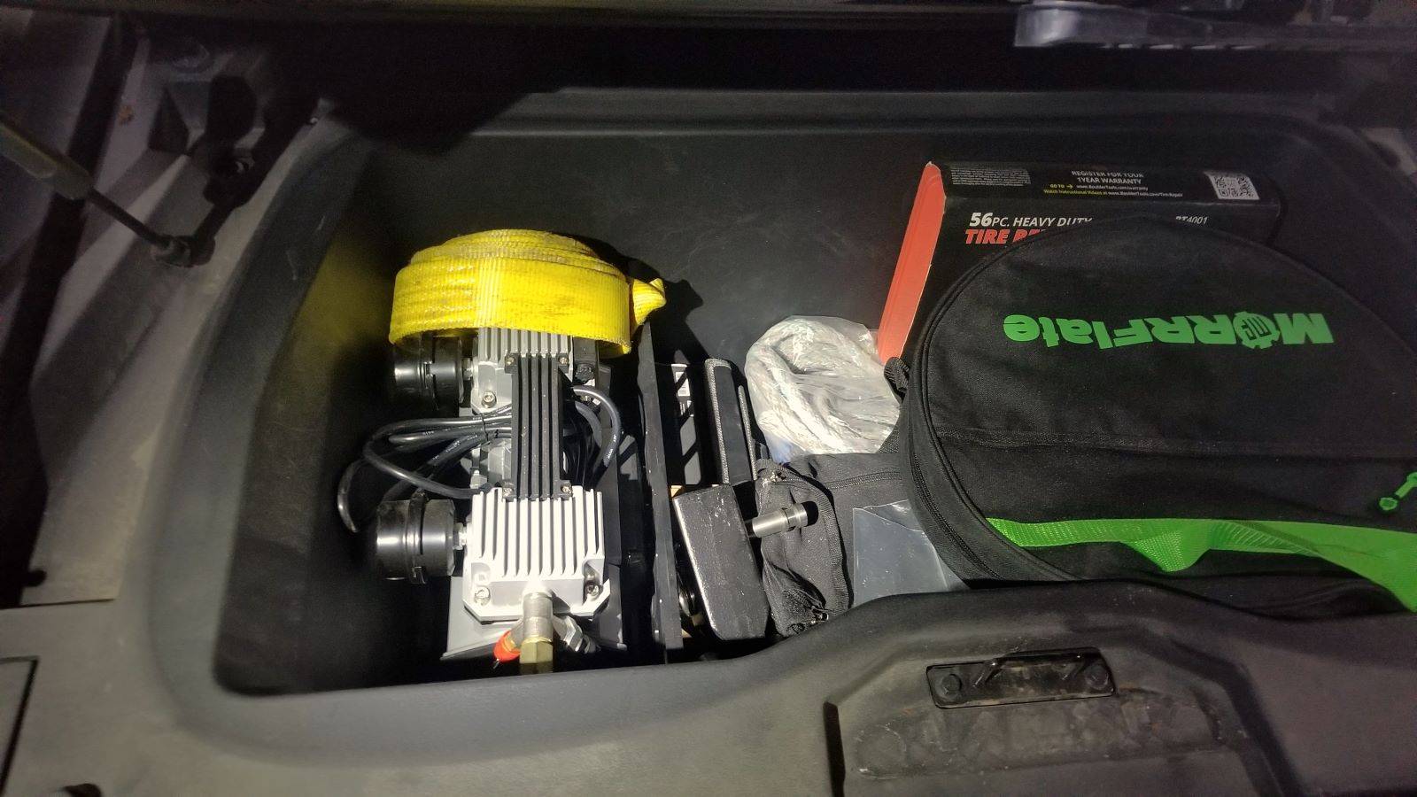

Do you perhaps have a pic of it in the smugglers bay?
Tesla Cybertruck Air Compressor Viair 300P & Tire Repair Kit Assembled 20240721_221324adsm
This is the TC-BL 120V compressor in the left compartment of the smuggler's bay. That is a spare tow-strap over the rear cylinder. The rubber feet of the compressor are on the floor of the smugglers bay and there is room for the MorrFlate 4-way hoses seen on the right side to be slid all the way left, on top of the TC-BL compressor. The hatch will still close normally.

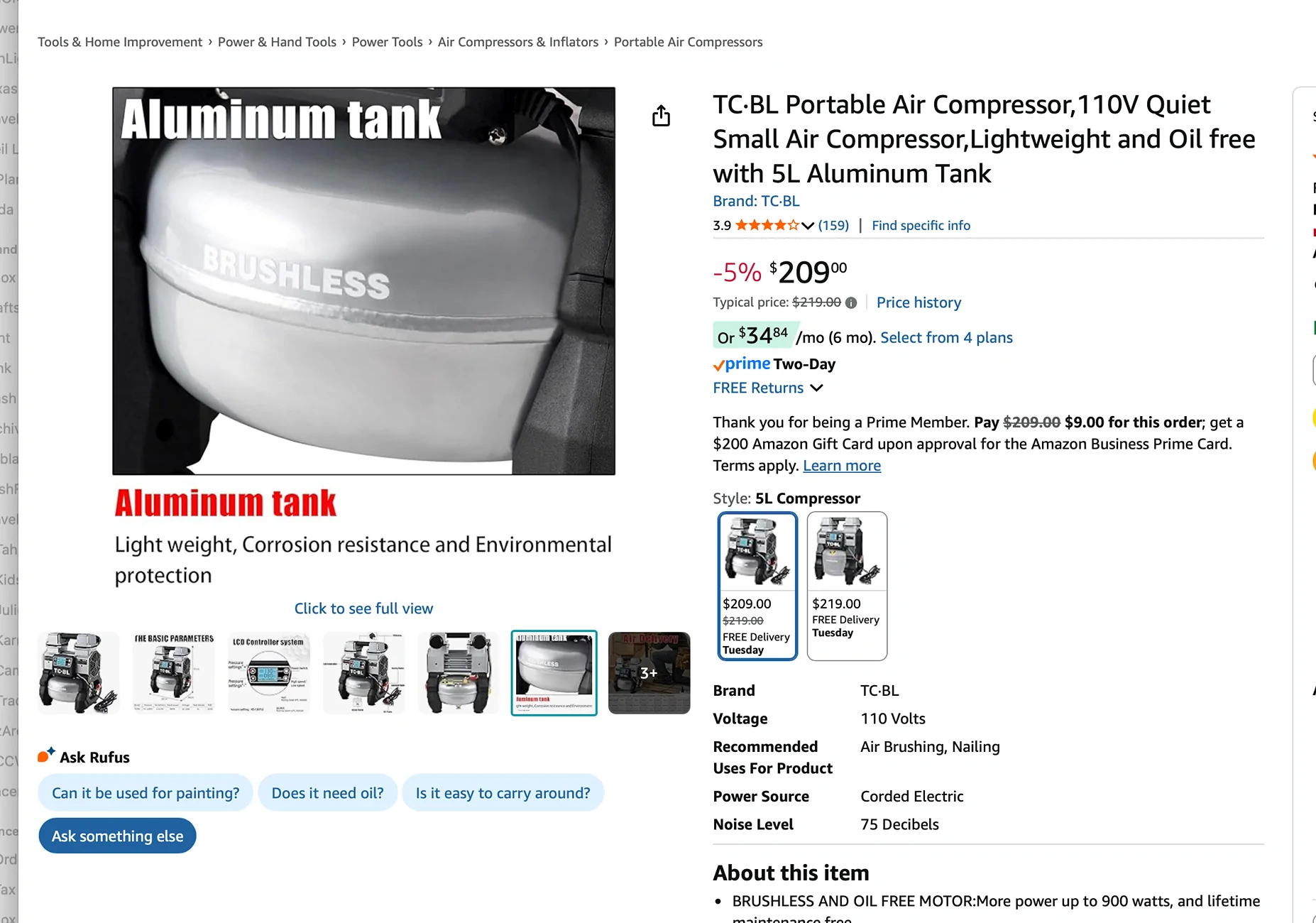

So, it seems like the compressor you reference is no longer available on Amazon. All they have is a version with a 5L tank -- weighs more and I doubt will sit in the smuggler's Bay. anybody else found a better 120V solution? I just got my CT recently so hadn't looked into this yet but I love your set up HaulingAss -- I just can't seem to find that exact compressor any more.
A friend of mine carries one of those Stealth compressors, but they seem larger and heavier than needed....
