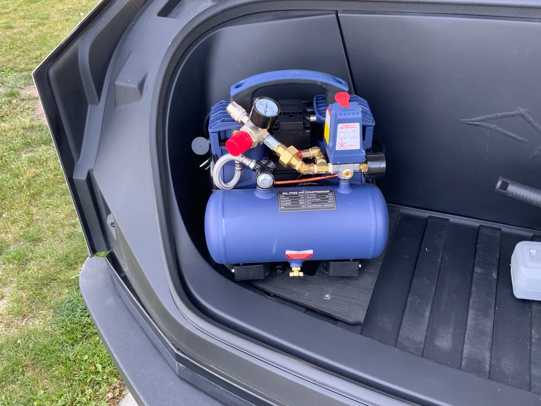

I plan on using the frunk for off-road recovery gear, including semi-permanently mounted compressor. The fitted aluminum plate mounts to the L-track to secure. Remounted the compressor/suction cup feet to between the plate and frunk floor to eliminate wobbles

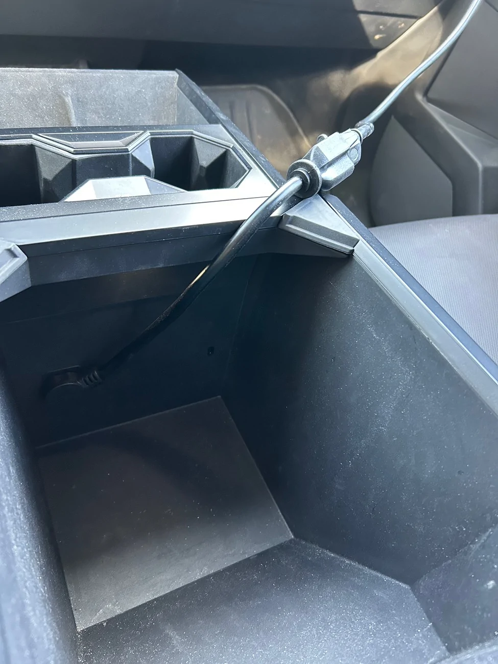

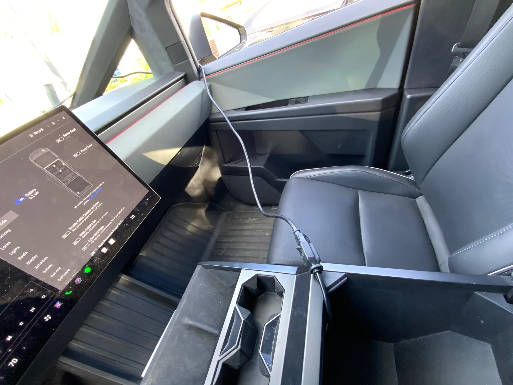

Replaced the compressor power cord with 9’ and a flat / right angle power patch cord adapter.
Tesla Cybertruck Air compressor setup 1777082281637-2x
Was pleased with the right angle adapter. Just enough slack to make the power from inside work.

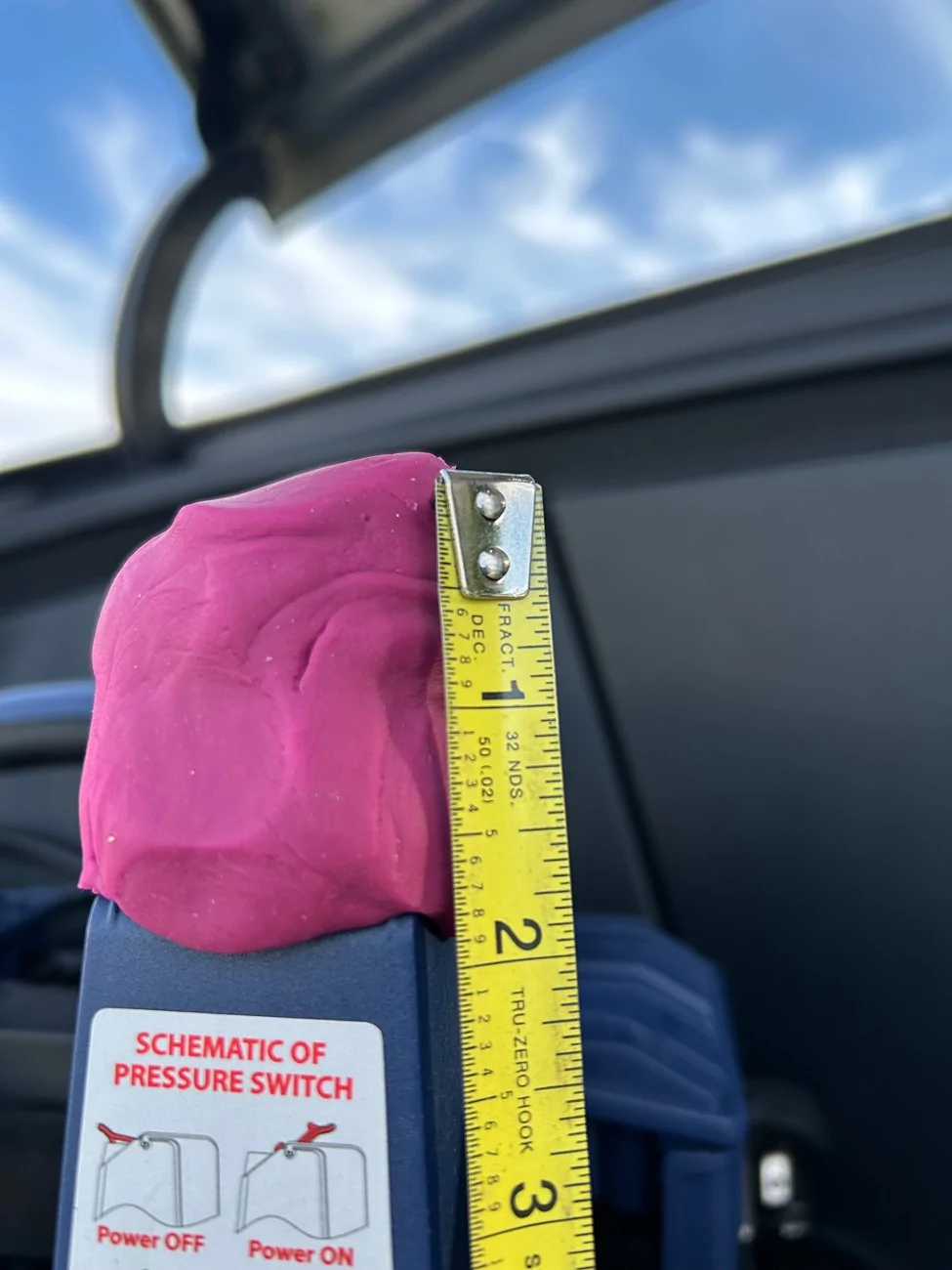

The playdoh tower shows clearance to the lid.
Tesla Cybertruck Air compressor setup 1777083132164-yf
About 1.5ā€ / 40mm Clearance

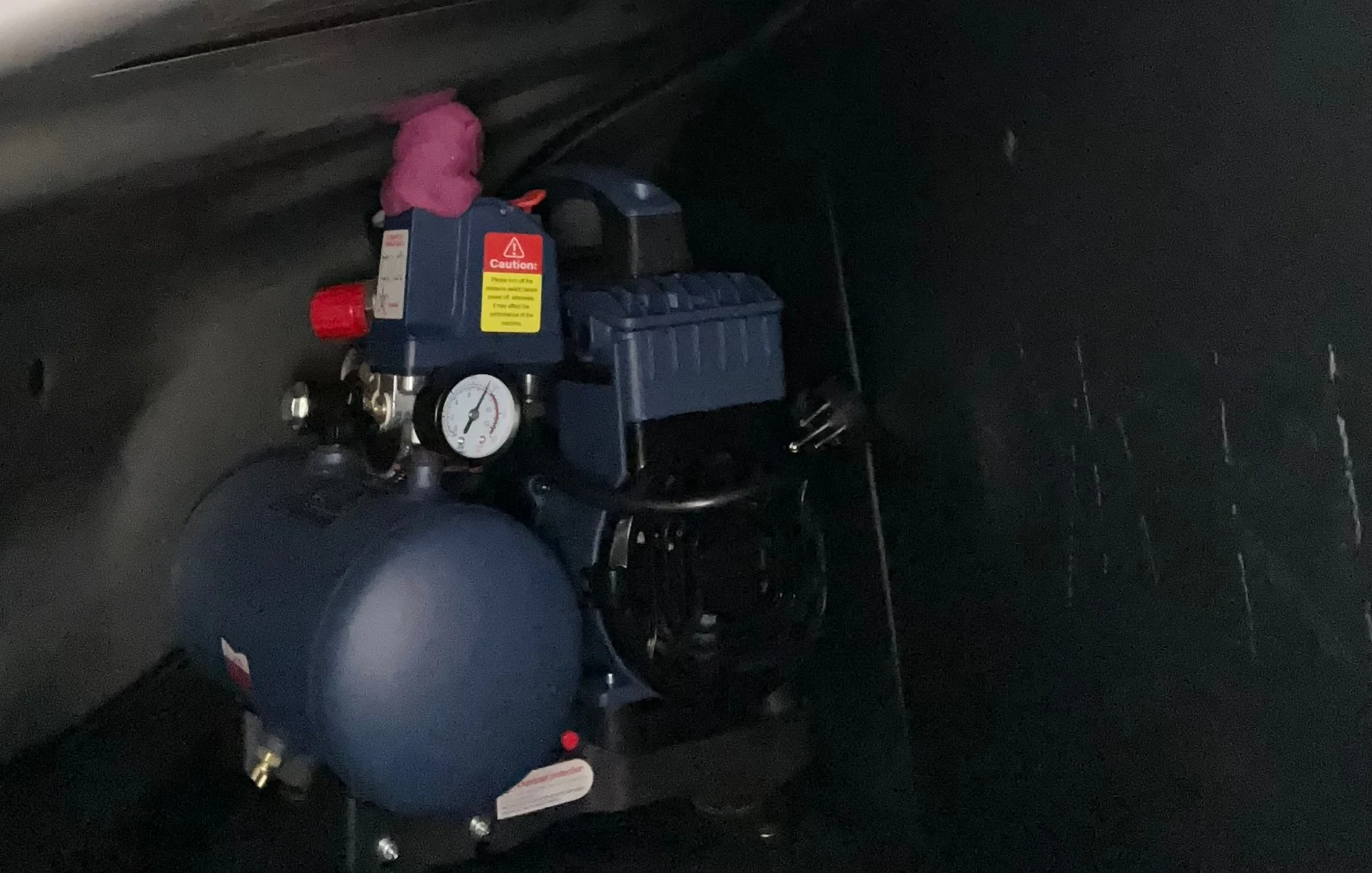

Impressed with those little dual piston compressors, they are game changers: Compact, efficient, and this one is pretty quiet.
You forgot to mention what brand/model that air compressor is. Is it available without the air tank?
