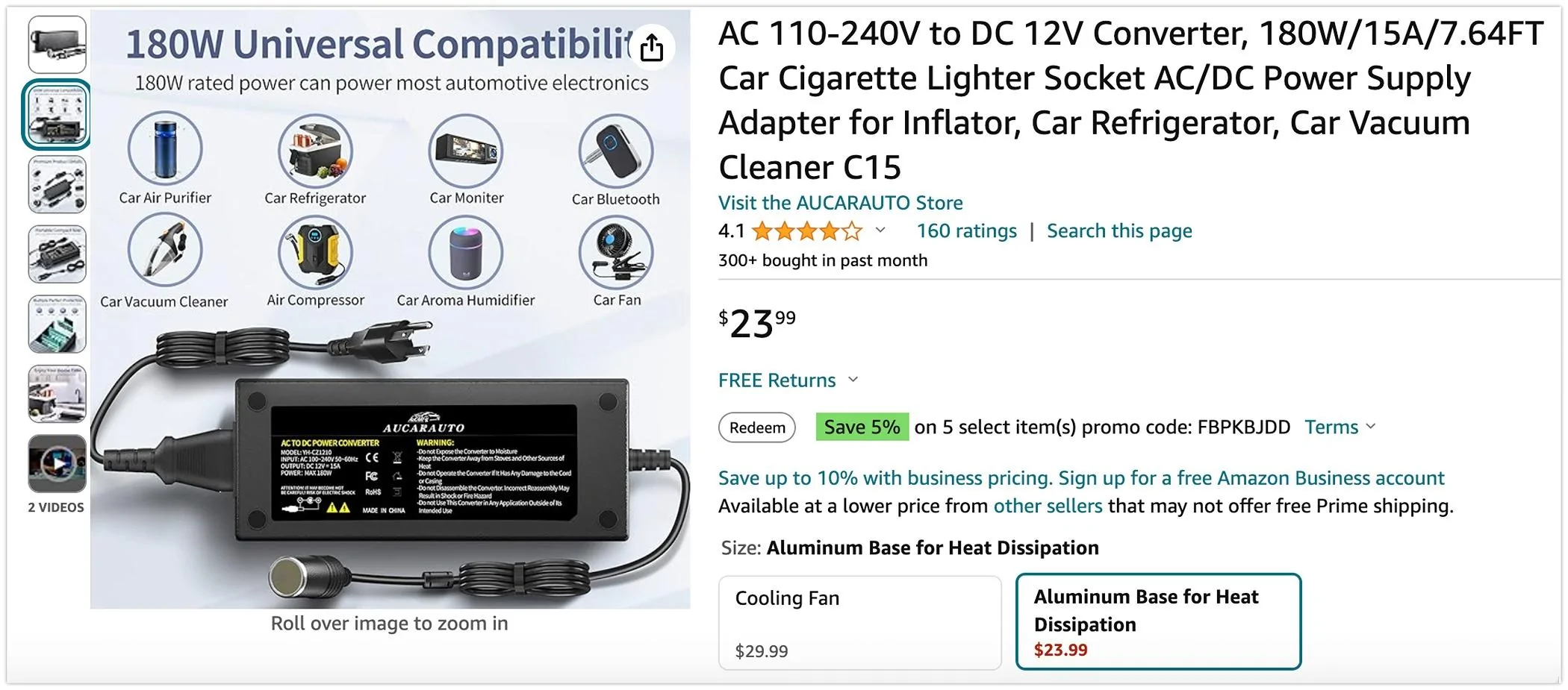

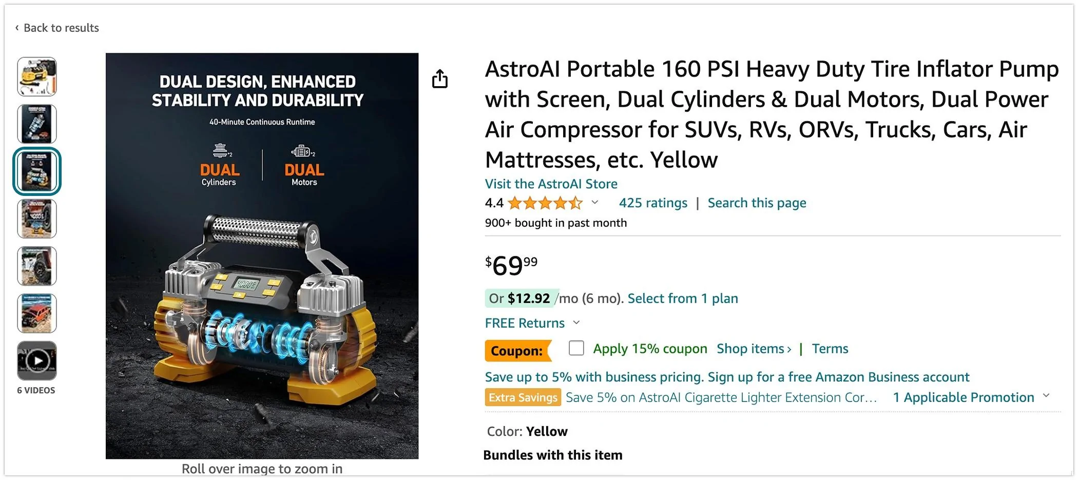

Or, already had a air compressor for my other tesla, just had to get an converter to use with the Cybertruck.
