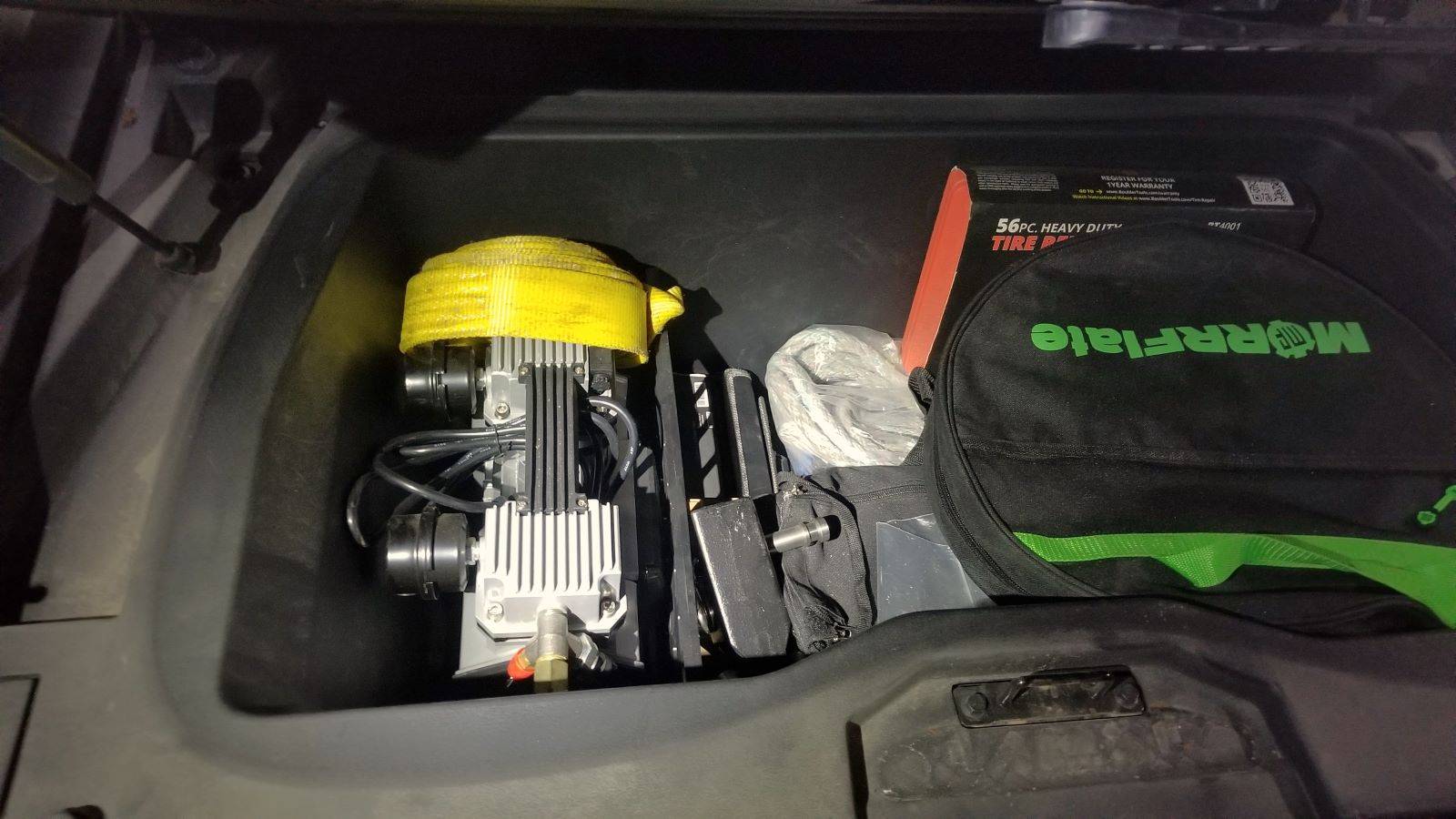

Any chance you have a picture of this in your smugglers trunk? I've been looking for a couple weeks for the right quality high powered compressor to throw in the truck, but I also have my mobile connector, extension cord, and various tie downs in that spot right now so curious for how much room it takes up. I'm a visual learner!
Yep, it only takes up one of the smallest of the three compartments in the smuggler's bay (with room on top for hoses).
Tesla Cybertruck Looking for air compressor ideas 20240721_221324adsm
That's a yellow tow strap draped over one of the cylinders and that black thing just right of the compressor is one of the smuggler's bay dividers that came with the Foundation Cybertrucks. It fits perfectly in there, like it was made for it, with no squeezing, binding or rattling about.
I can slide the MorrFlate inflation hose that you see on the right over the compressor and the hatch still closes normally.
Tesla Cybertruck Looking for air compressor ideas 20240709_194210adsm

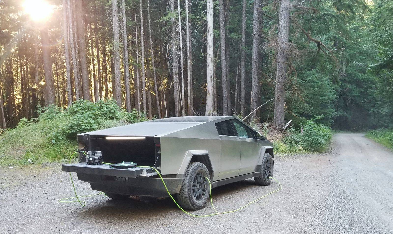

Here it is in action, inflating all four tires simultaneously from 35-50 psi in only 4 minutes. The DeWalt 20V inflator would take an hour or more.

Like I indicated, it only takes up one of the smallest of the three compartments in the smuggler's bay (with room on top for hoses).
I like that air hose. It looks really flexible so you have four different hoses coming from one outlet, correct?
The air chucks are self holding? They all fit in that bag! Love it.
I love it too! Yes, the reason it works so well is it connects all four tires together, so you can fill four times as fast. The chucks are closed unless locked onto a valve stem so you can use the same hose to fill just one tire. When used with four tires at one time, you are guaranteed they are all filled to the same pressure. I run the same pressure all around, but if you had a reason to have a pressure differential between the front and rear, it can easily accomodate that simply by taking two of them off first, and continuing with the remaining two.
The chucks are the best part of the MorrFlate hose, really nice brass air chucks that lock on or off instantly, with basically zero air loss. Get the one with the digital pressure guage mounted to the main manifold, it makes everything easier.
It's also awesome for deflating all four tires at once. If you've never done this on four 35" tires, you might not realize how long it takes! I haven't timed it using the MorrFlate hose, but I think it only takes about two minutes to drop 15 psi. (which is a LOT faster than manually deflating each tire, even if you have a helper on the other side of the truck). It makes quite the "whooshing" sound too.
Would you mind posting links to your exact set up? (got the one for the compressor). I’d like to replicate the compressor and hoses and any other bits and bobs needed for this system. Also, is there something you use to easily deflate all four tires? Thanks in advance ?
Wow! I think I'm sold. Seems like the perfect set up. Will have to get that compressor and probably pick up one of those dividers as well!
I demand this now be called "the Smugglers Bay" now! ?
I may have to have a sticker made now for the inside when its opened!
Nice setup!
