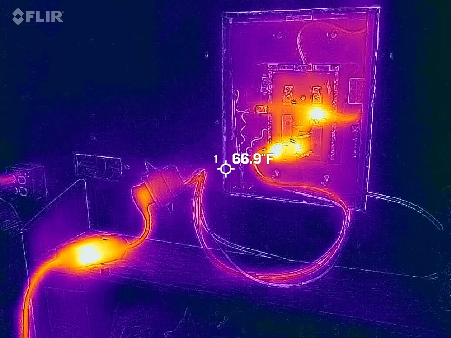

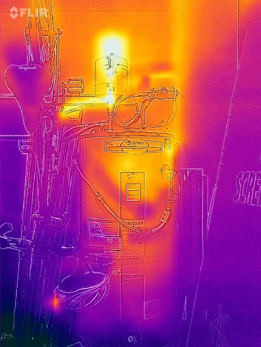

It's paranoia on my part, but I occasionally point a thermal camera at the high amperage wiring things in my house and look for hotspots. Breaker panel, too. I feel less paranoid now....
