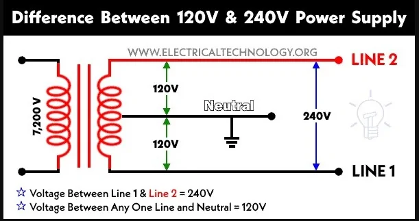

I charged my Tesla on a family members NEMA 14-50 a while back and multi-meter tested it before I used it. The neutral wasn't connected even but ground was. Vehicle charged fine. AFAIK, the neutral in a 240v connection like for appliances are for when they have some elements using 240v (hot & hot) and others in that appliance using 120v (hot & neutral) .
Interestingly this product has an EV charging mode that binds the neutral+ground.
Seems like you've got it figured out, but like @Woodrick said, this is NOT true for the case of powering your house from anything acting as a generator; your house 100% needs the neutral to be present.

Providing some lessons learned from folks that have done this with their Lightning and the powerboost before it (assuming the same issues apply)...
The Cybertruck SHOULD be configured as a "separately derived system" (the same thing as a portable generator) because that is the NEC guidance. What this means is that the neutral from the truck's plug is bonded to the truck's ground. This is an electrical safety issue and it seems a few here are familiar with it in the context of some EV chargers detecting when the bond isn't present and disabling. The issue that follows this is that neutral and ground are supposed to be bonded in exactly one place in an overall system, and your neutral and ground in your home are typically bonded at the service entrance.
If you connect your truck to a generator inlet and use an interlock as suggest this thread and Tesla configured the Cybertruck as described above, there will be 2 neutral ground bonds in the system. This will only be an issue for the Cybertruck if Tesla configured it to detect this issue and shutdown if it detects it. On the Fords, this shows up as a ground fault and shuts off the power.
The most correct solution to this is to use a transfer switch panel that is meant for portable generators, like this one: https://www.generac.com/all-product...witches/homelink-50a-transfer-switch-aluminum
A sketchier solution is to not connect the truck's ground via the cable to your inlet/panel. There is a lot of disagreement over whether this is safe or not. I don't suggest it, but I'm not going to argue about it.

Seems like you've got it figured out, but like Woodrick said, this is NOT true for the case of powering your house from anything acting as a generator; your house 100% needs the neutral to be present.
Indeed as I said 120v uses the neutral.

A Tesla and most car chargers don't use neutral when charging at L2.
Heck, my Zero doesn't even have a place to connect neutral. Two opposing hots and a ground, just like a NACS or J1772.
