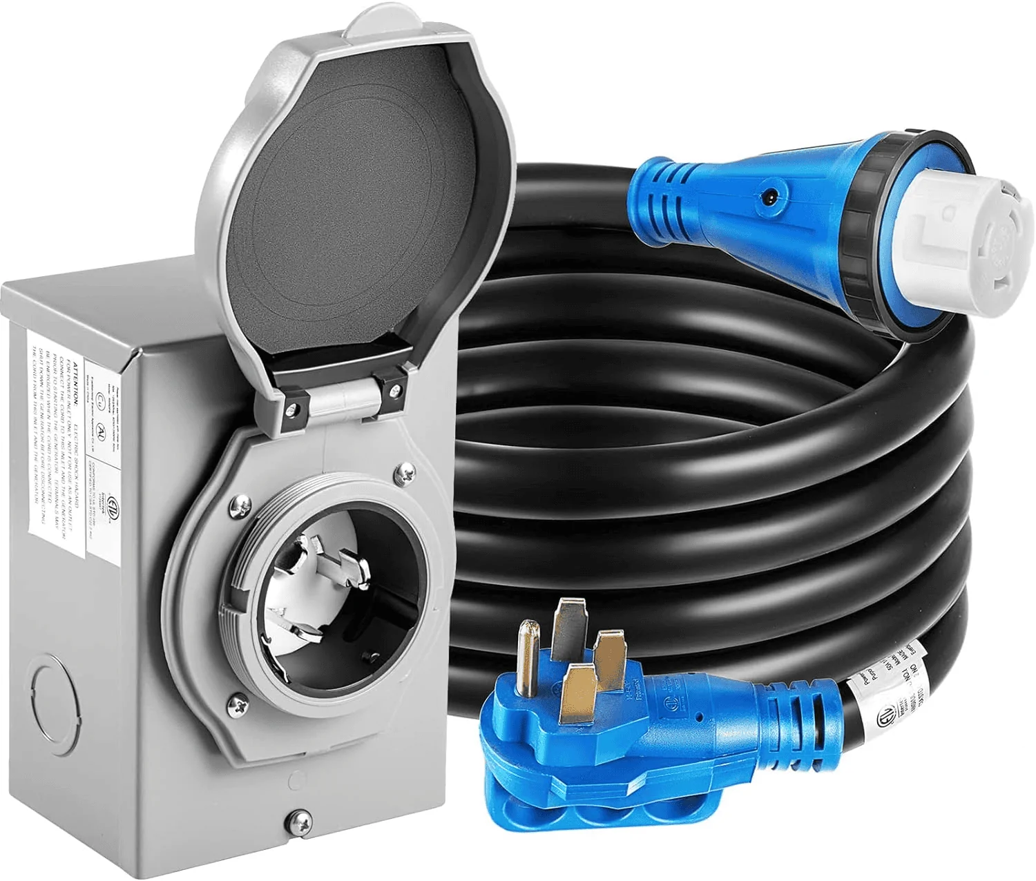

can you elaborate a little more plz? Did you use the mobile powershare adapter? Or a male to male plug in the 14-50 at the bed? also, do you remember what install cost was for your setup?
I would strongly suggest against male to male, with this much power on tap. It could be really dangerous.
instead, do something like this. Ideally with a transfer switch, but if you want to accept liability, and can trust yourself to throw the main breaker, that can be an option in a pinch as well.
https://a.co/d/7nT3AtO
if you go this route, (and i think its the best route) make sure you buy a breaker interlock kit too, then you dont have to trust yourself or a family member or the next owner.
Tesla Cybertruck Used Cybertruck to power my house during power outage 1707230271655
also if you have solar you may want to turn off the breakers that the solar inverter feeds your main panel from (if thats how its installed) also.
Good call. I didn't know they could hardwire a cable so I'm looking at that now.
