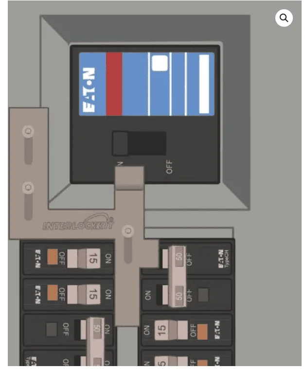

if you go this route, (and i think its the best route) make sure you buy a breaker interlock kit too, then you dont have to trust yourself or a family member or the next owner.
also if you have solar you may want to turn off the breakers that the solar inverter feeds your main panel from (if thats how its installed) also.
I have this very setup and it works quite well with my portable generator. I look forward to the cybertruck setup for future needs though.
