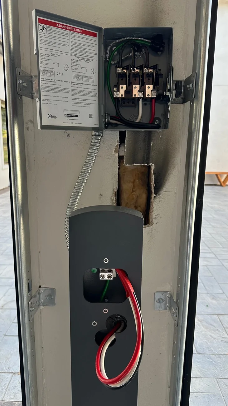

Two reasons:
1) Allows for a cleaner connection (main reason)…more room.
2) If I need to shut it off, I don’t have to walk all the way around the side/back of the property. (Not as important)
Number 2 is VERY important. See my post directly above yours.

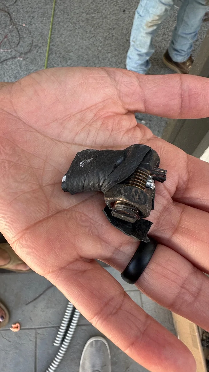

Here are two more photos of the carnage. They believe the culprit was the piece that is in my Wife’s hand and it arched.
Tesla installation instructions do not call for an emergency disconnect. I don’t understand the reasoning for this.
Two reasons:
The picture you sent looks like sleeved romex. That should not be in a conduit. Review tesla installation instructions, I’m perplexed for the disconnect.

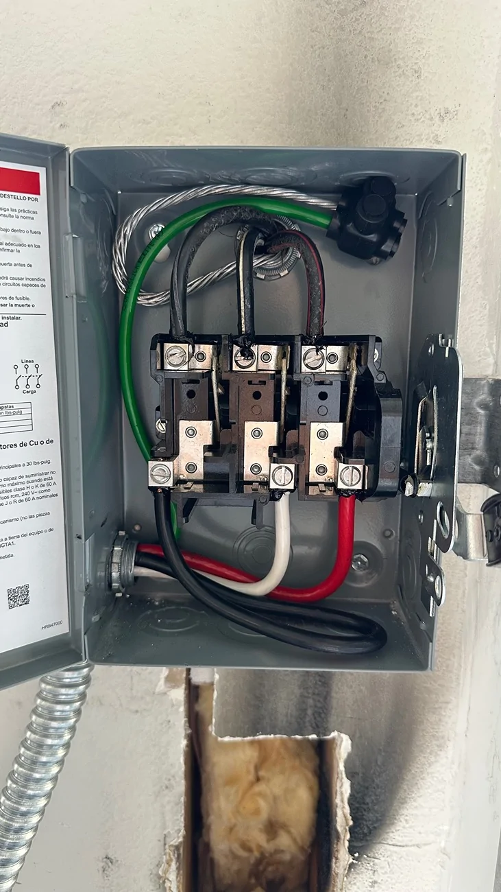

As an update, they installed an emergency disconnect box and make a cleaner connection etc. Nothing happened to the Tesla Wall Connector, but they are replacing both.
Huh. The neutral doesn't need to go through the disconnected, but it can. However, the neutral doesn't even need to exist since the WC doesn't use it.
More concerning is that the disconnect doesn't appear to be grounded.
Tesla Cybertruck Almost Burned my House Down... Thoughts / Theories? img_0068-jpeg

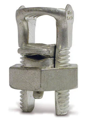

The culprit is whomever installed a split bolt without a divider to separate the aluminum and copper conductors...
Looks like a copper-copper, not a copper-aluminum.
Tesla Cybertruck Almost Burned my House Down... Thoughts / Theories? sw4-tin-plated-copper-split-bolt-_10-_6-awg_3
Tesla Cybertruck Almost Burned my House Down... Thoughts / Theories? shopping(1)
cybercricket
Oct 31, 2024
665
802
Oregon
Are these intended for this application in the first place ? There are those Polaris terminals that are insulated and can be properly torqued.
May 27, 2024
4,609
5,603
Yes, split bolts were made for splicing conductors. Especially handy because you can put one in the middle of an existing run. Downside is the amount of overwatch tape needed and serviceablity. The new install used Polaris for the ground.
