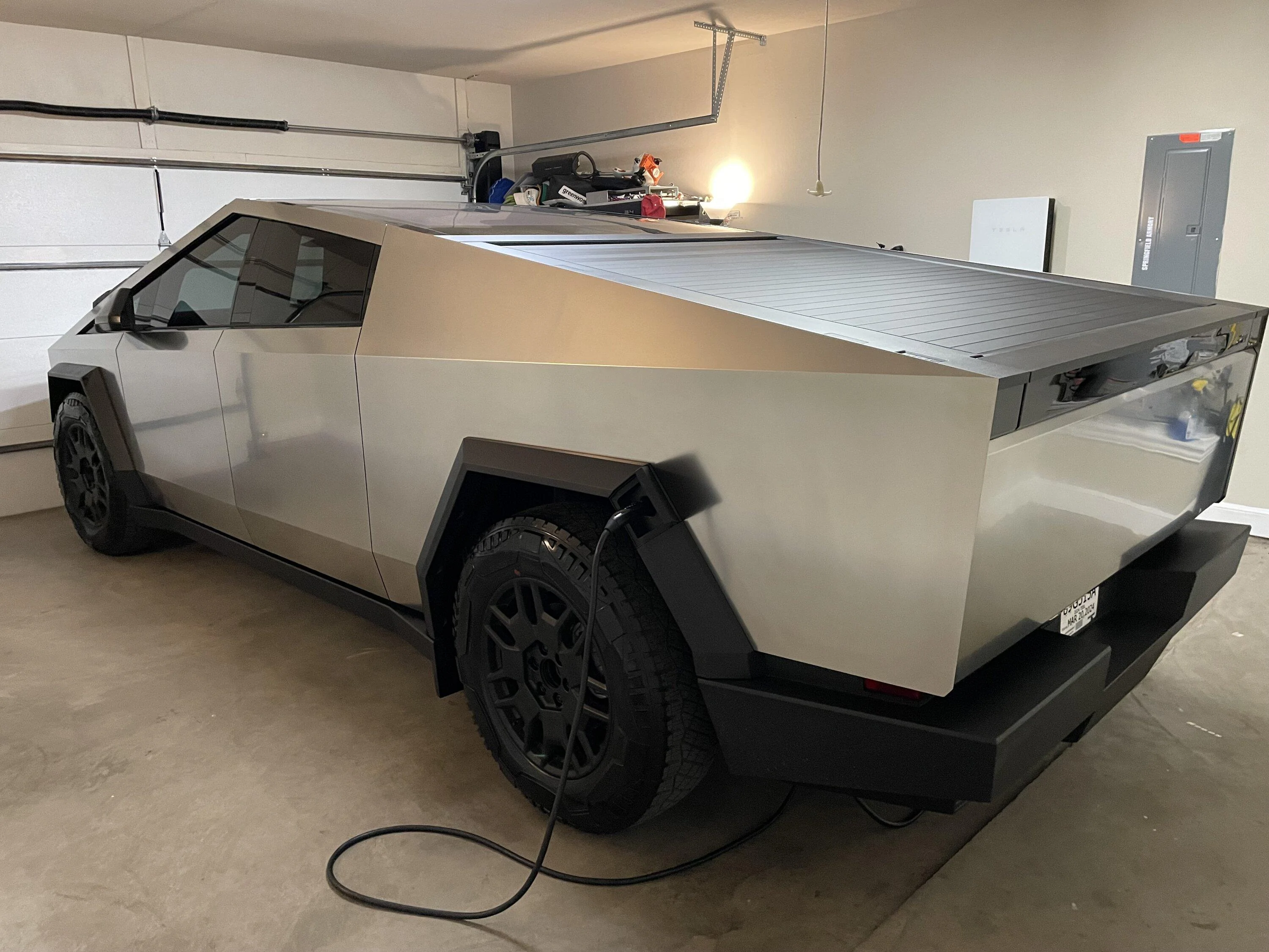

Tesla Cybertruck Bar Keepers Friend steel cleaner applied -- result photos {filename}
Barn find. Stainless looks in good shape, but look at those fingerprints lol

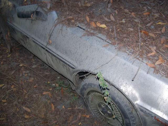

This one is literally buried in biomass, but the steel is still shiny.
Abandoned roadside, Courtesy Google Street View. There's a current short video. If it weren't so far away I would steal his hood hahahaha

I applied a less than liberal amount and utilized windex to remove the metal polisher. Do not leave on too long, wipe immediately. Do not reuse the microfiber towel, it turns brownish black.

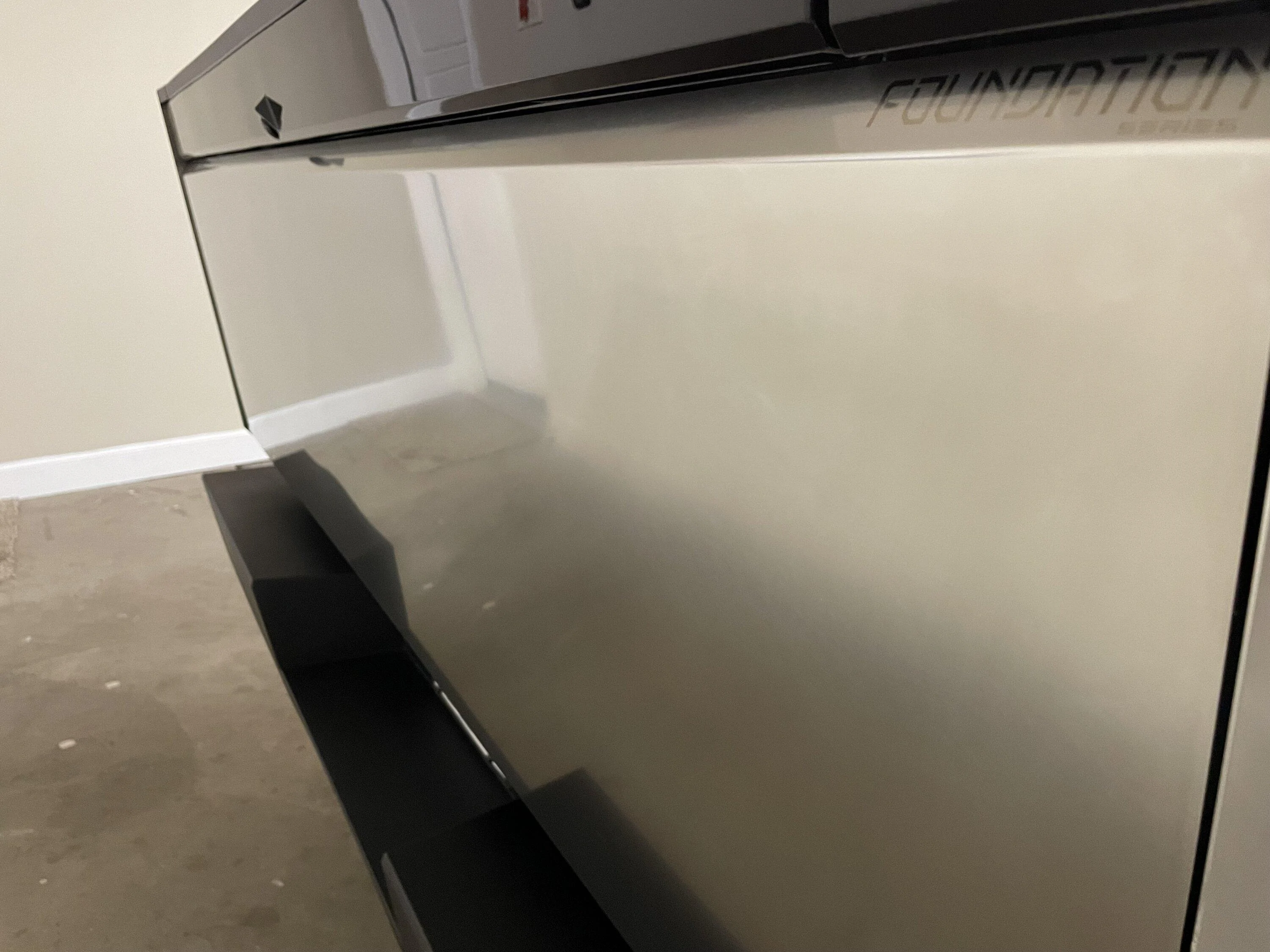

BKF is great for an occasional detail, like every year if your CT sits outside in the elements. It is like a laser scrub for your face, as it removes the oxidation.
I have only had to use it once on my DeLorean in my 11 years of ownership as the car is babied and is stored in a garage.
Here it is after the BKF application followed by a wash. In fact, I cleaned one panel and washed the panel right away, followed by another wash when I was done cleaning all panels. The Florida DeLorean Club uses BKF this way.
