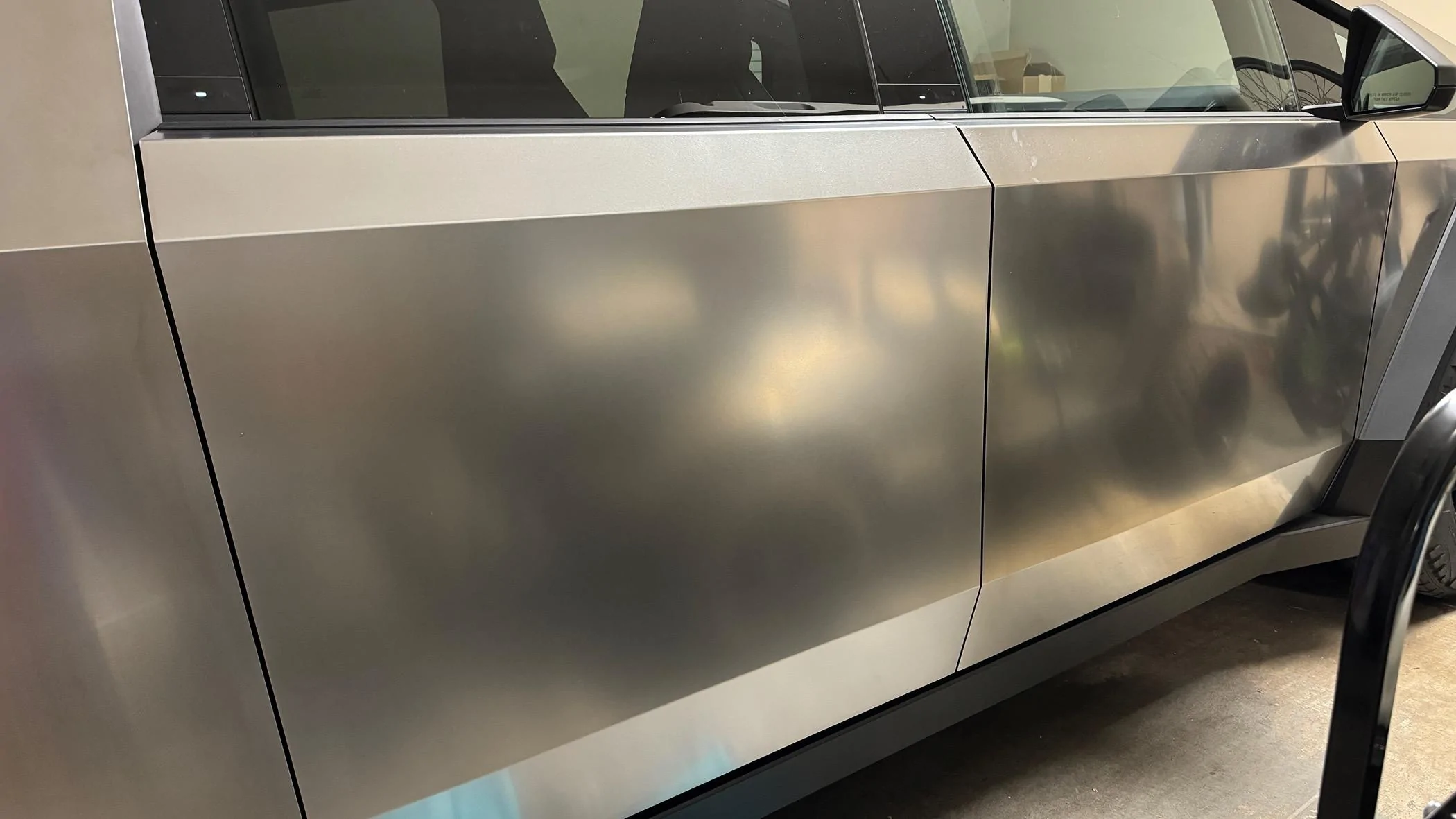

My Cybertruck was delivered with quite a bit of staining on a lot of the panels. It’s looked to be from rain. I tried a bunch of softer cleaners first to get off the stains. Windex, waterless wash, full soap wash, generic stainless polish, etc.
None of that worked. So I tried some bar keepers friend that many other suggested. I tried it on a small area, and it looked fine. I then tried a door with lots of staining. I let it sit for one minute and then rinsed it off. The first time I applied very lightly and it dulled the stains, but didn’t remove them. The second time I scrubbed just a little more and it completely removed all the stains and created a perfectly uniform panel.
However, The door is now lighter in color and the finish is a bit more dull / less shiny. I don’t love this effect, but it appears I’m going to have to live with it since I already started. I followed the directions, didn’t let it sit too long and didn’t scrub hard. To help others to do this well and decide if this is for them, I would love some advice or feedback from others if they saw this, or if I did something wrong.
Pic: BKF used on rear door only
Important Edit: after finishing the whole truck, I noticed that the front panel in the picture below still doesn’t match the panel in the rear. I am thinking bar keepers friend didn’t change the panel as much as I thought. When both panels were done the same way they still look different. So if my post scared you away, don’t worry too much. The truck looks amazing with all panels done and I do prefer it better now.
