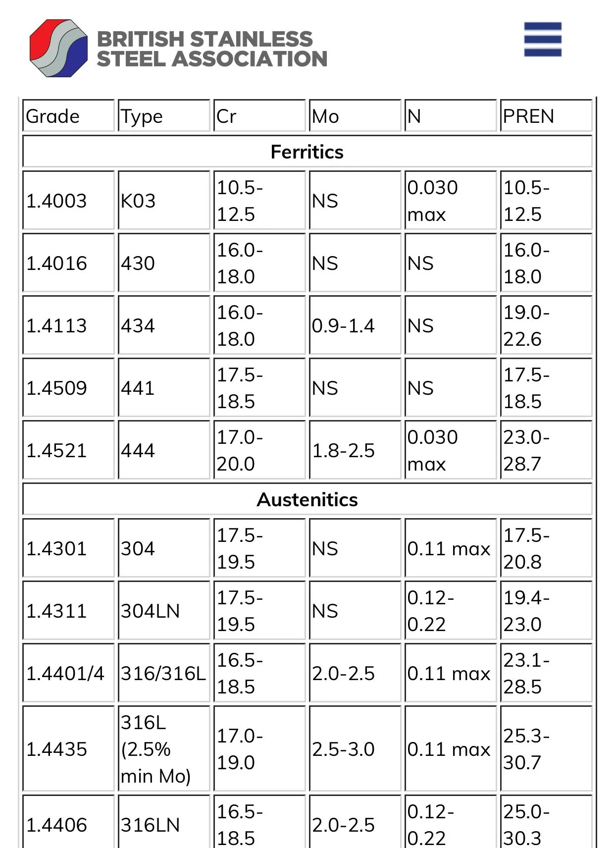

Cybertruck lead engineer claims that CT stainless has higher PREN (resistance to pitting corrosion) than 316L. This is the first "real" information that has been given about what makes the "30X" stainless on CT "special". Everyone claiming there was some magic formulation, now you have a source.
This is great corrosion insight into the Cybertruck’s mysterious “30X” by a Tesla engineer who knows about the subject.
So, if the Cybertruck’s “30X” formula has a higher PREN than marine grade 316L SS, it’s PREN is even better than the DeLorean’s 304 SS.
316L= PREN of 23.1-28.5
304= PREN of 17.5 - 20.8
Here’s a chart of the grades and PRENs:
Tesla Cybertruck My Cybertruck delivered with rust stains, but easily removed with Bar Keepers Friend cleaner IMG_4706
source: https://bssa.org.uk/bssa_articles/calculation-of-pitting-resistance-equivalent-numbers-pren/
Knowing how the DeLorean has stood the test of time, that’s great news.
EXCUSE ME, don't come here with your facts and try to shut down this hype train! We don't care about facts. We came here to be brainwashed by everyone saying CT is doomed to failure and prone to rusting!! Lose the logic and give us more alarming words and out of context photos!!
/S ;)
