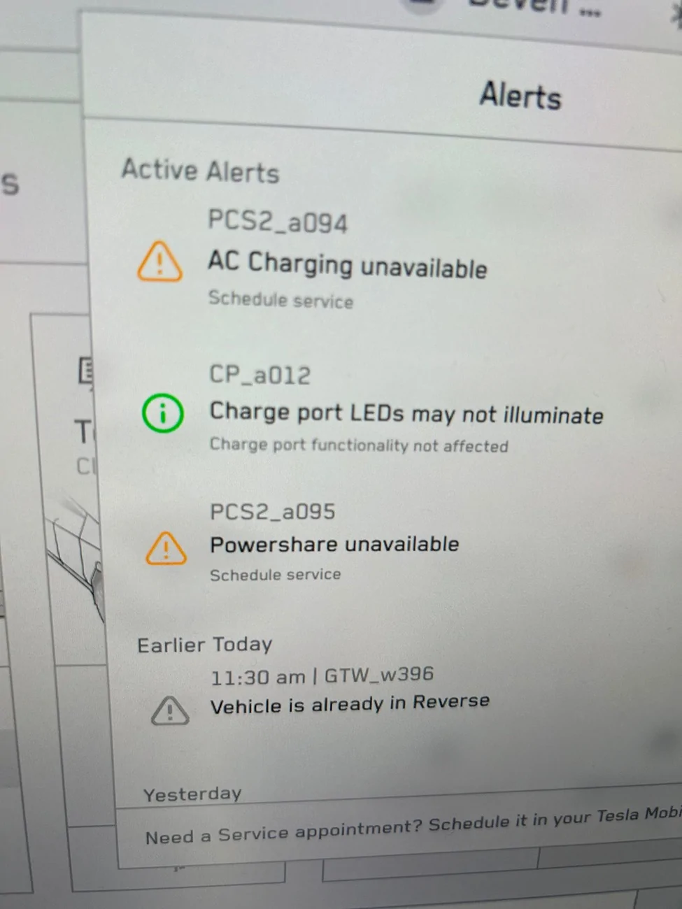

Well my truck got the errors and stopped charging overnight. Tried universal charger and mobile charger - says AC charging unavailable.
Messaged the local service center, they said bring it in since I had appointment for the 19th anyways, but now it won’t charge at all.
They gave me a loaner though, so all good for now.
Please let us know what are they planning to replace. It looks like parts are not the same even for similar issues.

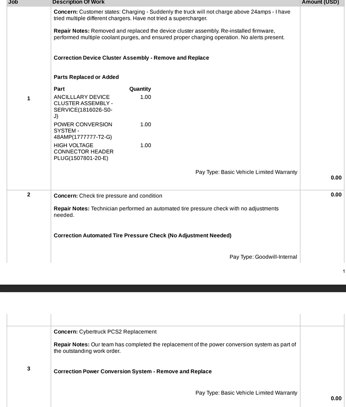

I got the invoice, the list of replaced parts is a little different, full list below:
  • HIGH VOLTAGE HARNESS - AC JUNCTION BOX TO FAST CONTACOR(1848042-00-J)
  • ANCILLARY LOW VOLTAGE HARNESS(1682237-01-J)
  • ANCILLLARY DEVICE CLUSTER ASSEMBLY - SERVICE(1816026-S0-J)
  • HIGH VOLTAGE CONNECTOR HEADER PLUG(1507801-20-E)
All works well after these fixes.
