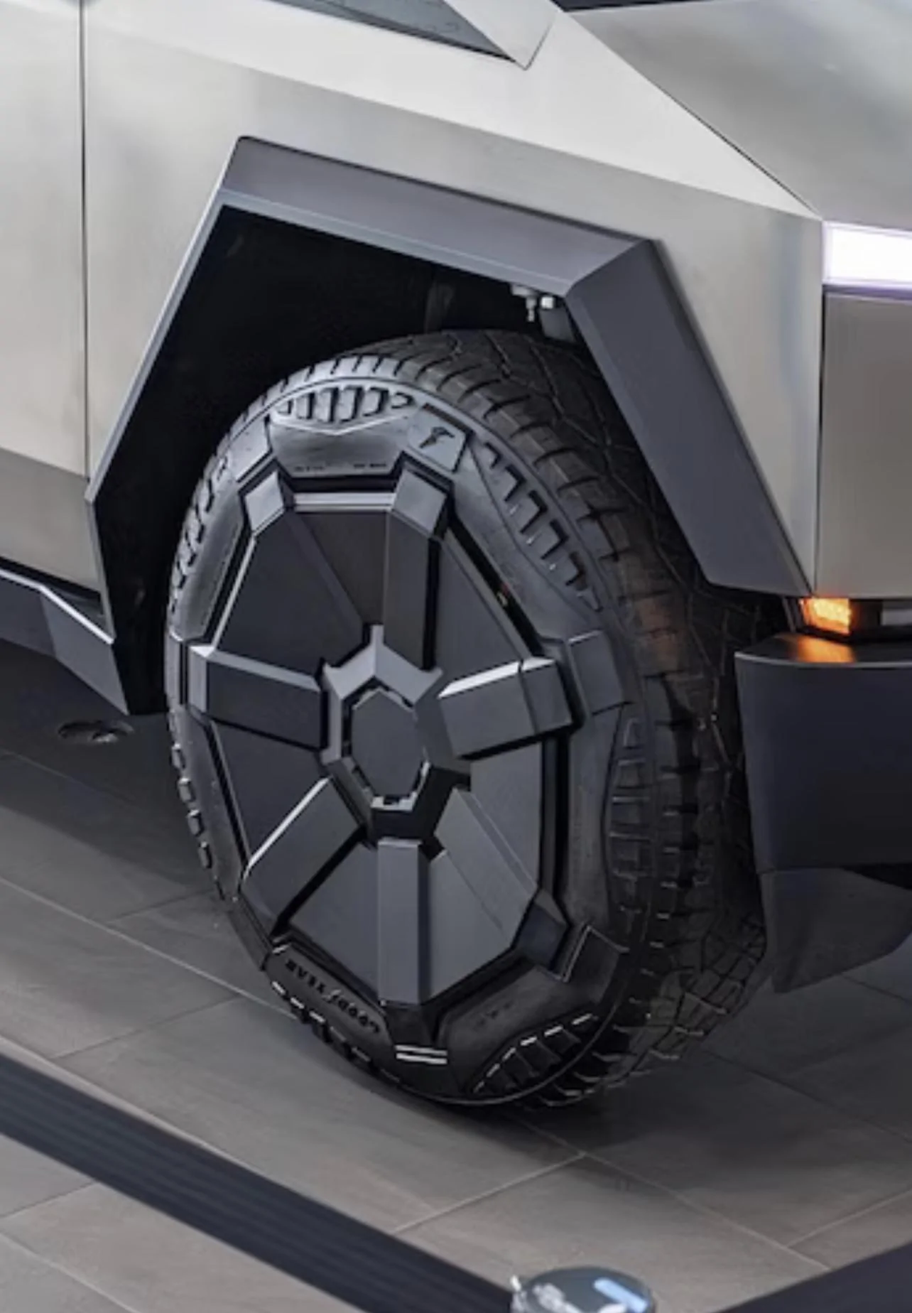

Some great details on this two part 'hub cap'
i havent watched
does he mention how those installment rings might scratch up the wheels?
I'm not saying it to piss in cheerios, but instead because if i were receiving one of these soon i would be deciding whether i want the wheels showing, or the hubcaps showing, until someone else lives and learns through whether the wheel finish holds up after a few thousand miles

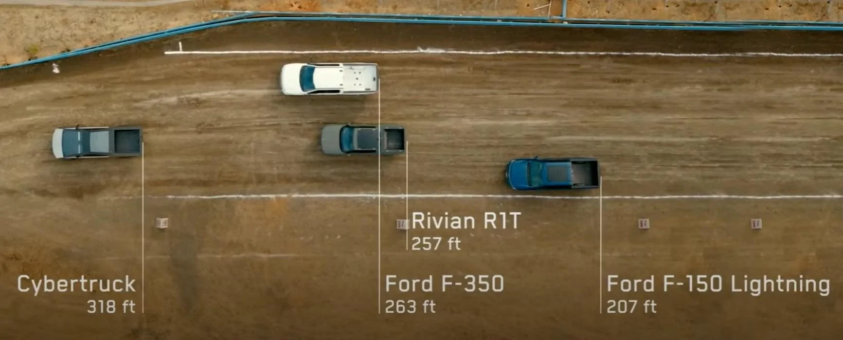

I'm really curious how the truck pull of the AWD Dual vs the AWD Tri/Beast would come out in this regard:
  • AWD Tri/Beast: front locker + torque_vectoring
  • AWD Dual with front & rear lockers
I know a truck pull is a little gimmicky for the presentation but I've watched a few in real life and of other EV trucks. WOW, that is an impressive difference.
ADD: Tesla Cybertruck Truck Pull vs other pickups F350 diesel / F150 Lightning EV / Rivian R1T EV
Tesla Cybertruck Cyberbeast vs Cybertruck AWD Comparison Truck Pull

I hear you. Would be interesting. It comes down to traction and power. Having both different with lockers is a huge advantage.

yes a base 20” rim and the premium 20” rim (which each have their own aero cover unless you buy the premium covers from accessory site, looks like)
premium:
base:
base aero:
the premium aero is the one you’ve seen mostly.
for people buying the AWD, will be interesting to learn the up-charge for optioning the premium wheels (standard on Cyberbeast)
PS: either the 18” is just vestigial code of some sort, or has something to do with this single motor variant coming in 2025 (Musk years?)
Thanks for the clarification. I could honestly care less what the rim looks like so long as I can get the A/T Tire and the better looking Aero-Cap from the premium wheel.

One thing to note here is the long wheel base puts the rear wheel further back in relation to the mass to the CT, and the CT is longer, which puts the front vehicle mass even further forwards. This means less front body lift on acceleration and more force being applied down onto the rear wheels instead of on the tow hitch holding it back. That's also why the F350 does better, because it's longer, just is missing the top end grunt.
The rear wheels are doing most of the work, but I'm not sure if the TM is traction limited the whole time which means the DM is likely slower with just the rear 300hp motor doing the bulk of work. The lockers would play a minimal roll, as both wheels are planted on a good surface and would have minimal variations between left and right.
