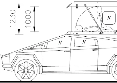

I reworked the drawing to make the pop top as wide (82") as the Cybertruck itself. With just a little increase in aerodynamic drag the unit can feature a king size bed.

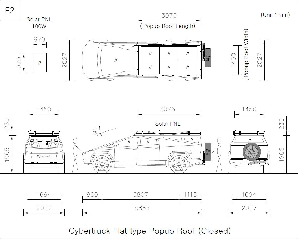

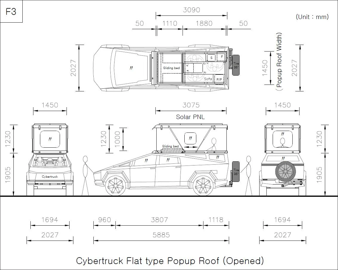

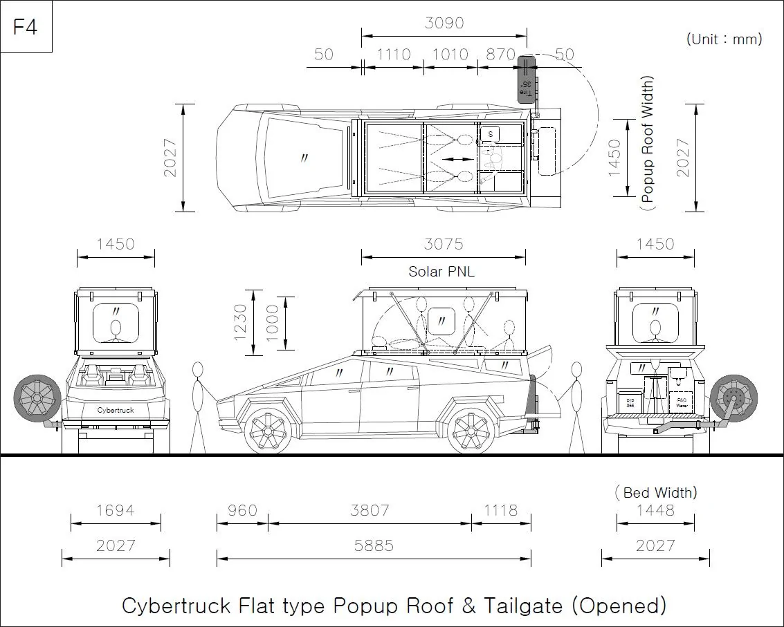

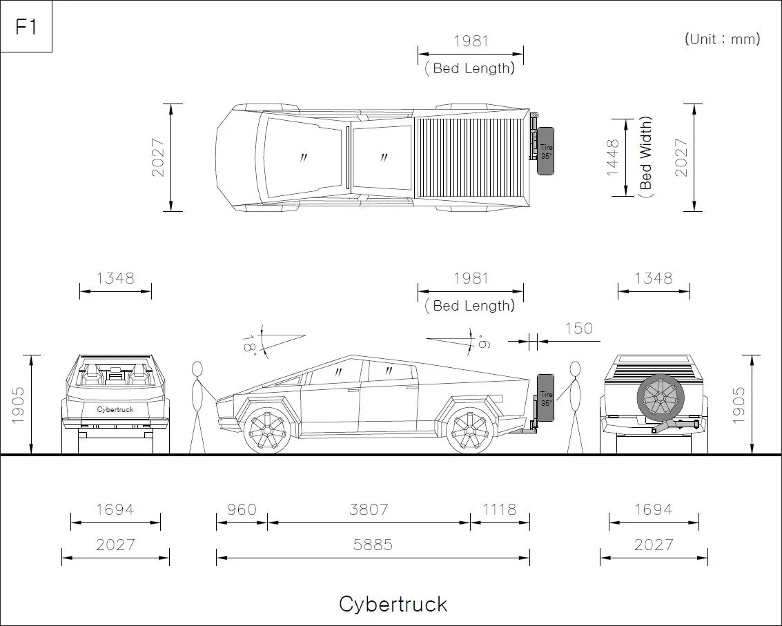

Install a spare tire on the tailgate of the pop-up roof cyber truck camper.
Tire dimensions are dia 35 x wide 12.5"(889 x 317.5mm).
The tailgate can be opened after turning the spare tire holder 90 degrees.
There are two types of pop-up roof (horizontal and inclined type).

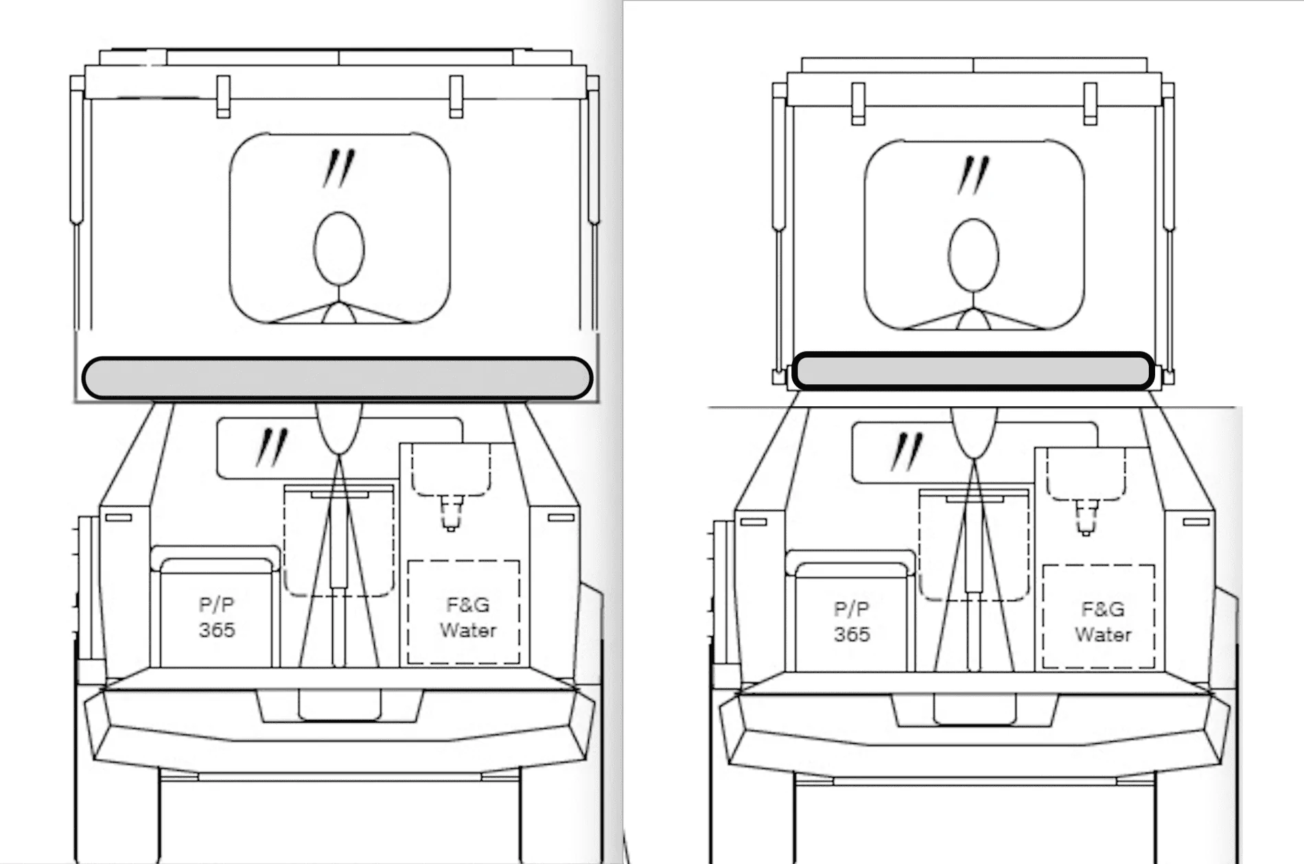

I think Iโ€™d prefer the flat type pop up, but the bed platform would have to elevate or pivot out of the way like in the Alu-Cab, so the you can have the full interior to stand up and move around. Iโ€™ve sent a few emails to CyberLandr asking if they planned to release a DIY version that can be built out by overlanders, campers, van lifers. Their response stated that they had discussed it at several engineering meetings and were aware of the potential marketability.

I love the main idea, and the crowd-sourced/discussed design. With the right hitch design, you could mount tire right or left and have space for bikes, e-moto, etc. I prefer the wedge option with solar panels. Keep up the great work.

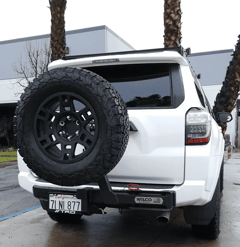

Yeah, it does look really cool. I wonder if they spare could be mounted to the hitch somehow? That way it could be removed.
Also, I think the spare should move from the left side to the right side, as the left side will have the charge port and with the spare you will be pressed for cable length at the superchargers.
There are a lot of options out there for spare tires mounted to the tow hitch

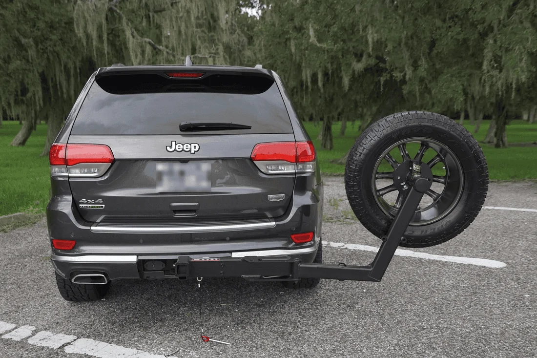

As much as I want a spare, I can't fault Tesla if they don't put one in. The majority of Cybertruck owners probably won't be in a situation that they can't get a quick tow to a shop. For the minority that might be in that situation more often, there are solutions for good spare storage. like this hitch mount.
This is the final version.
As these two in the drawing demonstate, It is not about the size of the bed. It is about how it is used ;)
Kidding aside, it is a very nice design.
