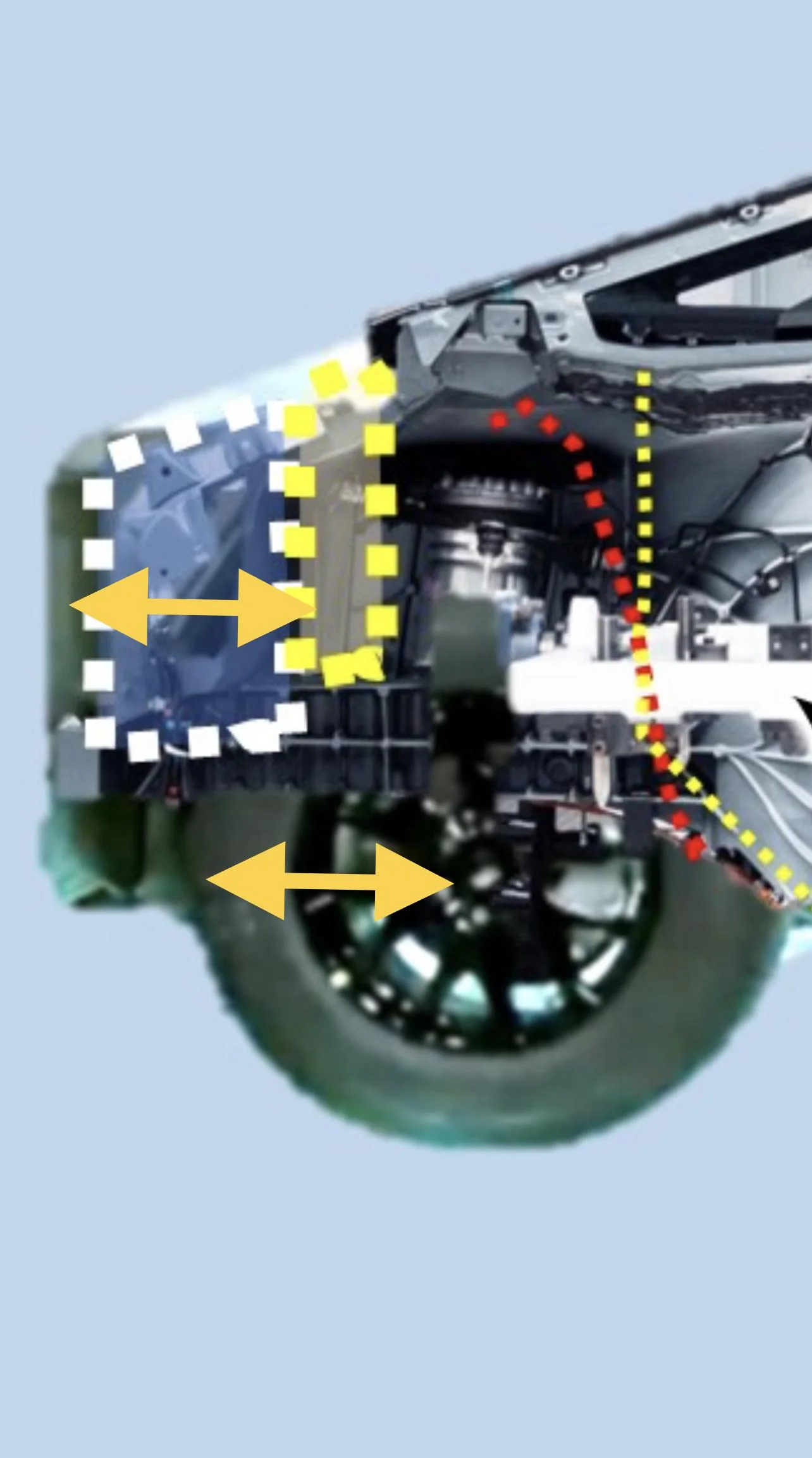

So greggertruck was agreeing with cvalue13’s last diagram of the frunk in blue. That is a shallow frunk, stopping before the front edge of the windshield.
Would someone with more precise chickens estimate how that volume compares with the frunk on a M3 or MY? It looks small, but CT is big, so maybe it’s relatively small and absolutely large. Thanks

Good stuff, however I don't get why you curved the firewall so much? Looks like it's just about vertical.
I also agree with @JBee that it should be a bit more rearward as it appears, from the above photo, to line up pretty well with the forward edge of the side body stamping:
Just some minor nitpicking, this is the shape of the front quarter panel:
Not quite. The fender flare is ON the quarter panel, not suspended below it.

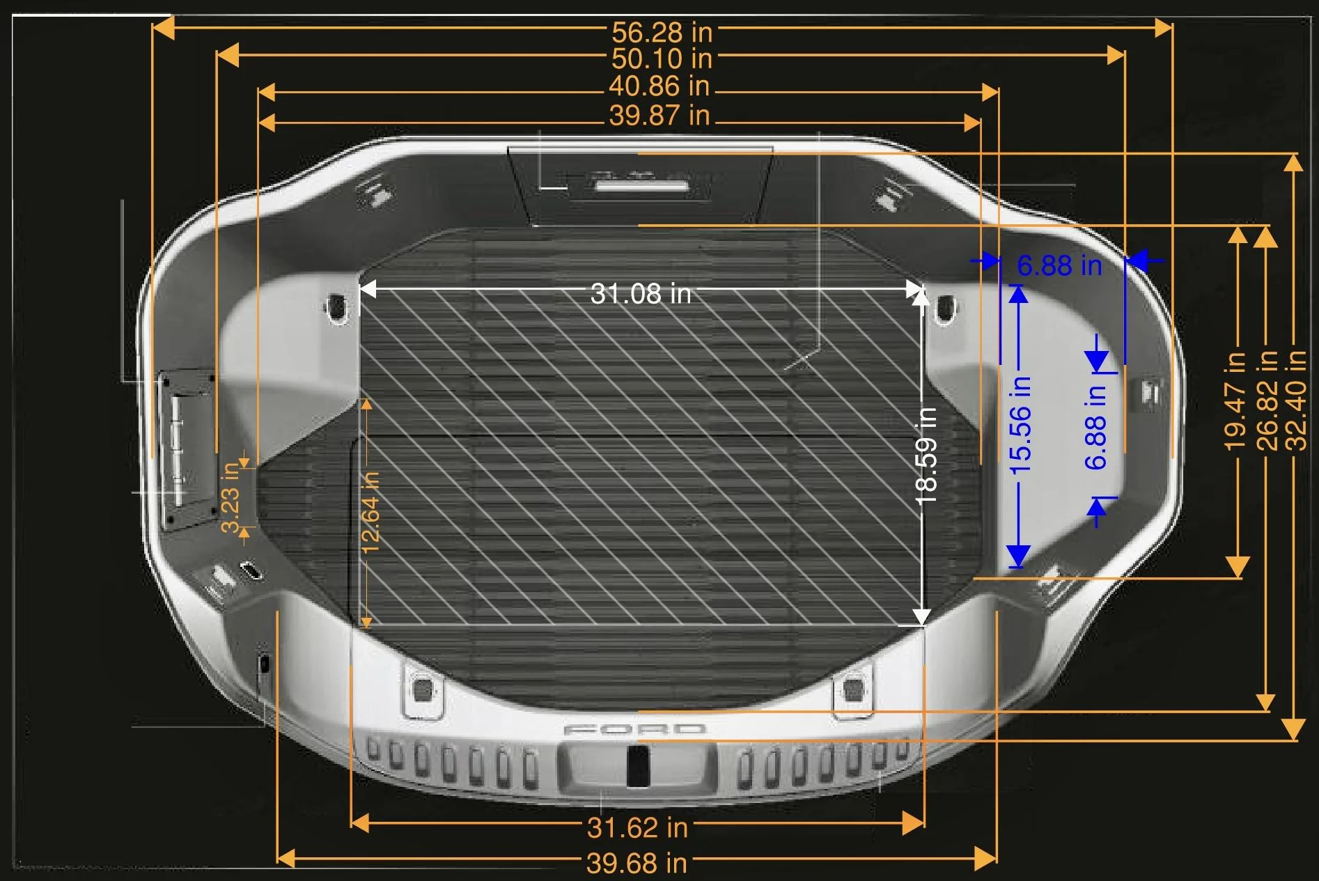

course I not have have anything more than “bigger than a breadbox, smaller than a bus” sort of dimensions on the CT Frunk, least of all the height
but for sh*ts and giggles:
On width of the CT Frunk:
• let’s say the narrowest constraint/pinch point is that of the Lightning, so 31”, but with some “wings” of extra width up to 39”
On the height of the CT Frunk:
• let’s again just assume a comp of the Lightning frunk, so 15” high at highest
On the length of the CT Frunk nose to back wall:
• just eyeballing my sketches, let’s say the stainless nose to ~back of Frunk length is roughly the same as the length of the radius from the tire to the hub (the yellow arrows below are the same length)
Tesla Cybertruck Cybertruck Front Casting Analysis (and Frunk Implications) - 3 vs 2 Chickens 8DDEBAB4-5917-4211-A338-B51993B23D64
• since the CT’s tires are ~35”, that puts the radius at -18”
This gets us to a (totally made up) CT Frunk floor of 31”-39” wide, by 18”length, and 15” depth

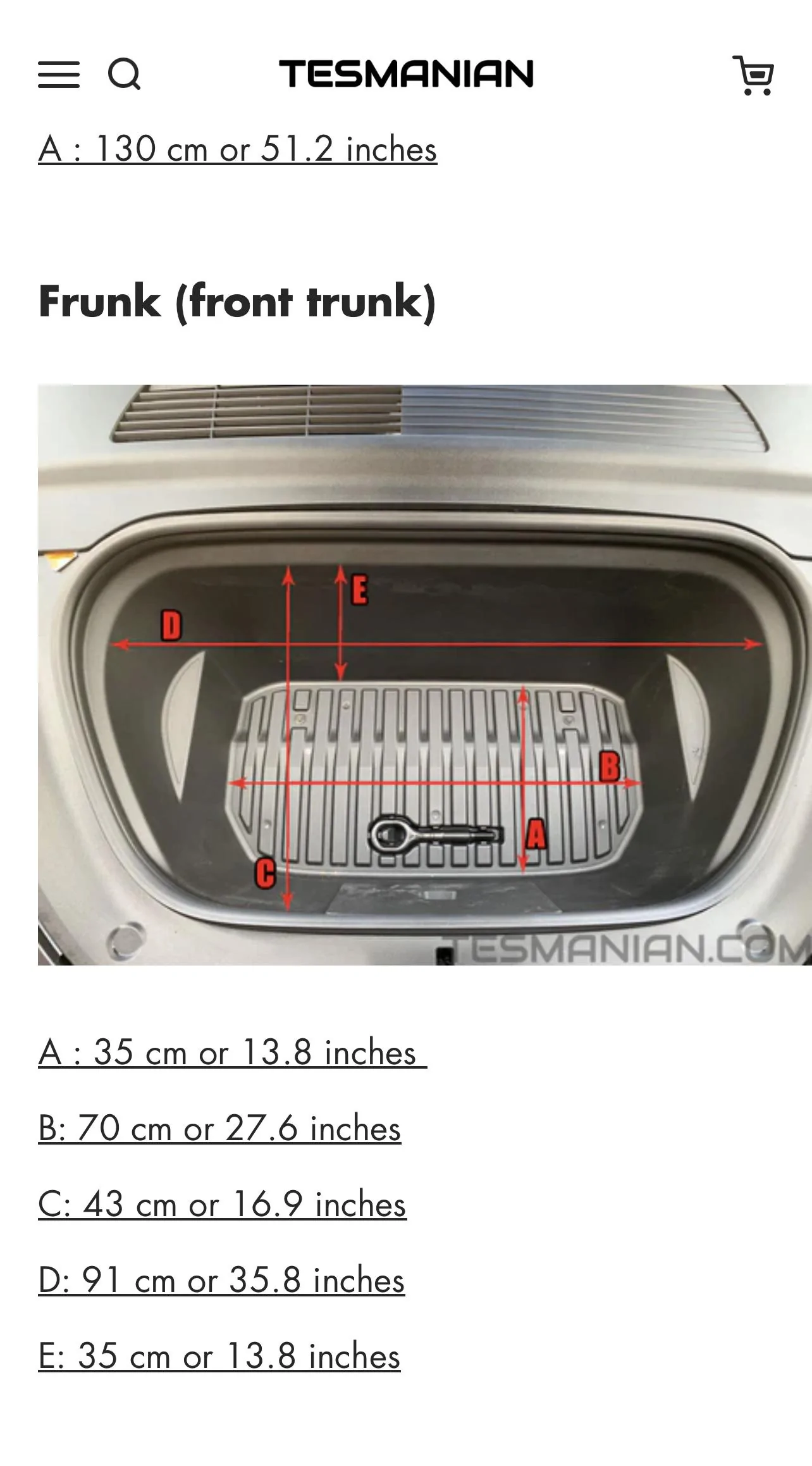

Compared to some model Y Frunk measurements I found (below), that would mean the CT Frunk has a good bit more width, length, and height, compared to the Model Y
In all, considerably larger volume than a Model Y
Tesla Cybertruck Cybertruck Front Casting Analysis (and Frunk Implications) - 3 vs 2 Chickens D430CFBB-0BA5-44D1-8668-B8F21B5592F6
in reality?
I’d expect that like the Model Y shown above and the Lightning (shown below) there’ll be various contours and pockets that mean it’s usable dimensions will vary at different heights/locations of the frunk
Tesla Cybertruck Cybertruck Front Casting Analysis (and Frunk Implications) - 3 vs 2 Chickens 38C21D23-B454-490E-903C-3E279B2DCE01
EDIT TO ADD: Model Y volume is 177 liters, Lightning is 400 liters
safe to assume CT volume will be well more than model Y
As the post stated the outline was to indicate the shape of the front quarter panel not the exact surface area, obviously part of it is covered by the fender flare. What was not quite right was the firewall. I had the shape right as it is vertical not slanted but @cvalue13 had the correct starting location.
