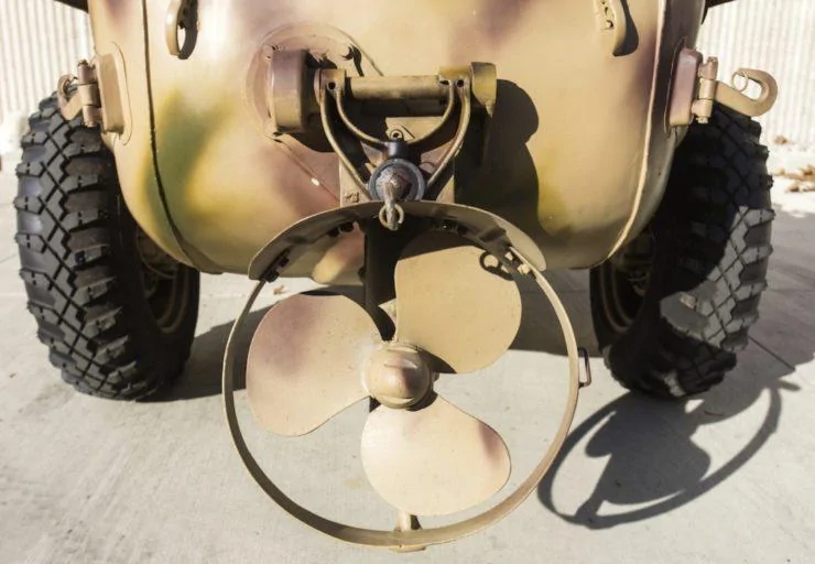

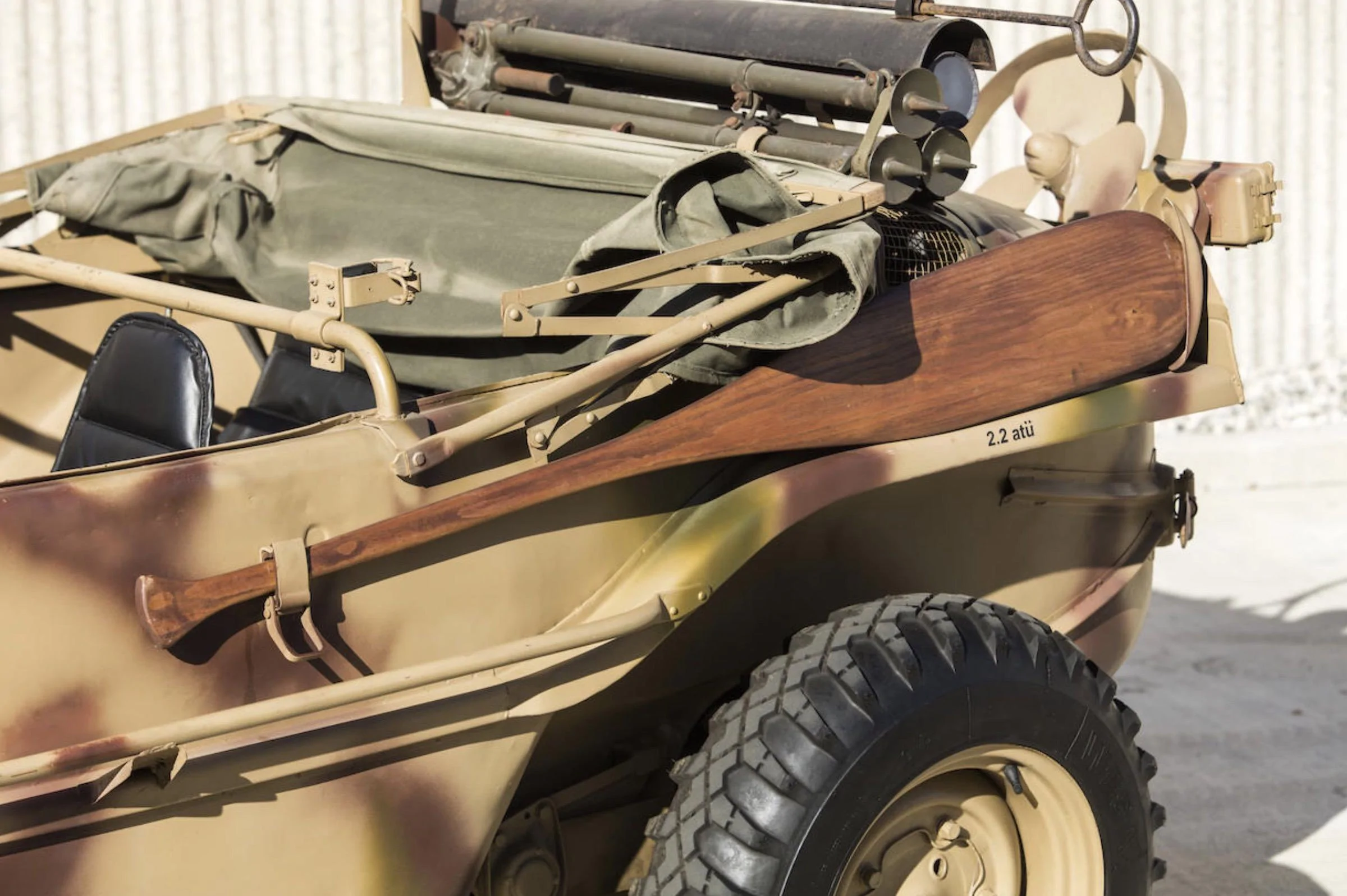

The VW Schwimmwagen has a propeller as main propulsion in water and uses front wheels as rudder. Came standard with paddles too. Driver and passengers still often also used paddles to help propel or steer.

Tesla Cybertruck Cybertruck is waterproof enough to serve as a boat to cross rivers, lakes & calm seas -- confirms Musk 🚤 Volkswagen-Type-166-Schwimmwagen-Paddle
Tesla Cybertruck Cybertruck is waterproof enough to serve as a boat to cross rivers, lakes & calm seas -- confirms Musk 🚤 Volkswagen-Type-166-Schwimmwagen-Propeller-740x512
Volkswagen Schwimmwagen (literally "swimming car") was a four-wheel drive amphibious vehicle, used extensively by German ground forces during the Second World War.
https://en.wikipedia.org/wiki/Volkswagen_Schwimmwagen
Prototyped as the Type 128, it entered full-scale production as the Type 166 in 1941 for the Wehrmacht.
15,584 Type 166 Schwimmwagen were produced from 1941 through 1944; 14,276 at Fallersleben and 1,308 by Porsche; the VW 166 is the most-produced amphibious car in history.
Technology
All Schwimmwagens were four-wheel drive in first gear (and reverse gears on some models) only and had ZF self-locking differentials on the front and rear axles. As with the KĂĽbelwagen, the Schwimmwagen had rear portal axles, which provided increased ground clearance, while at the same time reducing drive-line torque stresses with their gear reduction at the wheels. The Schwimmwagen had a top speed of 50 miles per hour (80 km/h) on land. When crossing a body of water a screw propeller could be lowered down from the rear deck/engine cover. When in place a simple coupling provided drive straight from an extension of the engine's crankshaft. This meant that screw propulsion always drove forward. The Schwimmwagen had a top speed of 10 km/h (6 mph) in the water. For reversing in the water there was the choice of using the standard equipment paddle or running the land drive in reverse, allowing the wheel-rotation to slowly take the vehicle back. The front wheels doubled up as rudders, so steering was done with the steering wheel both on land and on water. The Schwimmwagen could also be steered by the passengers using the aforementioned paddles
